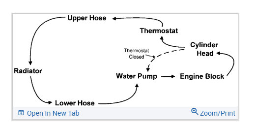

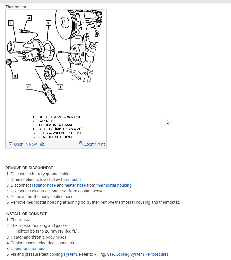

Which engine do you have? I show two options. 2.3L or 3.3L. I attached the process for the 2.3L. Our manual didn't have the specific process for the 3.3L so I assume that will be the one you have.
However, the thermostat is normally allows just at the other end of the upper hose. One end is attached to the radiator and the other is connected to the thermostat housing. Then the thermostat is in the housing.

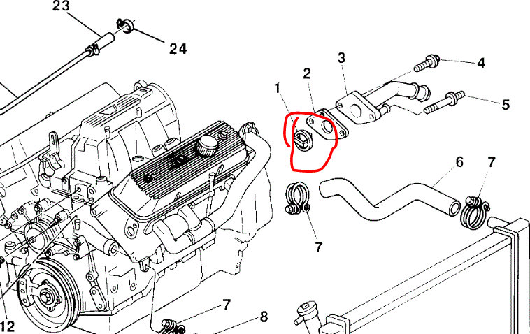

You have the 3.3L. If you follow the upper radiator hose, it will lead you to the thermostat housing. Behind it is the thermostat. I attached a pic of the engine / t-stat and circled it.
It's been awhile since I did one of these, but if I recall, they are tough to access because of the exhaust.

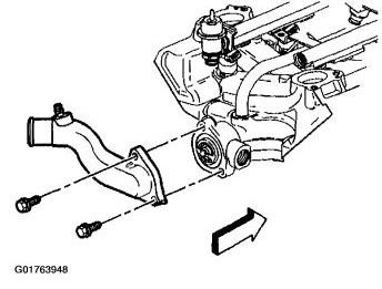

That should be a 3.3 L V-6 in your car. The thermostat is under the throttle body location in the housing that bolts to the intake manifold between the exhaust crossover and the intake. Follow the radiator hose to the engine. The tube that it connects to has the thermostat at the other end.
