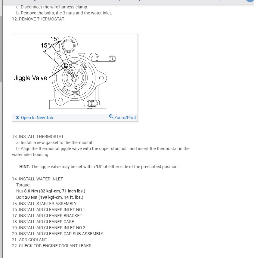

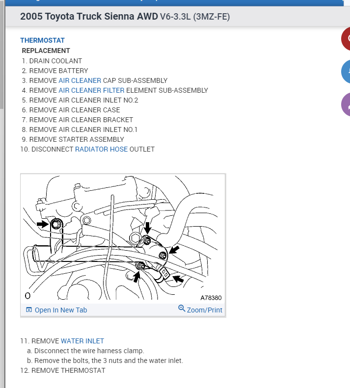

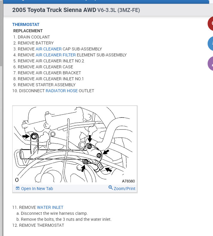

Wanted to know if there are any torque specifications for the thermostat housing bolts. And is there a sensor connected to the thermostat housing?
Nov 13, 2021 at 6:08 PM
Experienced Mechanic
18,907 POSTS
I am attaching the process below on how to replace the thermostat which includes the torque specs you are looking for.
It does not appear there is a sensor attached to the housing, but the harness may be clipped to it.
Please see the info below and let us know what questions you have.
