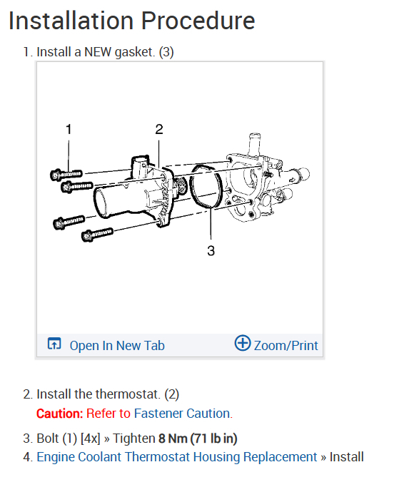

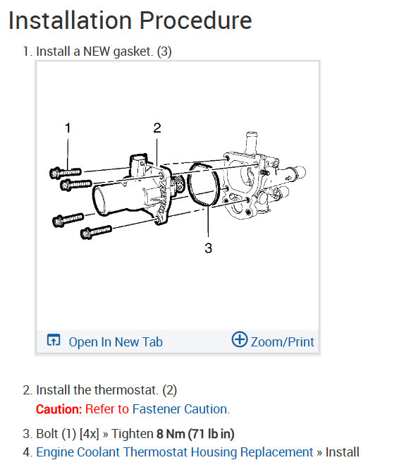

Thermostat housing torque settings?

Install new thermostat housing, install bolts torque settings for thermostat housing kit ,with diagram

Sure, here is the instructions and location of the thermostat with the torque setting as requested. Check out the images (below). Let us know if you need anything else.
