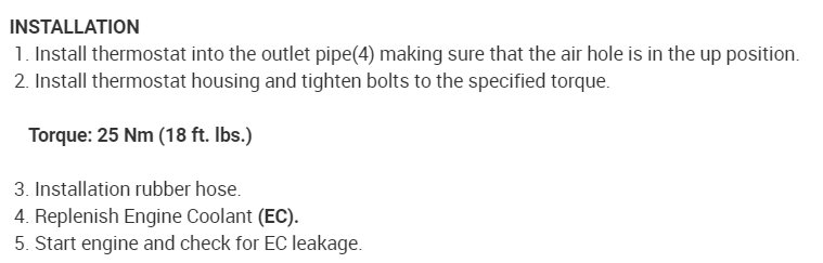

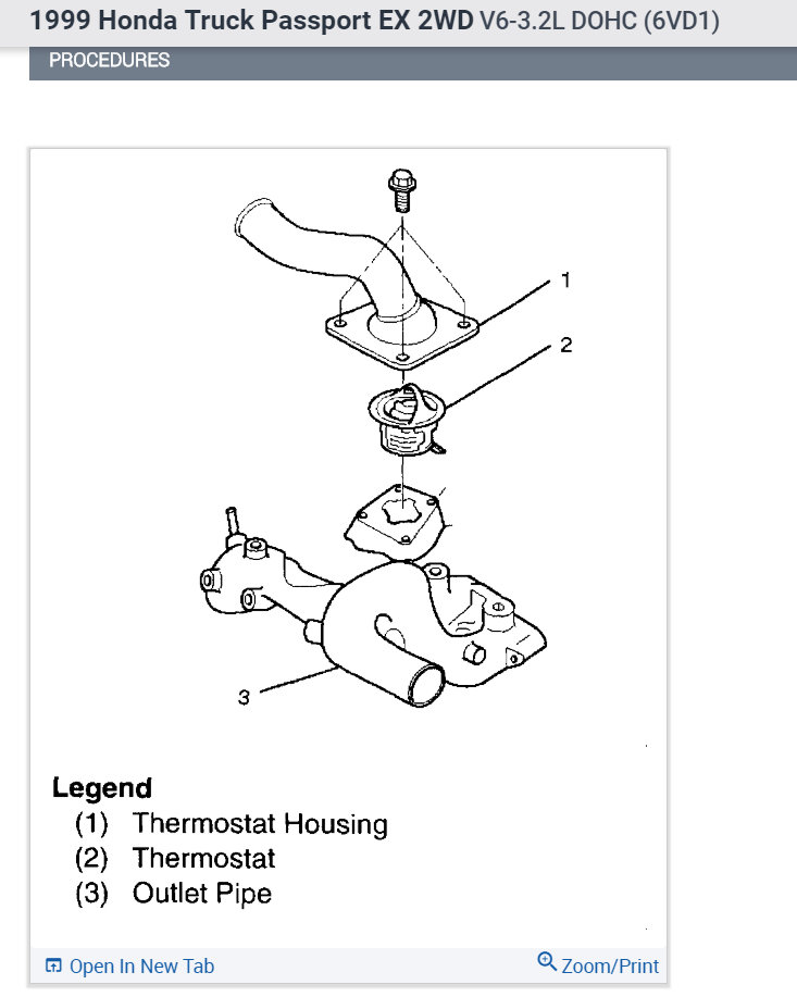

I need to replace the water housing line that is in between the thermostat and the block.
Sep 22, 2018 at 2:18 PM
Experienced Mechanic
55,604 POSTS
Here is a guide to show you step by step on how to do the job with diagrams below to help you see what it is like for your car:
Images (Click to enlarge)
