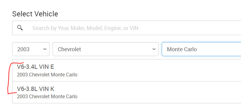

I need to know which engine you have. Is it a 3.4L or a 3.8L? (see pic below).
Let me know. If it is the 3.4, you will need to remove the crossover pipe.
Take care and I'll watch for your reply.
See pic below.

It is the 3.4.

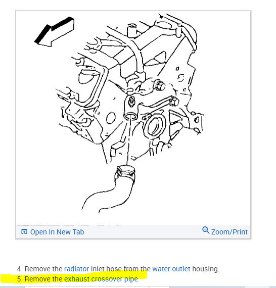

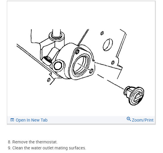

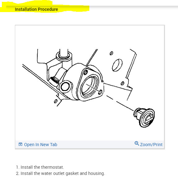

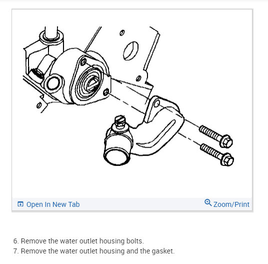

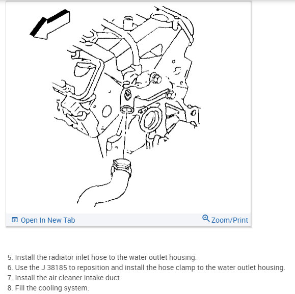

Experienced Mechanic
110,246 POSTS

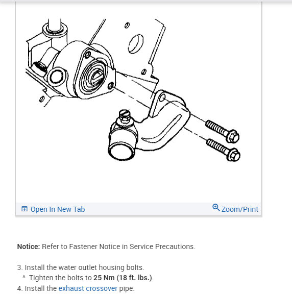

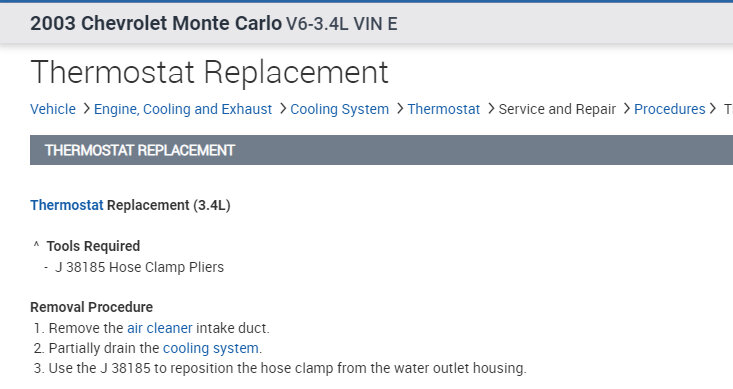

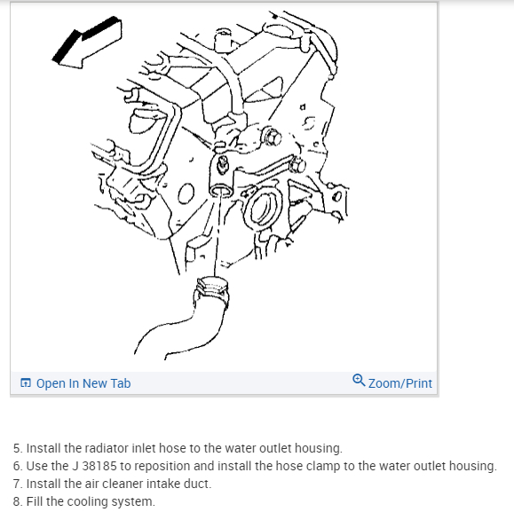

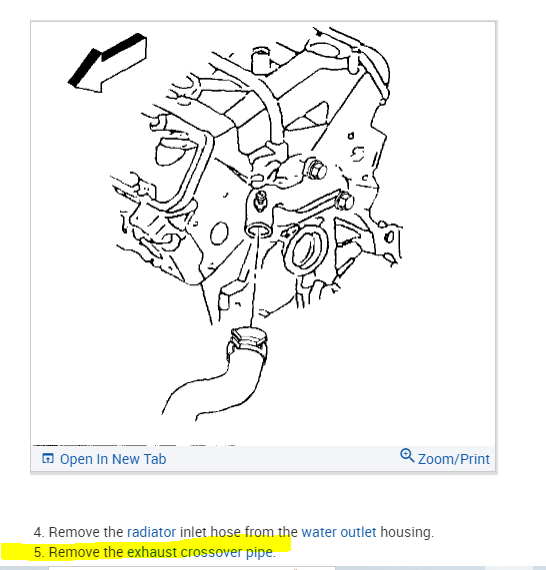

Yep, you have to remove the exhaust cross-over pipe to access the thermostat. I attached the directions below.
The first four pics are for thermostat replacement. In pic 2, I highlighted what needs to be removed. The cross-over pipe directions start with pic 5.
Let me know if this helps.
Images (Click to enlarge)
Nov 14, 2023 at 6:52 AM
