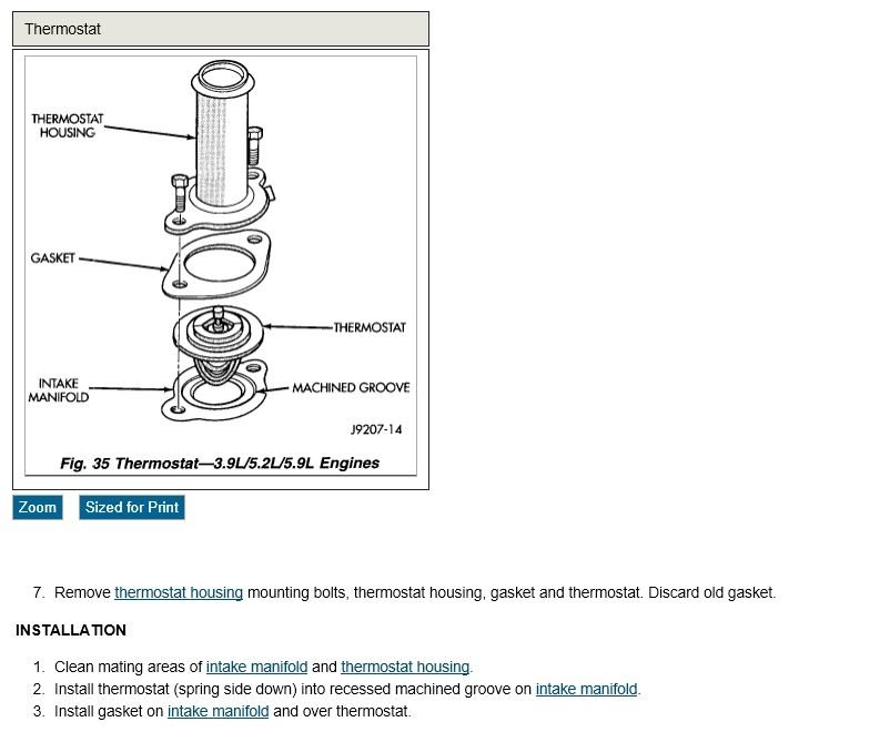

No heat just cold. How do I install a thermostat. I am a lady and I need to do this my self.

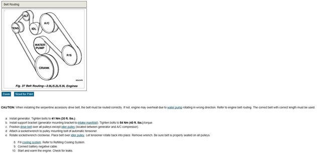

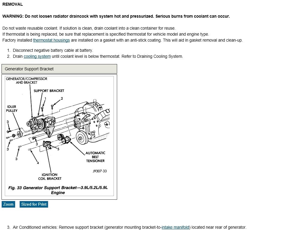

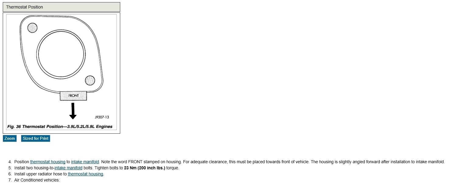

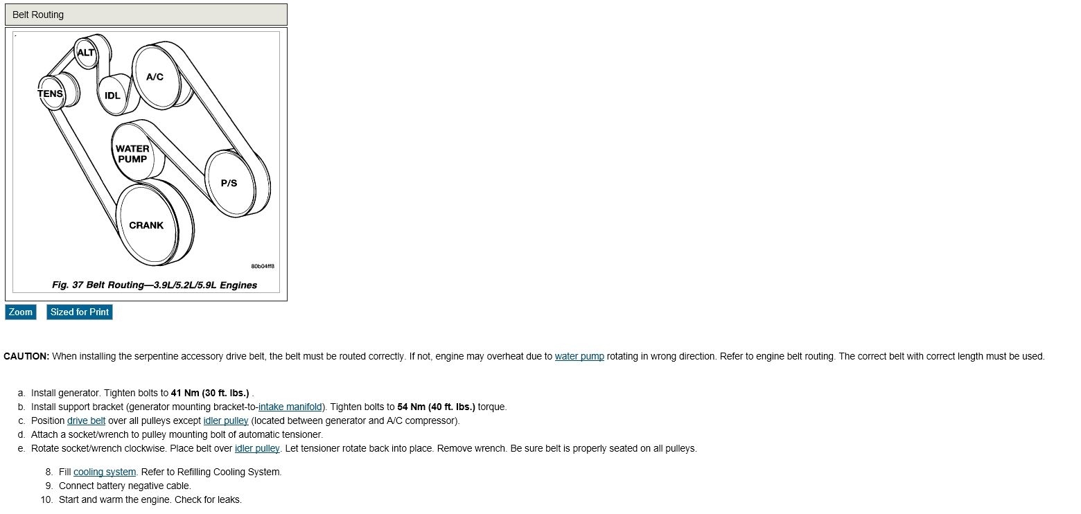

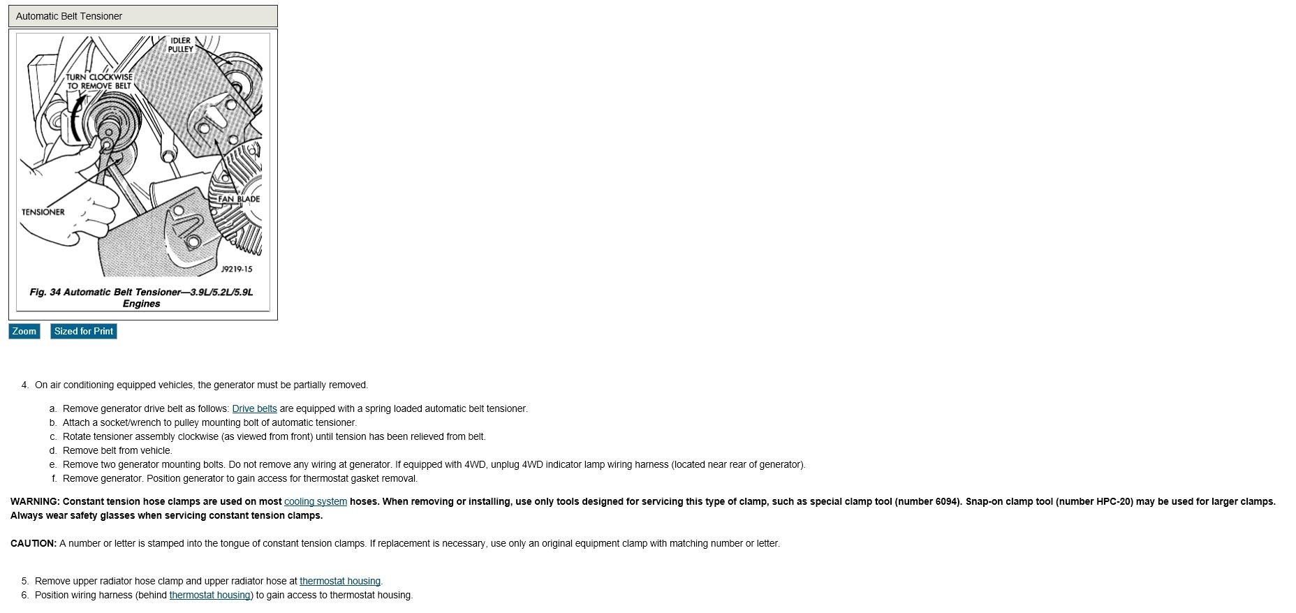

Here is a guide to help you step by step with instructions in the diagrams below to show you how on your car.
Here are those instructions. Check out the diagrams (Below). Please let us know if you need anything else to get the problem fixed.
