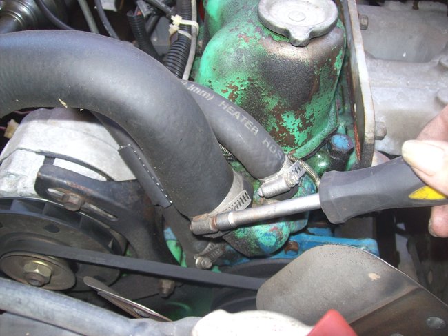

THERMOSTAT
ANTONY STOKES
  • 1999 HOLDEN VECTRA
  • 3.2L
  • V6
  • FWD
  • 95,000 MILES
LOCATION OF THERMOSTAT ON ENGINE
Saturday, February 6th, 2016 AT 5:58 PM
CJ MEDEVAC
  • 11,005 POSTS
I DON'T HAVE ANY INFO ON YOUR CAR

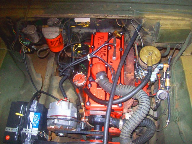

IN MOST CASES, IF YOU FOLLOW YOUR TOP BIG RADIATOR HOSE FROM THE RADIATOR TO THE ENGINE
THE HOSE WILL CONNECT TO THE THERMOSTAT HOUSING
REMOVING A FEW BOLTS WILL REMOVE THE HOUSING
THE THERMOSTAT WILL BE UNDER IT OR INSIDE OF THE HOUSING
OTHER VEHICLES MIGHT HAVE IT INCORPORATED INTO THE COOLANT RECOVERY TANK
I'M MORE FAMILIAR WITH THE FIRST SCENARIO I DESCRIBED

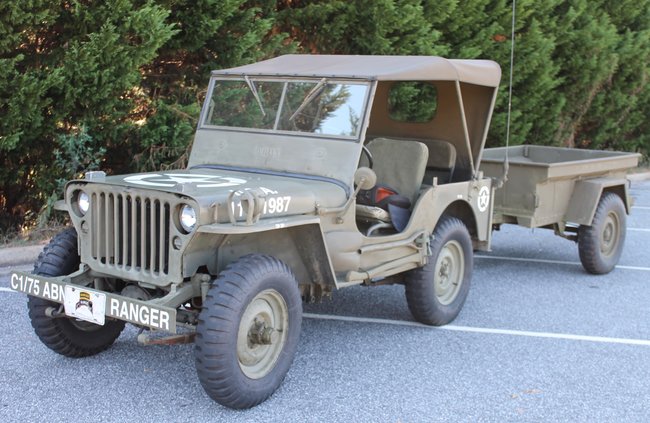

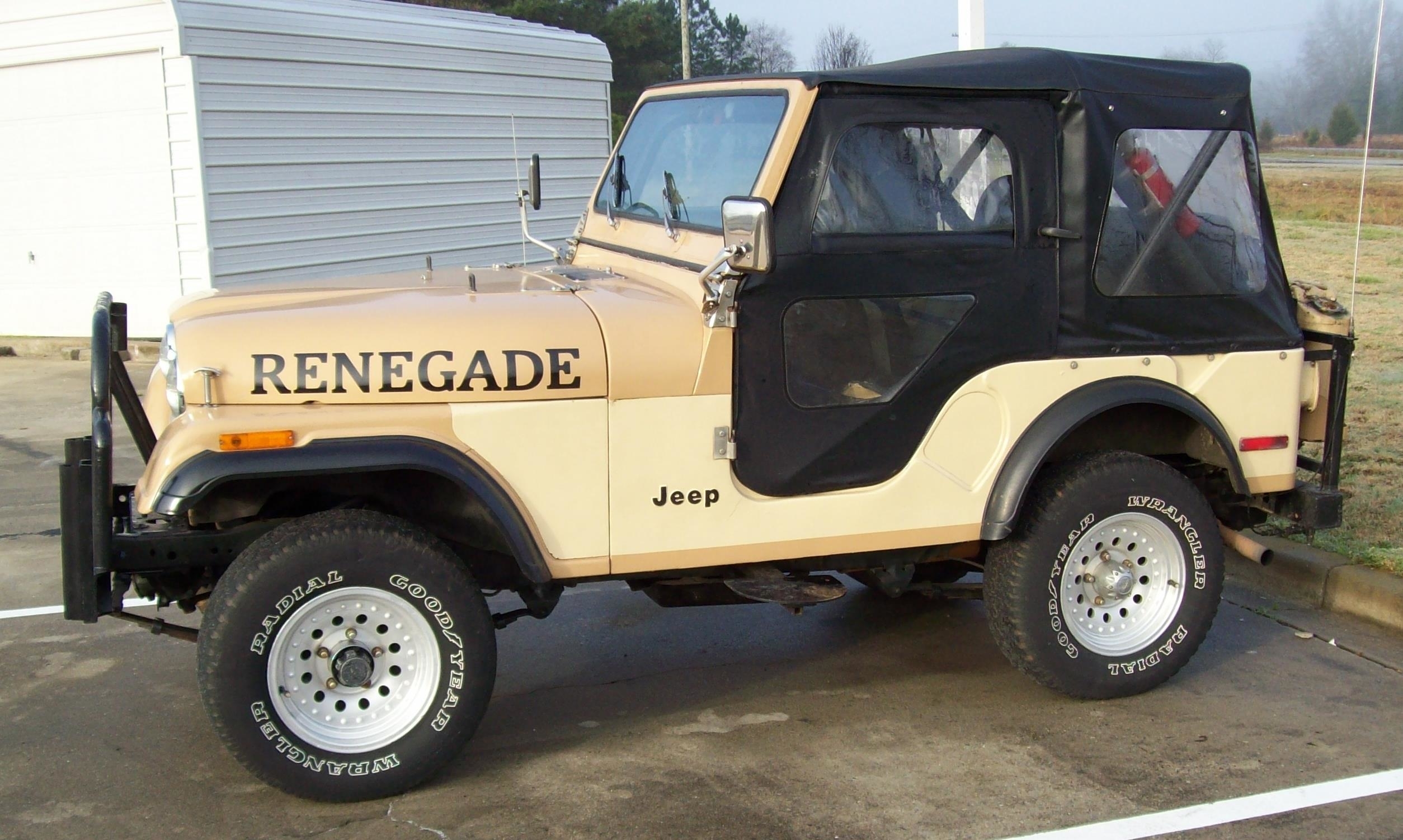

I SUPPLYING PICS OF MY TWO JEEPS, THE 1st IS A 1977 INLINE SIX CYLINDER. THE SECOND IS A 1946 4 CYLINDER. FOLLOW THE BIG HOSE TO THE HOUSING.
