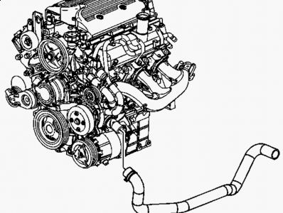

thermostat location for replacement?
2010 CHEVROLET IMPALA
108,000 MILES • 3.5L • V6 • FWD • AUTOMATIC
64IMPALA

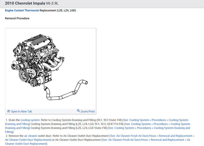

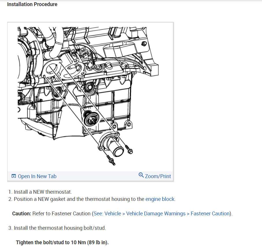

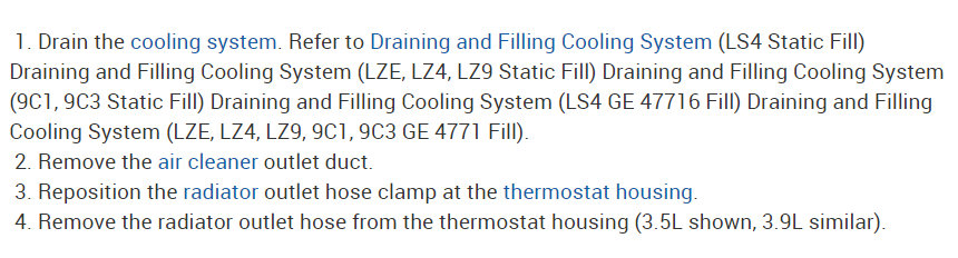

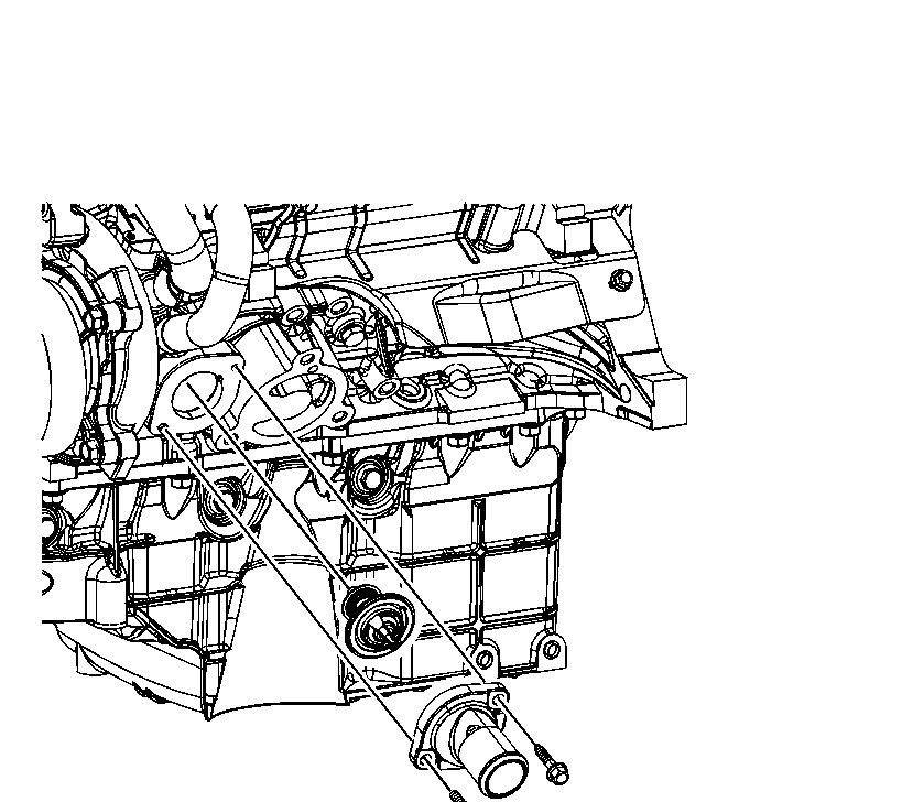

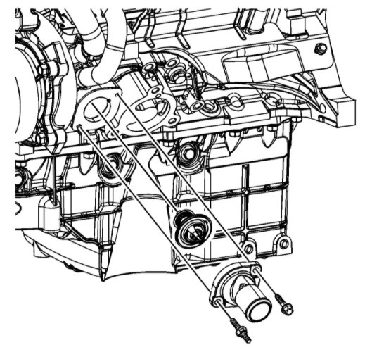

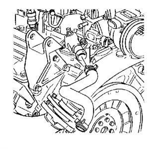

where is thermostat located and how do i replace it?
Jan 9, 2017 at 9:45 AM
CARADIODOC
  • 34,377 POSTS

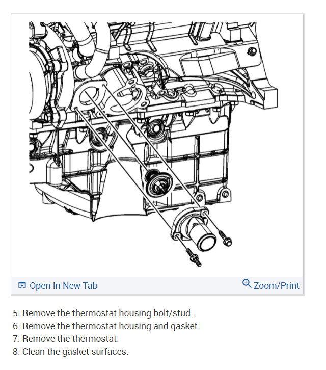

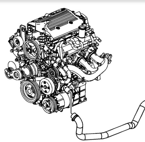

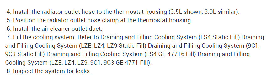

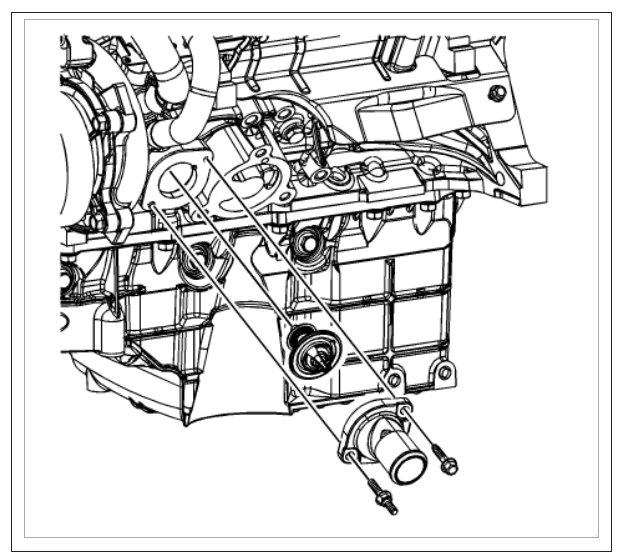

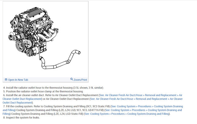

Here is a guide to help you step by step with instructions in the diagrams below to show you how on your car.

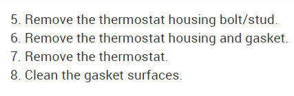

1. Drain the cooling system. Refer to Cooling System Draining and Filling (9C1, 9C3 Static Fill) or Cooling System Draining and Filling (LZE, LZ4, LGD, 9C1, 9C3, GE47716 Fill) or Cooling System Draining and Filling (LZE, LZ4, LGD Static Fill) .
2. Remove the air cleaner outlet duct. Refer to Air Cleaner Outlet Duct Replacement or Air Cleaner Outlet Duct Replacement .
3. Reposition the radiator outlet hose clamp at the thermostat housing.
4. Remove the radiator outlet hose from the thermostat housing (3.5L shown, 3.9L similar).
5. Remove the thermostat housing bolt/stud.
6. Remove the thermostat housing and gasket.
7. Remove the thermostat.
8. Clean the gasket surfaces.

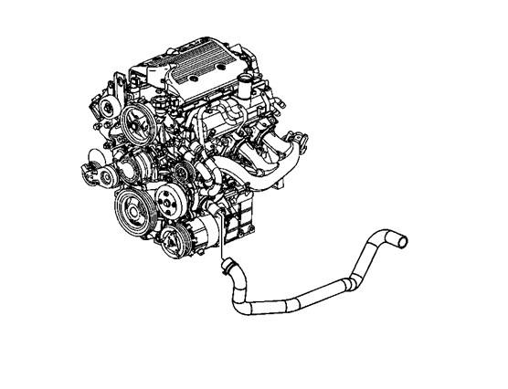

The hose in the picture goes to thermostat housing here is a guide to walk you through the replacement steps with a diagram below to show you the location for your car.

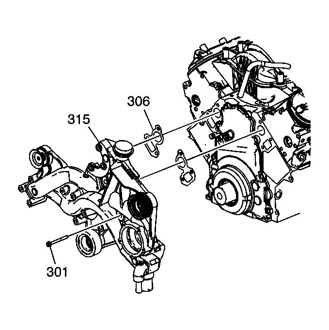

Need to change the thermostat. 5.3l v-8: where is the thermostat and any tips to changing?
Jun 8, 2021 at 3:14 AM (Merged)
DOCFIXIT
  • 18,828 POSTS

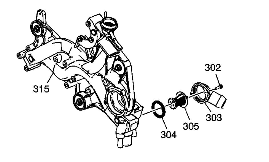

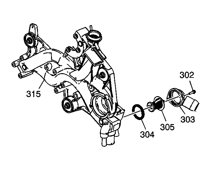

This job is not too bad here is a guide to help you see what you are in for when doing the job and diagrams BELOW to show you what it will be like on your car.
Install the thermostat (305).
Install the O-ring seal (304) and water outlet housing (303).
Notice: Refer to Fastener Notice.
Install the water outlet housing bolts (302).
Tighten the bolts to 15 N.m (11 lb ft)
The thermostat for your car is the water pump check out the diagrams BELOW to see what I am talking about.
Cheers

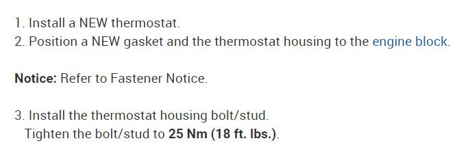

Tighten the bolt/stud to 25 N.m (18 lb ft).

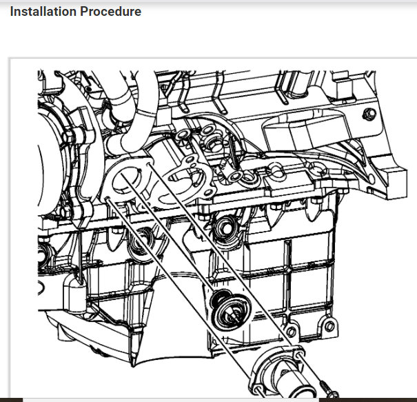

How do you get to the bolts on the thermostat housing to remove thermostat? The problem I ran into was getting to them what do I need to remove and how?..............................................................................................................................................................................................................................................
HMAC300
  • 48,601 POSTS
Hey GMILL21.
You will need a universal 13mm socket to get to the bolts becasue it is in the lower radiator housing on the block.
Partially drain the cooling system.
Remove the water outlet housing bolts
Remove the water outlet housing and O-ring seal
Clean and inspect the water outlet housing O-ring seal mating surfaces.
Here is a good guide on what you will be in for when replacing a thermostat.
Please let us know happens so it will help others.

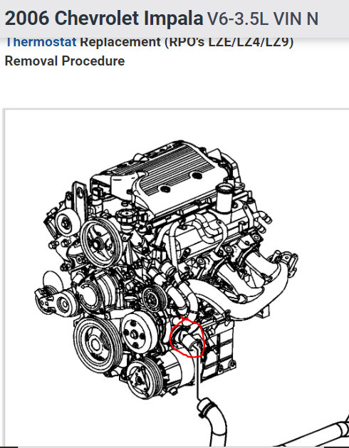

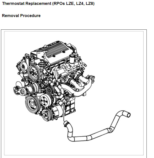

MERLIN2021
  • 17,250 POSTS

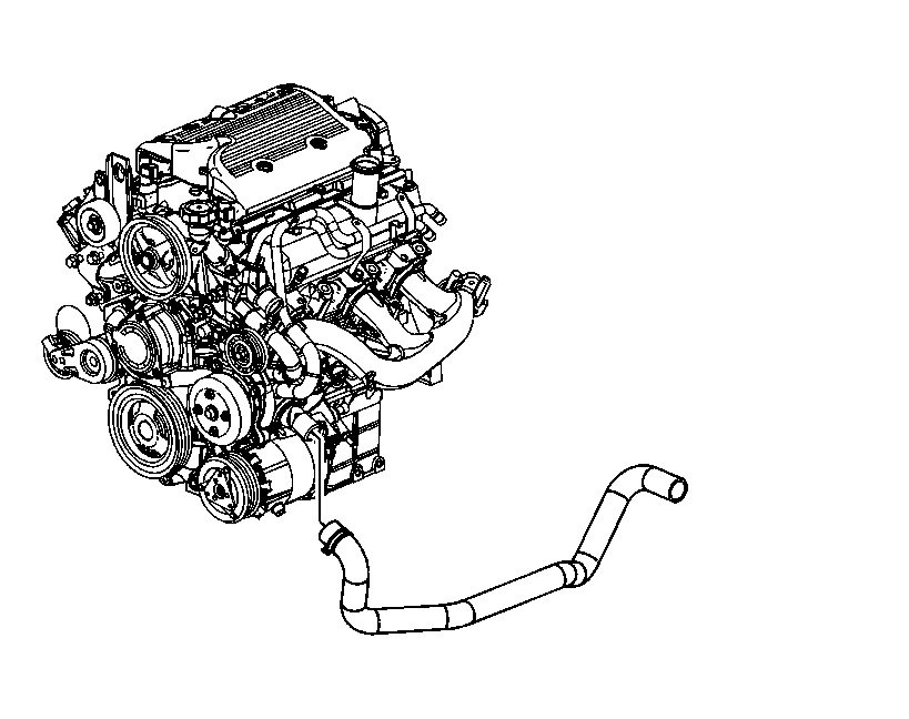

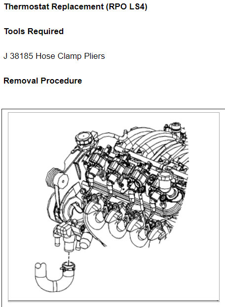

THERMOSTAT REPLACEMENT (RPOS LZE/LZ4/LZ9) Removal Procedure Fig. 72: Identifying Radiator Outlet Hose Clamp & Thermostat Housing 1. Drain the cooling system. Refer to Draining and Filling Cooling System (LS4 Static Fill) or Draining and Filling Cooling System (LZE, LZ4, LZ9 Static Fill) or Draining and Filling Cooling System (9C1, 9C3 Static Fill) or Draining and Filling Cooling System (LS4 GE 47716 Fill) or Draining and Filling Cooling System (LZE, LZ4, LZ9, 9C1, 9C3 GE 4771 Fill) . 2. Remove the air cleaner outlet duct. Refer to Air Cleaner Outlet Duct Replacement or Air Cleaner Outlet Duct Replacement . 3. Reposition the radiator outlet hose clamp at the thermostat housing. 4. Remove the radiator outlet hose from the thermostat housing (3.5L shown, 3.9L similar). Fig. 73: Identifying Thermostat Housing Bolt/Stud 5. Remove the thermostat housing bolt/stud. 6. Remove the thermostat housing and gasket. 7. Remove the thermostat. 8. Clean the gasket surfaces. Installation Procedure Fig. 74: Identifying Thermostat Housing Bolt/Stud 1. Install a NEW thermostat. 2. Position a NEW gasket and the thermostat housing to the engine block. 3. Install the thermostat housing bolt/stud. Tighten: Tighten the bolt/stud to 25 N.m (18 lb ft). Fig. 75: Identifying Radiator Outlet Hose Clamp & Thermostat Housing 4. Install the radiator outlet hose to the thermostat housing (3.5L shown, 3.9L similar) 5. Position the radiator outlet hose clamp at the thermostat housing. 6. Install the air cleaner outlet duct. Refer to Air Cleaner Outlet Duct Replacement or Air NOTE: Refer to FASTENER NOTICE .Cleaner Outlet Duct Replacement . 7. Fill the cooling system. Refer to Draining and Filling Cooling System (LS4 Static Fill) or Draining and Filling Cooling System (LZE, LZ4, LZ9 Static Fill) or Draining and Filling Cooling System (9C1, 9C3 Static Fill) or Draining and Filling Cooling System (LS4 GE 47716 Fill) or Draining and Filling Cooling System (LZE, LZ4, LZ9, 9C1, 9C3 GE 4771 Fill) . 8. Inspect the system for leaks.
https://images.2carpros.com/forum/automotive_pictures/62217_Tstat_2.jpg
https://images.2carpros.com/forum/automotive_pictures/62217_Tstat2_1.jpg
Shouldnt take much more than 1 hour.

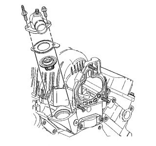

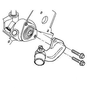

IMPALASS
  • 3,112 POSTS

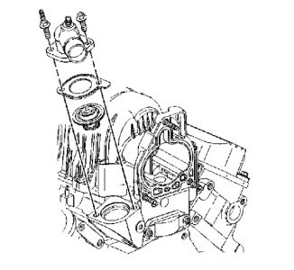

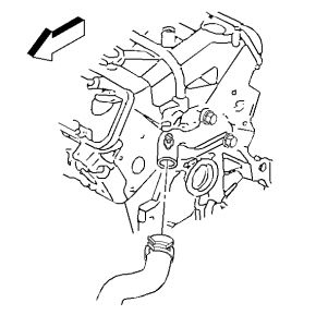

Hello, there are three different V6 engines. 3.4L VIN E, 3.8L SC VIN 1, and 3.8L VIN K. It looks like the 3.8's are the same area. The first two pics are the 3.4 and the last two is the 3.8. Please ensure you provide all the engine information for the car to ensure you are provided the correct info. Thanks.....have a great day.
https://images.2carpros.com/forum/automotive_pictures/248015_2005_Impala_Thermostat_1_1.jpg
https://images.2carpros.com/forum/automotive_pictures/248015_2005_Impala_Thermostat_2_1.jpg
https://images.2carpros.com/forum/automotive_pictures/248015_2005_Impala_Thermostat_3_38_1.jpg
https://images.2carpros.com/forum/automotive_pictures/248015_2005_Impala_Thermostat_4_38_1.jpg

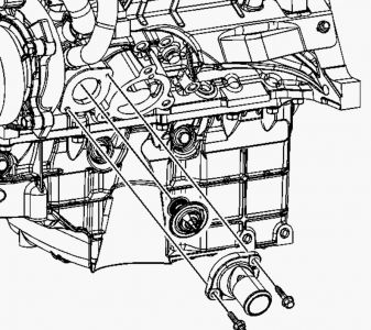

FULNIX

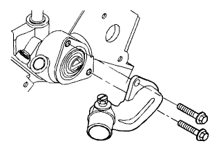

From the diagram in a previous answer it looks as though the Impala's thermostat is located inside of where the radiator hose slips onto part of the manifold that comes from the engine block. If this is correct how do I remove and replace the thermostat?
Thank you in advance,
Jun 8, 2021 at 3:21 AM (Merged)
BLUELIGHTNIN6
  • 16,542 POSTS
yes, as the diagram below shows, there are two bolts needing to be removed from the thermostat housing.
https://images.2carpros.com/forum/automotive_pictures/261618_0996b43f8023075a_1.jpg

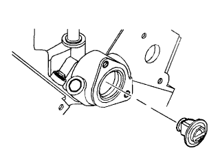

Thank you for all your help. I bought the thermostat and am going to replace it tomorrow. One more question. Is there supposed to be a gasket the goes between the manifold and the engine block or just the rubber round one that is already on the thermostat?
Years ago I replaced one on my 1993 Chevrolet Lumina and I think I remember that car had a gasket that went on the manifold. Just want to make sure I have anything.
Thank you again for all your help.
BLUELIGHTNIN6
  • 16,542 POSTS
The thermostat gasket is the kind of thick round gasket on this vehicle, that is it.

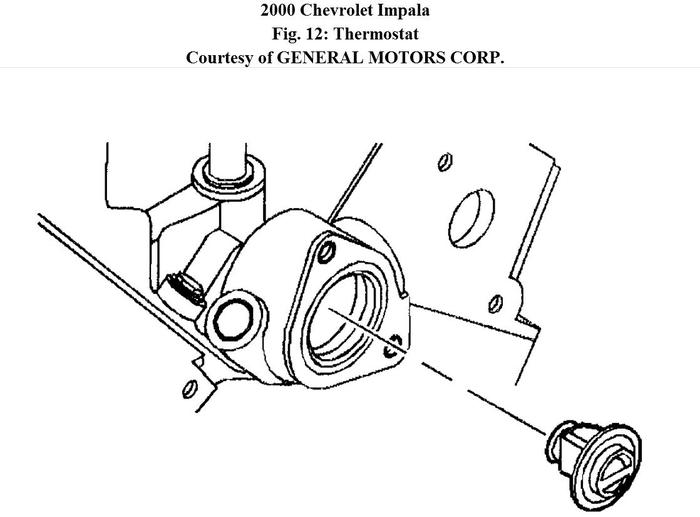

BBUCHMELTER

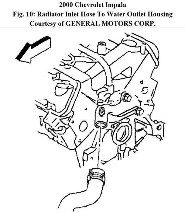

where is the thermostat on my 2000 impala and how do i replace it or at least can i see a diagram? thank you
  • 75,992 POSTS
On a 3.4 the thermostat is on the far right side while standing in front of the vehicle, below the intake. You will need to remove the exhaust crossover and some coolant tubing from the top of the engine to get to it.
3.8L
Drain about 1 gallon of coolant from radiator
Locate removable housing a the engine end of the upper radiator hose and remove
Note how thermostat is installed in housing
Clean both surfaces
Install new thermostat and gasket
Re-fill coolant slowly to prevent an air lock
Start engine and look for leaks
Run engine to normal operating temperature with heater on
Re-check coolant level

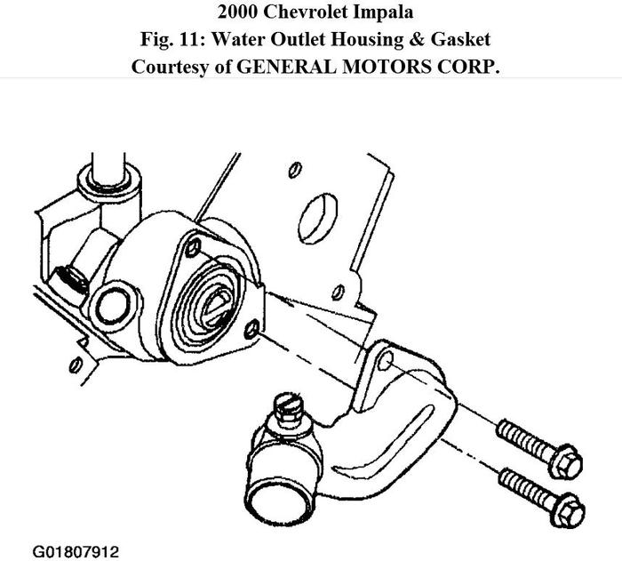

GARYHARRIS48048
replacement of thermostat in 2000 chevy impala
  • 75,992 POSTS
Carefully remove the throttle body air inlet duct.
Partially drain the cooling system. Refer to Draining and Filling Cooling System.
Use the J 38185 in order to reposition the hose clamp at the thermostat housing.
Disconnect the radiator hose from the thermostat housing.
Remove the exhaust crossover pipe. Refer to Exhaust Crossover Replacement.
Remove the thermostat housing bolts.
Remove the thermostat housing and the gasket.
Clean the mating surfaces.

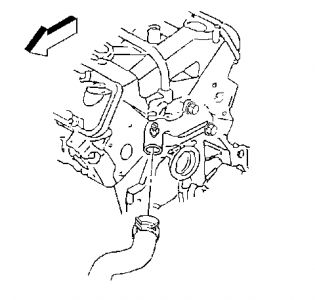

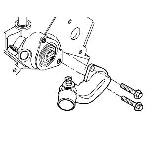

DENNYP
  • 1,824 POSTS
depends on engine size. Here are your two options.
https://images.2carpros.com/forum/automotive_pictures/102900_70064_1.jpg
https://images.2carpros.com/forum/automotive_pictures/102900_30962_1.jpg
https://images.2carpros.com/forum/automotive_pictures/102900_tstat_1.jpg
The last one is for a 3.8l v6 The first two are for the 3.4l v6

KHLOW2008
  • 41,814 POSTS
THERMOSTAT
Removal
1. Remove the air cleaner intake duct.
2. Partially drain the cooling system.
3. Use the Hose Clamp Pliers (J 38185) to reposition the hose clamp from the water outlet housing.
4. Remove the radiator inlet hose from the water outlet housing.
5. Remove the exhaust crossover pipe.
6. Remove the water outlet housing bolts.
7. Remove the water outlet housing and the gasket.
8. Remove the thermostat.
9. Clean the water outlet mating surfaces.
Installation
1. Install the thermostat.
2. Install the water outlet gasket and housing.
3. Install the water outlet housing bolts. Tighten the bolts to 25 N.m (18 ft lbs).
4. Install the exhaust crossover pipe.
5. Install the radiator inlet hose to the water outlet housing.
6. Use the Hose Clamp Pliers to reposition and install the hose clamp to the water outlet housing.
7. Install the air cleaner intake duct.
8. Fill the cooling system. Refer to COOLING SYSTEM BLEEDING.
1. Open air bleed screw located on thermostat housing 2-3 turns. Slowly fill cooling system through radiator neck to base of radiator neck. Wait 2 minutes. Recheck fluid level. Add coolant to restore level to base of radiator neck.
