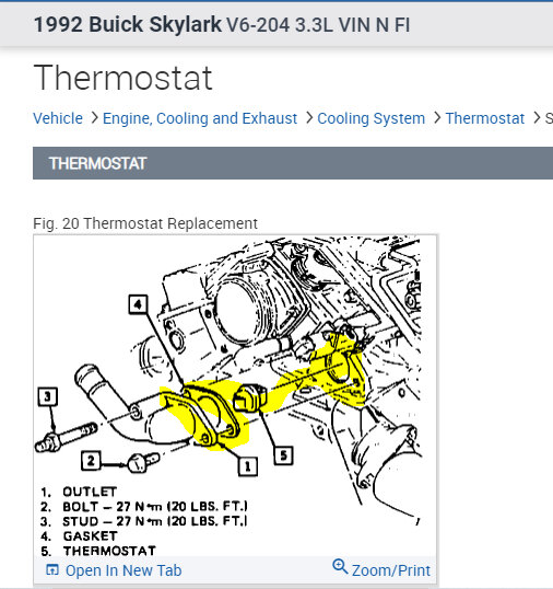

I need to change my thermostat, but I cannot find it anywhere.
Nov 28, 2022 at 8:47 AM
  • 110,248 POSTS

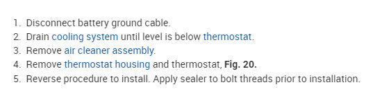

You need to remove the air cleaner assembly to access it. If you follow the upper radiator hose to the engine, it will end at the thermostat housing. The thermostat is under the housing.
If you look below, I attached the directions specific to your vehicle for replacement.
