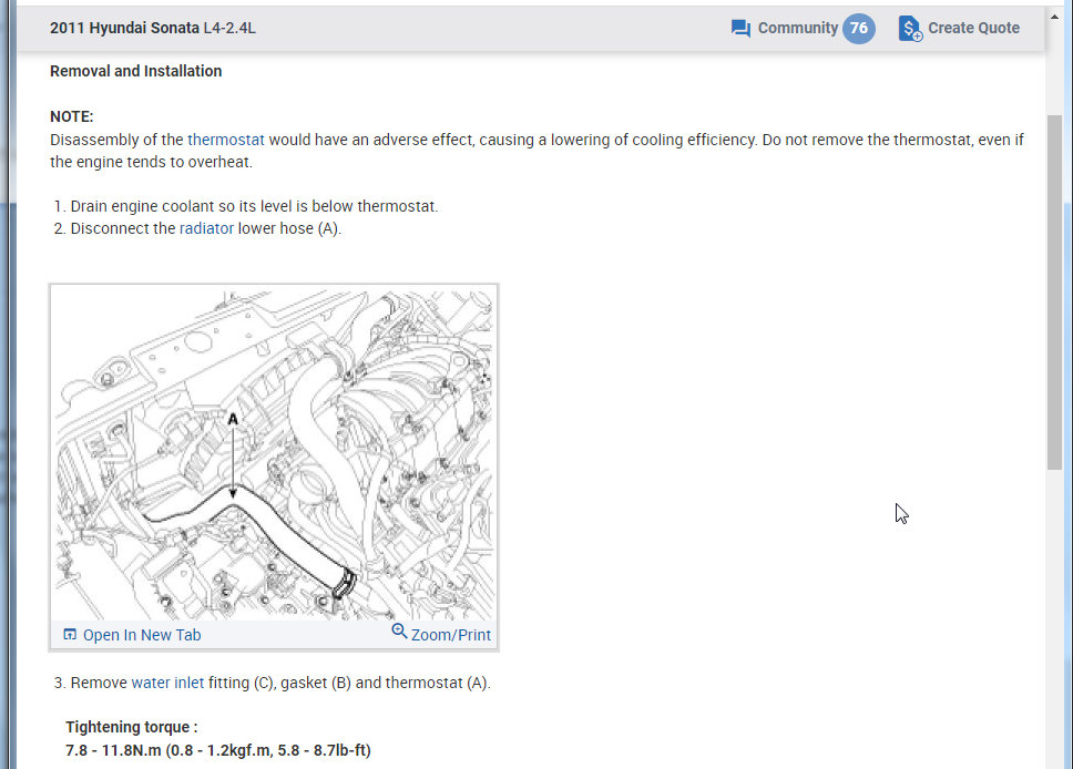

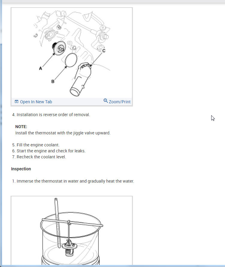

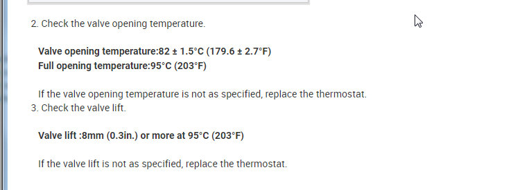

Could somebody please help me with step by step instructions on how to replace the thermostat in the car listed above GLS? I've never done one before.
Oct 23, 2020 at 5:11 AM
I attached the process as requested in the diagrams below for your car and have included a guide to help walk you through the steps.
