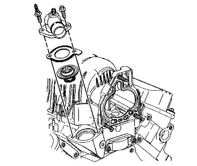

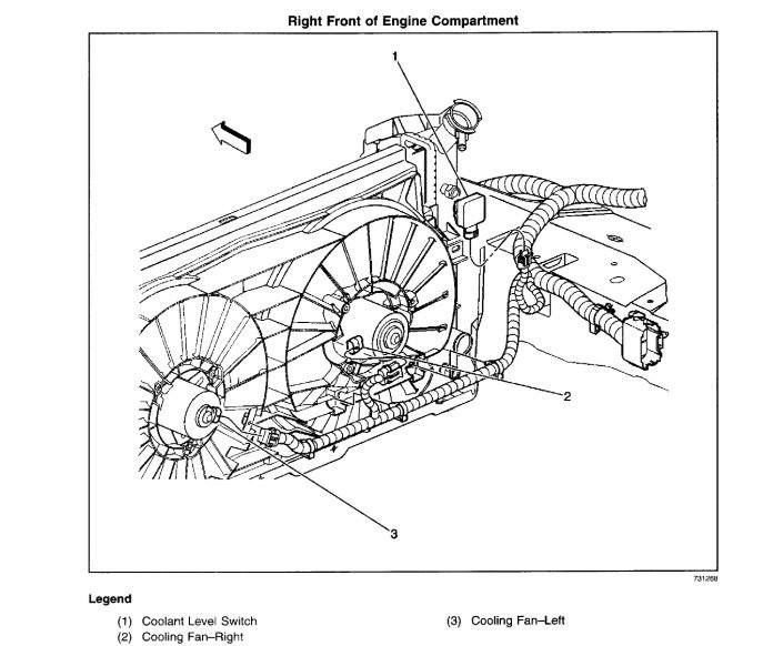

The temperature gauge bottoms out then goes back up then down while driving. If I am stopped at a red light, when light turns green it occasionally shuts off. I was idling while waiting on a friend and it began to overheat. No lights came on, no engine or coolant light. I could feel that liquid popping and shut it off before it steamed.

Did you check and see if the cooling fan was working?
https://www.2carpros.com/articles/replace-electric-fan-motor
How old is the thermostat?

I ran the heater and the temperature came down. The temperature gauge has been fluctuating for the past week between normal operating temperature and 0. I did not notice any odor at the time it was too hot or after driving with the heater on.

I do not know the age of the thermostat because I bought the car less than 6 months ago. I do believe the fans are fine and no fluid leaks. I did add some water just to get home. Should I drain the system and replace fresh coolant as well as get it diagnosed?
Nov 21, 2019 at 7:27 AM
I would replace the thermostat, add new coolant and drive the car and see if it is fixed or if it still has issues.

No, since you said the fans are working, it is not electrical.

Okay, so I likely am looking at replacing thermostat and coolant sensor and drain and flush the cooling system?
Nov 21, 2019 at 9:01 AM
As a start, yes. Replace them and see what happens.
