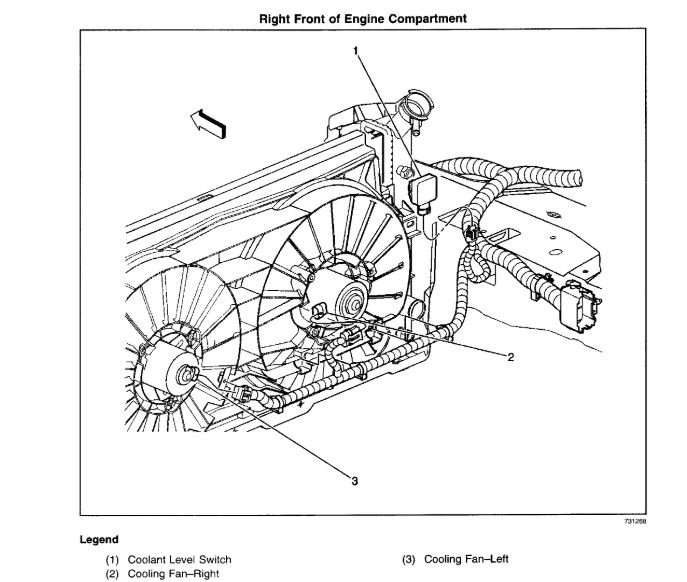

The temperature gauge bottoms out then goes back up then down while driving. If I am stopped at a red light, when light turns green it occasionally shuts off. I was idling while waiting on a friend and it began to overheat. No lights came on, no engine or coolant light. I could feel that liquid popping and shut it off before it steamed.
Nov 21, 2019 at 6:05 AM
Good afternoon,
Did you check and see if the cooling fan was working?
https://www.2carpros.com/articles/replace-electric-fan-motor
How old is the thermostat?
Did you verify the coolant level?
https://www.2carpros.com/articles/engine-overheating-or-running-hot

I ran the heater and the temperature came down. The temperature gauge has been fluctuating for the past week between normal operating temperature and 0. I did not notice any odor at the time it was too hot or after driving with the heater on.
Nov 21, 2019 at 7:19 AM
Okay, got it.
All my questions still stand.
Nov 21, 2019 at 7:22 AM
VICMARMIL
  • 10 POSTS

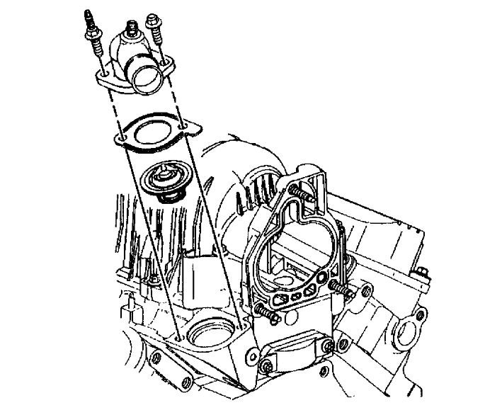

I do not know the age of the thermostat because I bought the car less than 6 months ago. I do believe the fans are fine and no fluid leaks. I did add some water just to get home. Should I drain the system and replace fresh coolant as well as get it diagnosed?
Nov 21, 2019 at 7:27 AM
I would replace the thermostat, add new coolant and drive the car and see if it is fixed or if it still has issues.

Okay, so I likely am looking at replacing thermostat and coolant sensor and drain and flush the cooling system?
Nov 21, 2019 at 9:01 AM
As a start, yes. Replace them and see what happens.
