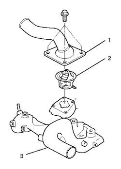

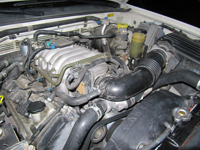

We can't find the thermostat where we can replace it.
Friday, March 29th, 2019 AT 6:39 PM
20 Replies
JOETECHPRO
  • 705 POSTS
Hey ILOVEYOU1962,
On this engine it looks like the thermostat is in a housing connected to the lower radiator hose.
Follow the lower radiator hose and you should see a housing as in the picture attached to this message.
Hope that helps.
Regards, Joe

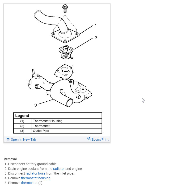

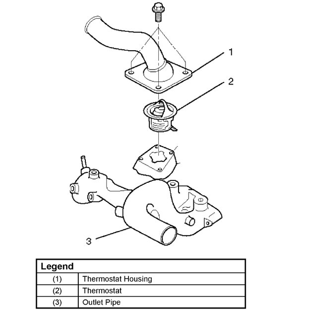

SATURNTECH9
  • 30,869 POSTS
There you go.
-1
Wednesday, October 7th, 2020 AT 12:51 PM (Merged)
  • 75,992 POSTS
Removal
Disconnect battery ground cable.
Drain engine coolant from the radiator and engine.
Disconnect radiator hose from the inlet pipe.
Remove thermostat housing.
Remove thermostat (2).

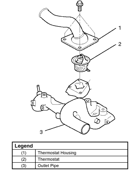

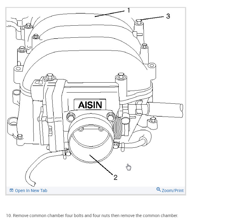

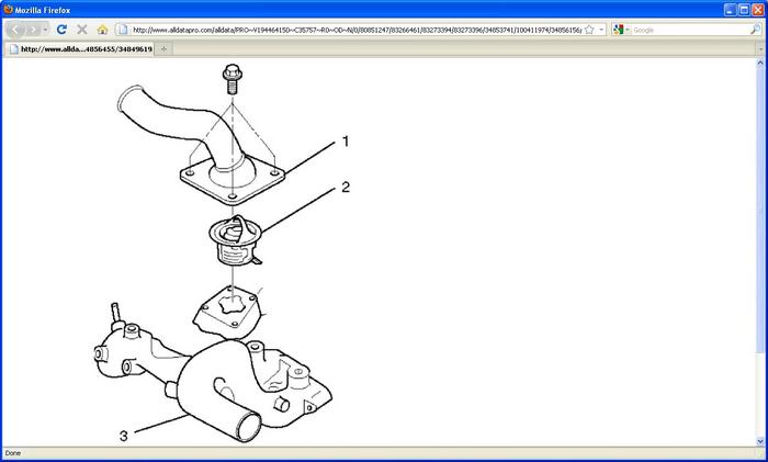

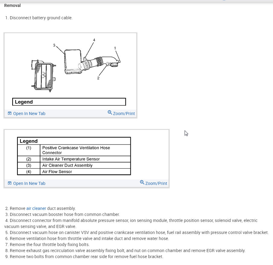

Please provide step by step instructions on how to replace the thermostat on the car listed above. I don't want just general instructions on any car. I want specific instructions for my car only! I am a girl and trying to do this by myself. Thank you!
Hi Bonnie,
Here is the service procedure from the manual for your vehicle. Unfortunately, manuals of this age tend to leave out some pretty big steps because they are intended only for technicians who know the steps prior to getting to the point of remove the actual thermostat.
The steps that are missing from this procedure are that you need to remove the intake manifold. Not a simple task. Here is a video that shows briefly what it looks like to do this:
https://youtu.be/bzGyVliYlig
I would not recommend anyone perform this if you are not familiar with this engine because it is not the easiest thing to do. Please let me know if you need more information. Thanks

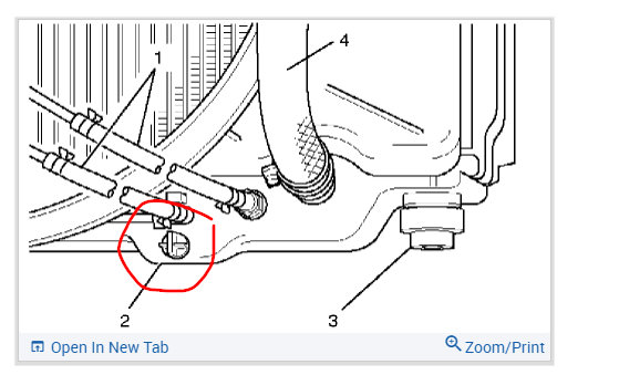

FYI - each attachment is labeled. The fourth one just shows where the drain plug is on the radiator.

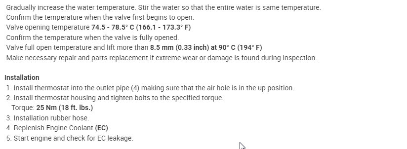

  • 110,052 POSTS
Here is a guide that will walk you through the steps
Install the thermostat into the outlet pipe (4) making sure that the air hole is in the up position. Install thermostat housing and tighten the bolts to 18 ft. lbs. (25 Nm).
Attach the radiator hose to the inlet pipe. Refill the engine with the proper type and amount of coolant. Connect the negative battery cable. Start engine and check for coolant leakage.
Cheers

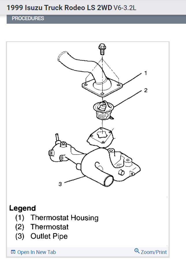

I need help in replacing the thermostat. It is in a difficult place and I just want to know the step-by-step instruction and a diagram would be very helpful too. It seems to be in the engine block and I think the top of the engine block might need to be removed to get to the thermostat.
Wednesday, October 7th, 2020 AT 12:52 PM (Merged)
KHLOW2008
  • 41,814 POSTS
Here is a guide to help walk you throught he steps with the instruction in the diagrams below to show you how on your car.
THERMOSTAT
Removal
Disconnect battery ground cable. Drain engine coolant from the radiator and engine. Remove throttle body. Disconnect radiator hose from the inlet pipe. Remove thermostat housing. Remove thermostat
Install thermostat into the outlet pipe making sure that the air hole is in the up position. Install thermostat housing and tighten bolts to 25 N.m (18 ft. lbs.). Installation rubber hose. Replenish engine coolant. Start engine and check for coolant leakage.

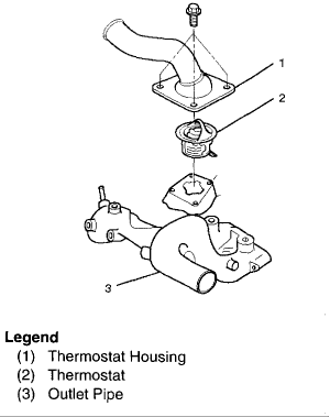

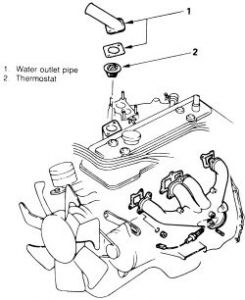

BLUELIGHTNIN6
  • 16,542 POSTS
https://www.2carpros.com/forum/automotive_pictures/261618_0900c15280062454_1.jpg

THERMOHEAD
  • 1994 ISUZU RODEO
  • 2.4L
  • 4 CYL
  • 2WD
  • MANUAL
  • 180,000 MILES
What temperature thermostat do I need for replacement?
Wednesday, October 7th, 2020 AT 12:53 PM (Merged)
CJ MEDEVAC
  • 11,005 POSTS
A 180 degree thermostat is what it came with.
Bumping up to a 195 will make your heater throw out more heat, if you might be needing that.
The Medic
