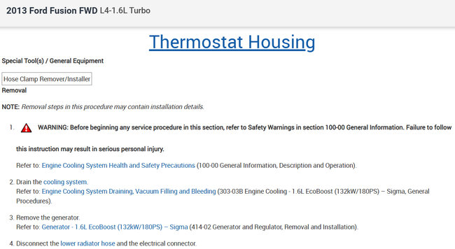

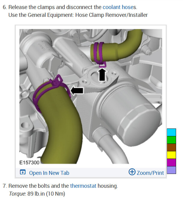

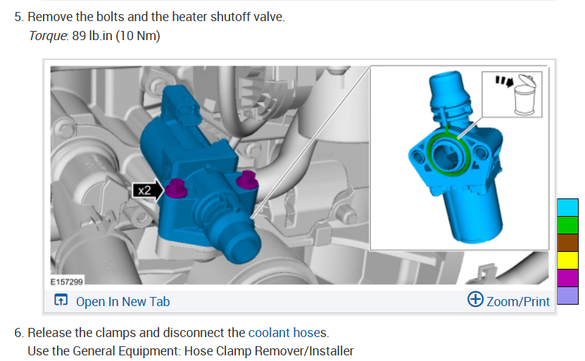

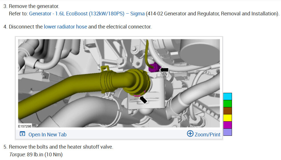

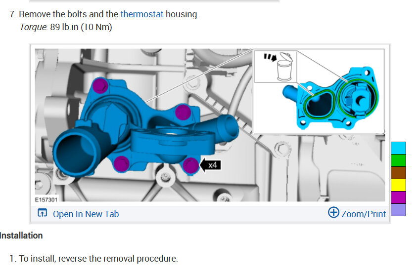

Thermostat location needed.
Jan 13, 2025 at 8:16 AM
Experienced Mechanic
55,711 POSTS
Sure, here is how to change the thermostat out and its location but you must wait until the engine is fulling cooled down before you begin. Check out the images (below). Let us know if you need anything else.
