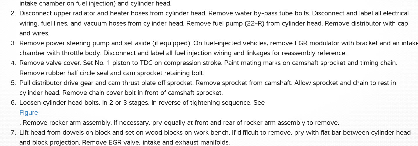

Another question, is there a way to remove cylinder head with out removing the cam shaft and rocker arm assembly?
Mar 7, 2016 at 11:32 AM
HMAC300
  • 48,601 POSTS
The head bolts go through rockers, so they have to come off. See the picture for instructions.
