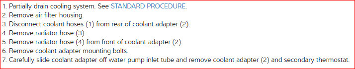

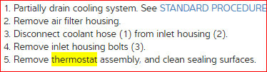

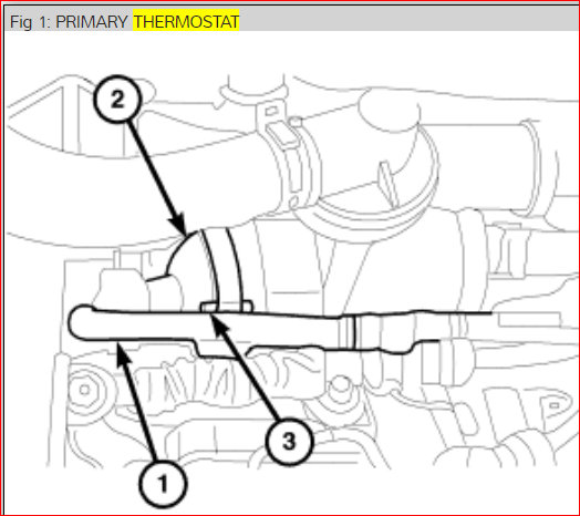

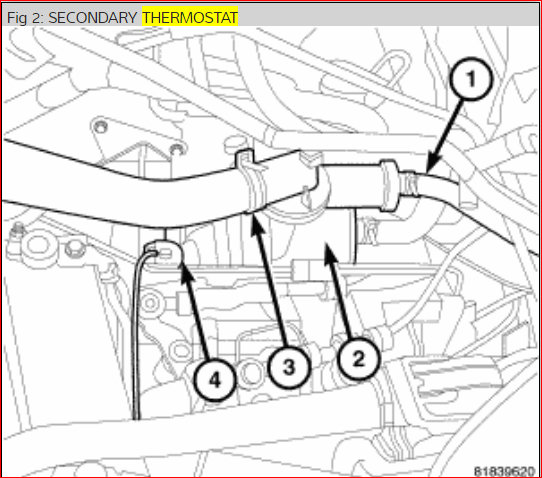

Where is the thermostat located?
Sep 10, 2018 at 7:30 AM
DANNY L
  • 5,648 POSTS
Hello, I am Danny.
It it located near the upper radiator hose.There is a primary and secondary. I have attached a few pictures and step-by-step instructions how to remove. I have also attached a tutorial showing what is involved. Hope this helps and feel free to ask any questions. Thanks for using 2CarPros.
