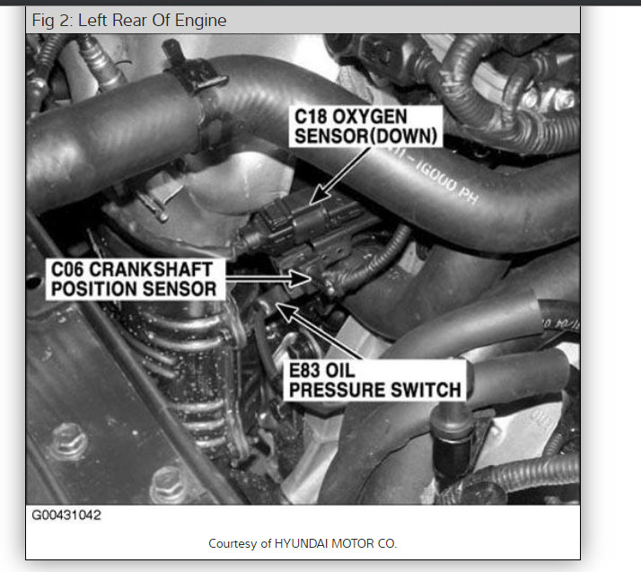

During recent two weeks, my car has been shutting off four times while driving especially when I decreased the speed. Like when I want to park or I stop to rear back. It started working again after many trials of starting. Also, it does not start after about 5-10 minutes after the car is turned off. Like when I go shopping and it takes 10 minutes and I come back to drive my car again. None of the dashboard warning lights is on. I changed the timing belt just recently. The battery seemed to have no problem and also I took my car for inspection and their computer did not show any codes.
Oct 26, 2020 at 4:05 AM (Merged)
  • 110,240 POSTS
Welcome to 2CarPros.

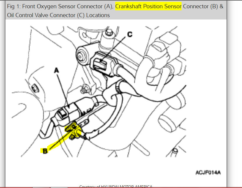

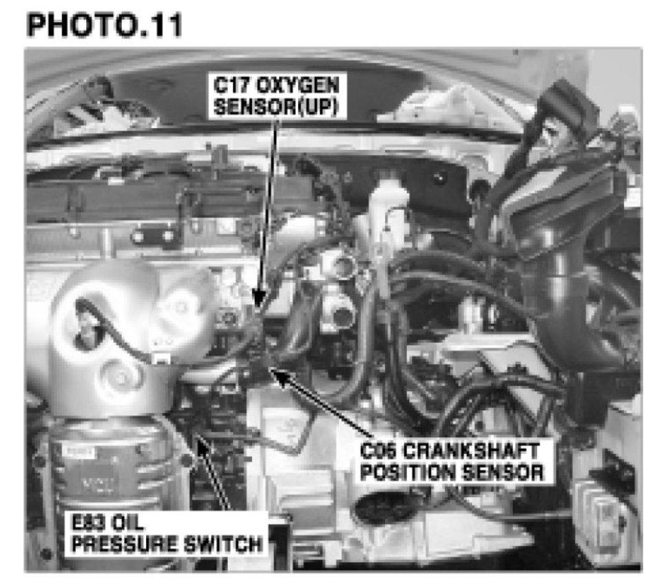

Based on the description, it sounds like you may have a crankshaft position sensor going bad. Often times, they will fail when the get hot or warm up. If the car sits for 10 minutes, there is no more air circulating and the sensor will get hotter. Under certain conditions, they will not set a diagnostic trouble code.
Do me a favor, take a look through these links. The first describes the sensor I am referring to, the second discusses symptoms, and the last shows in general how one is replaced.
https://www.2carpros.com/articles/how-a-crank-shaft-angle-sensor-works
If there is no code generated, then what needs done is this. Either a live data scanner needs connected to the system to check for an RPM signal when it won't start or you need to check to see if the ignition has lost spark.
Here is a link showing how to check for spark:
Here are a few links to help with checking for spark.
__________________________
If it is determine that the sensor is going bad, I attached a pic of the sensor's location to help.
Let me know if the symptoms above seem to mirror what you experience. Also, let me know if I can help.

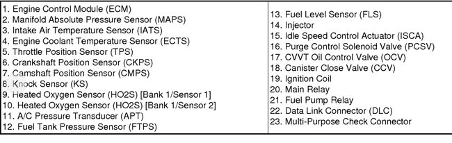

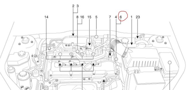

HMAC300
  • 48,601 POSTS
This sounds like a classic crankshaft angle sensor which when they fail will not leave a code but to be sure this guide will help us figure the problem out with diagrams below to show you where the sensor is located so you can check it out.
and
https://www.2carpros.com/articles/engine-stalls
Check out the diagrams (Below). Please let us know what you find. We are interested to see what it is.

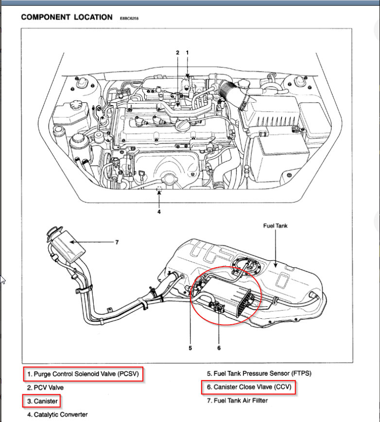

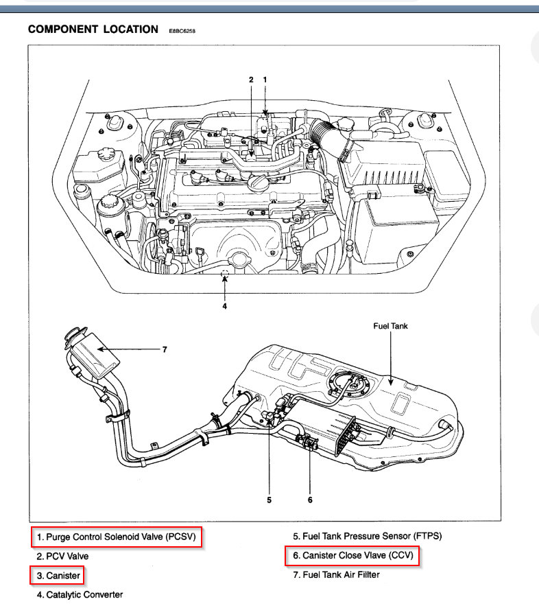

MADISONTHOMASA4
My car will barely go when I try to go and it’ll go 5 miles an hour when it says 20 and right after I get gas my car will shut off while I’m about to drive or it shakes really bad.

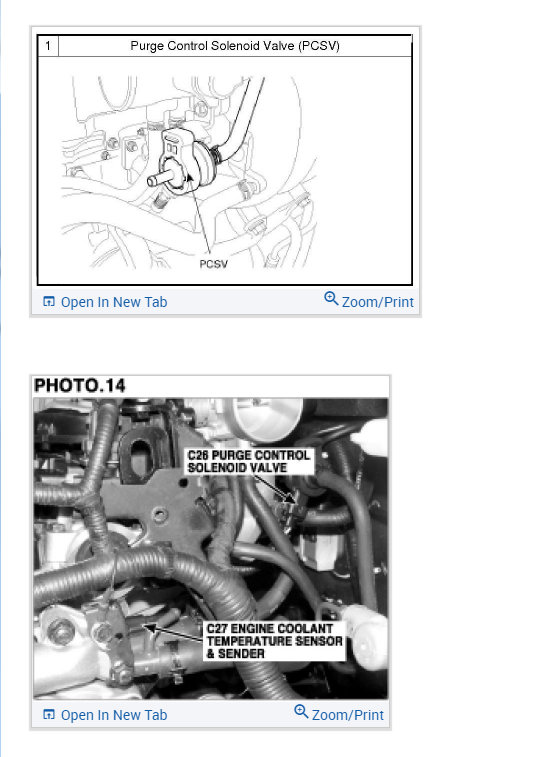

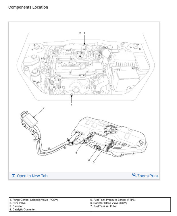

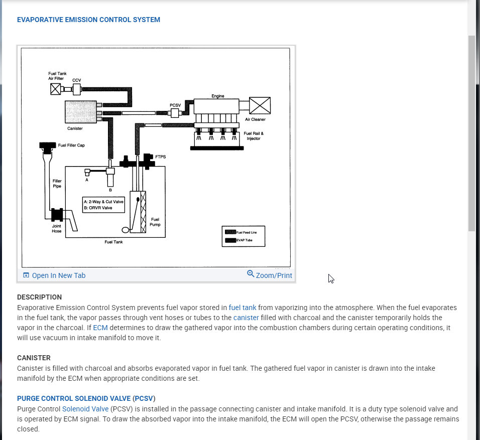

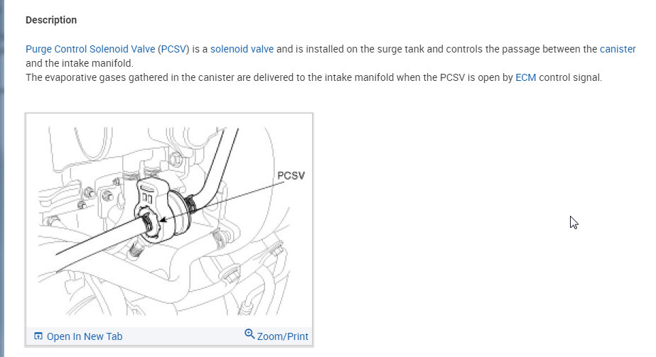

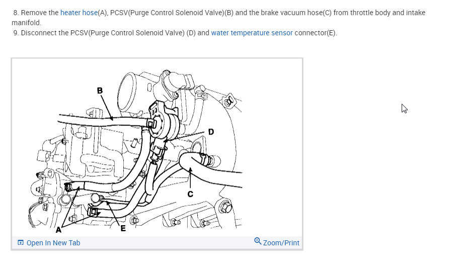

More then likely you have an issue with the purge solenoid being stuck open. This is a pretty common issue when this part fails.
Normally this happens when the fuel tank is topped off or filled when the engine is running. So if you put more fuel in the tank when the pump first shuts off then you are possibly putting fuel into the emission control system and causing this issue.
I would suggest replacing the charcoal canister and purge valve and see if this issue continues.
CLEFFEL
my car stalls and and runs a bit rough after refueling. After a few minutes it runs fine. I've changed purge valve and fuel pump. Still have the problem. Any ideas?
Oct 26, 2020 at 4:06 AM (Merged)

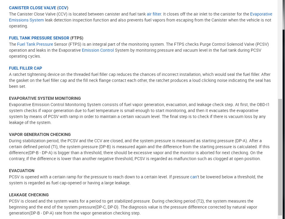

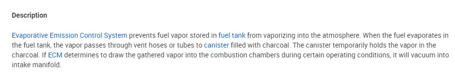

This is a common issue when the evaporative emissions system has raw fuel in it rather than vapor.
Basically this system is designed to take the vapor (hydrocarbons) from the top of the fuel inside the tank and route it to the engine to use as additional fuel rather then venting it to the atmosphere.
This system is only supposed to have vapor in it but when the charcoal canister gets raw fuel in it, it breaks down the charcoal and that damages the purge valve. This allows more vapor and fuel in to the engine then it can handle and the PCM cannot adjust for it so it runs rich. This means there is too much fuel in the system and it runs poor or doesn't start.
Let me know if you have questions and we can go from there. Thanks
CLEFFEL
Thank you, I did replace the purge valve. And also fuel pump. Is there any other reason there could be for this problem?
Yeah. It is the charcoal canister that I mentioned. More than likely that has raw fuel in it. If that is the case then every time the purge valve opens it is allowing too much vapor in.
When you fill the tank now it is forcing even more vapor in the canister and it can't hold anymore so it is pushed into the engine. I would suggest removing the canister (circled) and shaking it and seeing if you hear fuel in it. Then replace that and the CCV on the side of it.

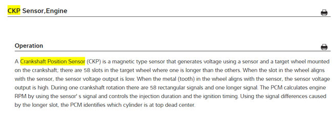

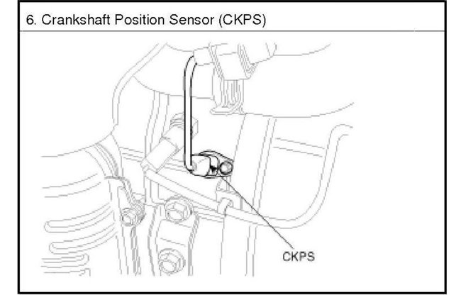

SCGRANTURISMO
  • 4,897 POSTS

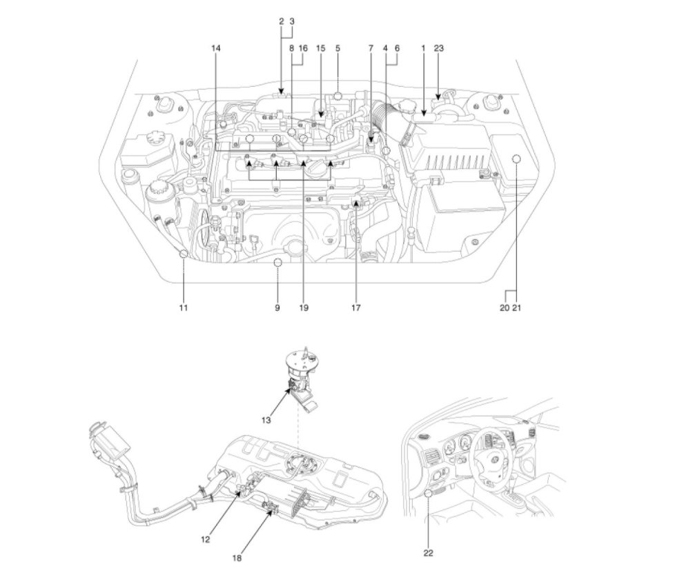

Hello again,
Okay, this could be a problem with your vehicle's Crankshaft Position Sensor (CKP) starting to fail. Your vehicle's Power-train Control Module (PCM) or "computer" uses this signal to determine where the engine is in it's 4 stroke cycle. It the turns on the fuel injectors and makes the spark plug spark accordingly. The sensor when starting to fail, will usually do it when it gets warm. Here are a couple of links below for you to go to:
In the diagrams down below I have included the description of operation as well as the location of the CKP for your vehicle. Here is a link for you to go to on the removal and installation of the CKP:
Please go through these guides and get back to us with what you are able to find out.
