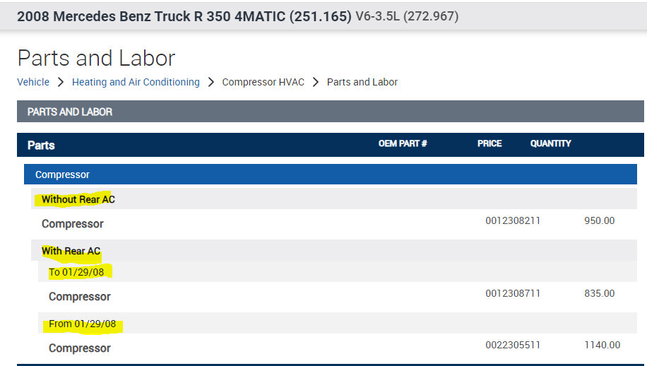

Are there any brands of A/C compressors that can be used on a Mercedes Benz?
2008 MERCEDES BENZ R350
140,000 MILES • 6 CYL • 4WD • AUTOMATIC
SILVAELISEU
Someone told me if I don't use an exact brand. The computer is going to show that after the repair is done. Is this right?
Nov 28, 2023 at 6:50 AM
  • 110,240 POSTS
If you purchase a direct replacement compressor, it should be fine. However, there are different compressors based on the system and production dates.
I attached a pic below which provides the OEM part numbers based on need. If you purchase one, just make sure it replaces the part number indicated.

See pic below.
