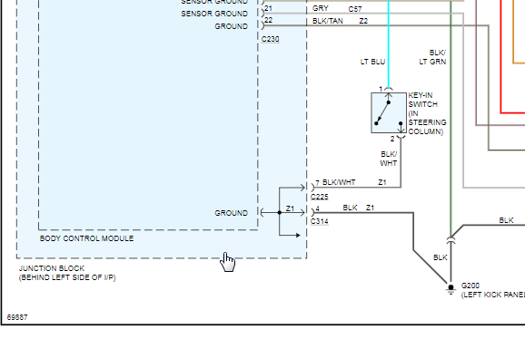

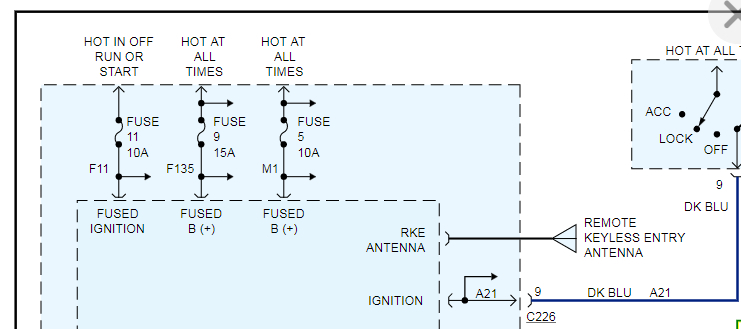

Car will run briefly, then shut off. Is there a relay associated with the BCM on this model?
Jul 11, 2019 at 9:00 PM
Hi MTBEAR,

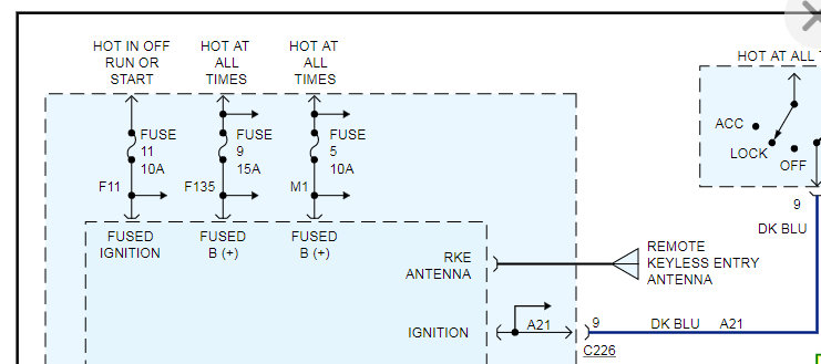

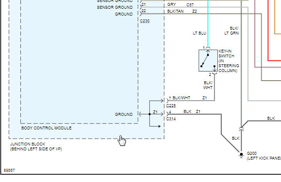

There is not a relay specifically for the BCM. I attached the wiring diagram to show the three fuses that the BCM has. This vehicle has the BCM and Junction block connected. They can be separated but they are installed as one unit.
