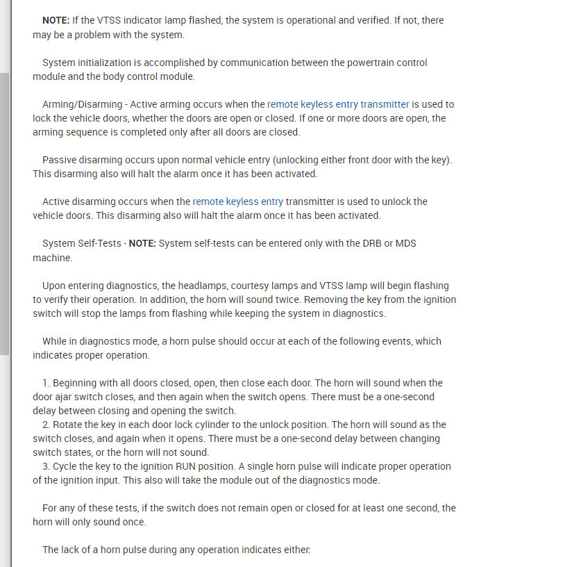

Next here is a guide that will help with resetting the system:
https://www.2carpros.com/articles/how-to-reset-a-security-system

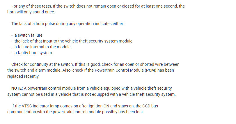

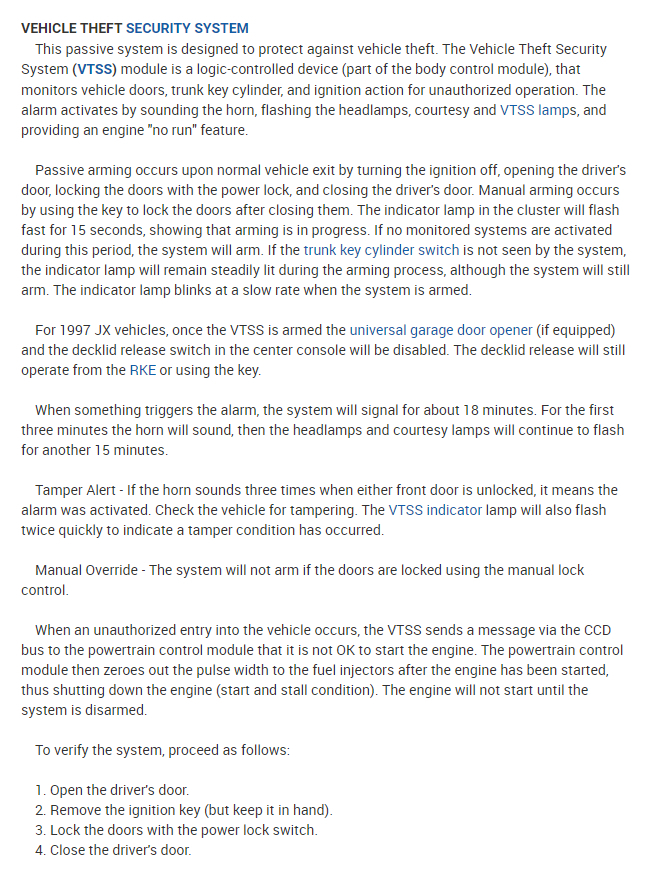

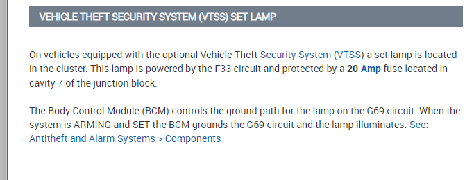

If this is okay then we need to next starting running through the testing that is supplied below. Basically we need to run the diag for this system which is described below and find out what is causing the system to activate. This is a self test so please follow these instructions and let us know what you find.
Thanks
