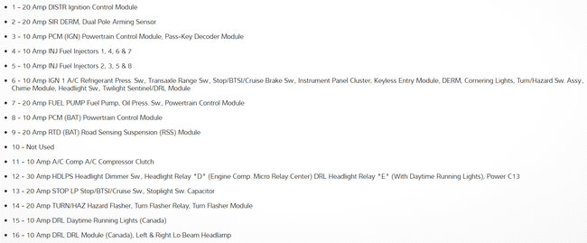

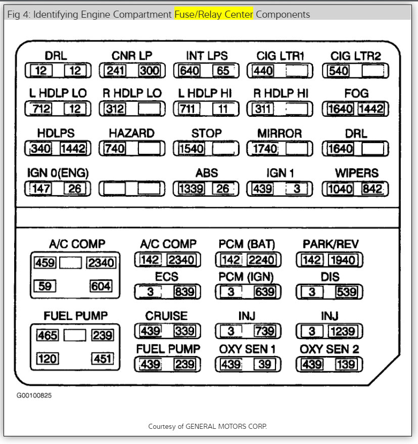

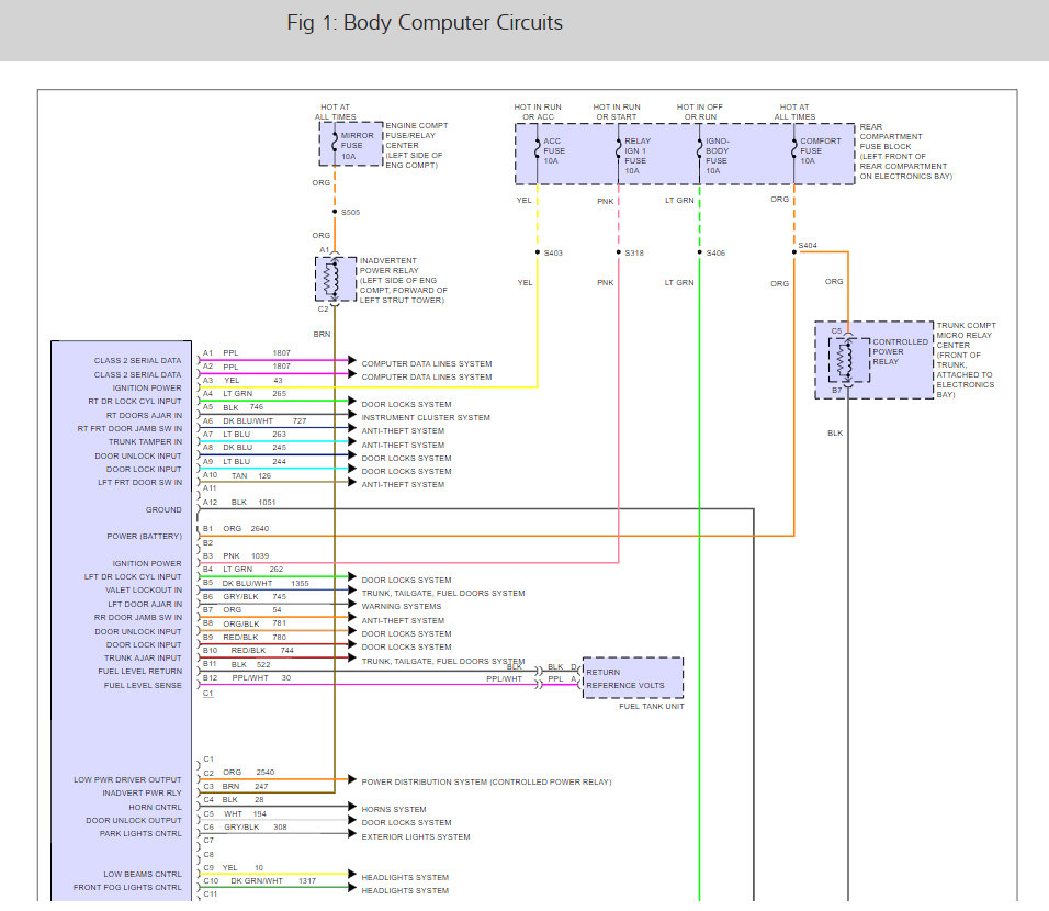

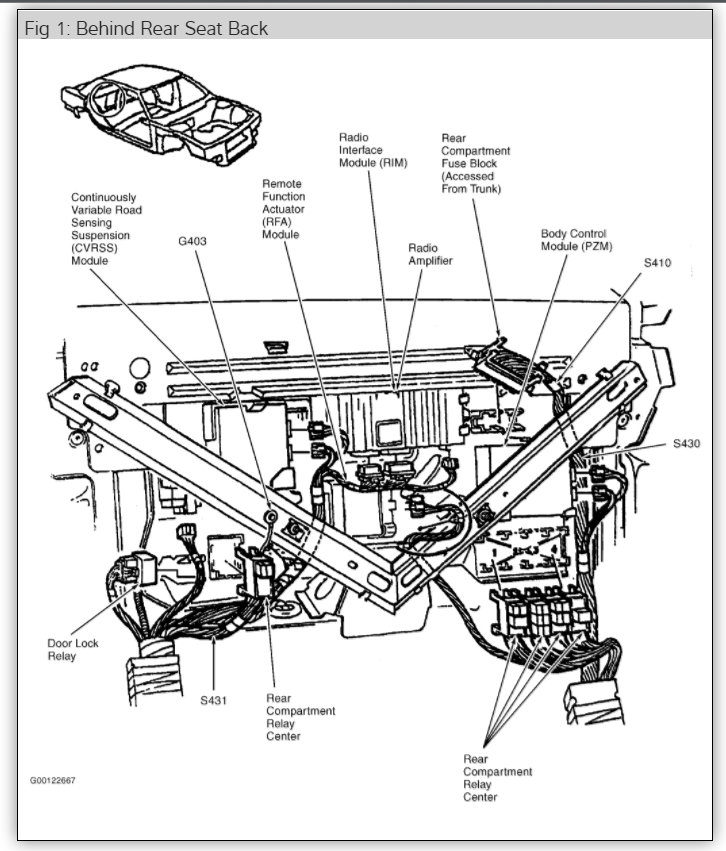

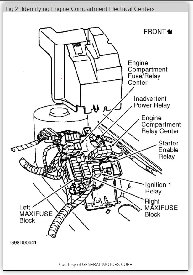

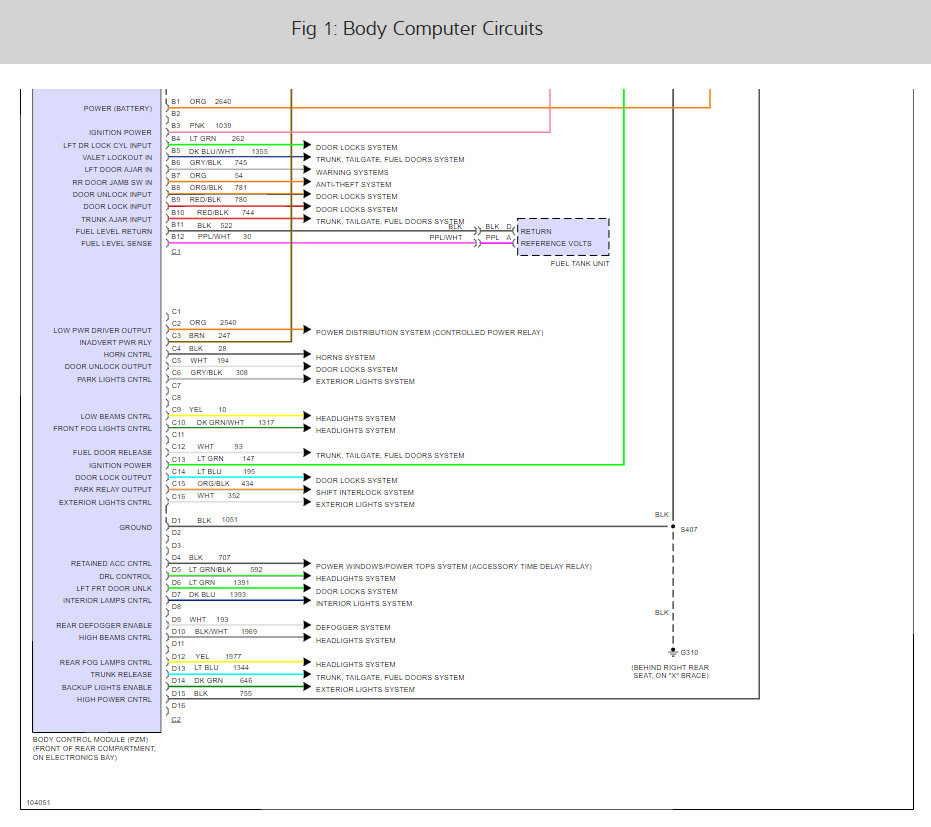

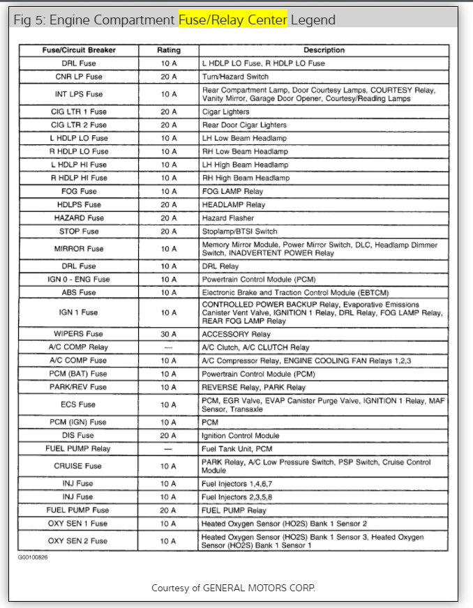

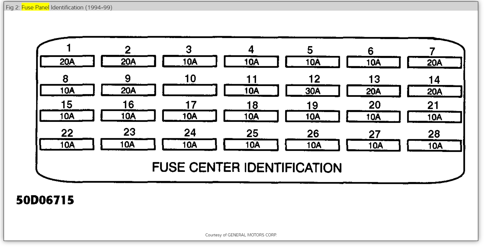

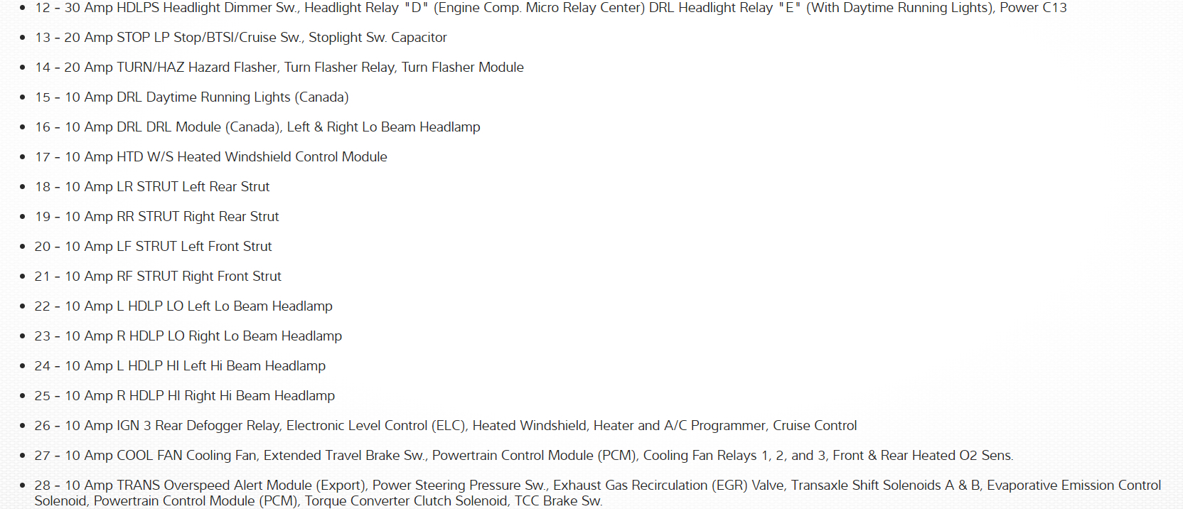

It sounds like you have a BCM that is out or a bad ground or power supply to the BCM. Here is a wiring diagram and the BCM location so you can test for power and ground. If okay then it looks like the BCM will need to be replaced.
There are 5 fuses that run the system they all must be checked before you begin. They are listed in the wiring diagram below.
and
and
(Check out the diagrams below) If the BCM is bad you will need to have it programmed to the car before it will work.
