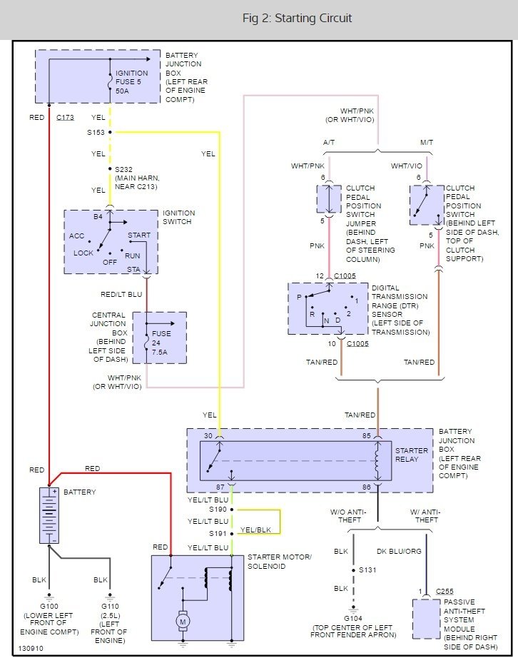

I was recording data with a Actron code reader and while it was recording I replaced a coil wire. When I tried to erase a 305 code the code reader quit picking up a signal. When I tried to start the truck I did not have any power to the truck except for the theft light on the dash flashing. I do get a clicking around the middle of the dash when the key is in the cylinder and open the door. Clicking goes off when I tun the Key. Any ideas?

Try locking and unlocking the truck from outside and check all your fuses with a test light. It sounds like you tripped a theft deterrent.

Thanks, I am going to try a different pcm relay.

Truck was turning over but not firing or getting fuel. Assumed it was anti theft. Tried a reset trick, now it will not crank. Also, anti theft light is blinking fast. Let me add. The anti theft light was flashing fast before trying anything. I do not have a second key. The "trick" was door open, ignition on, disconnect and reconnect the battery. Something I saw online. So, that is the only option? Is it possible that certain shops may have the scan tool? Or dealer only?

I would try a hard system reboot this is done by removing the negative battery cable from the battery and holding it to the positive battery terminal for 1 minute this will discharge the system capacitors.
https://www.2carpros.com/articles/how-to-reset-a-security-system
Let me know how it goes.

I would look at all if the fuses and test the starter relay, here are a couple guides and a diagram to hep you do some testing and get the problem fixed.
and
Please run some tests and get back to us so we can continue helping you.

The system hard reboot worked for me btw.
