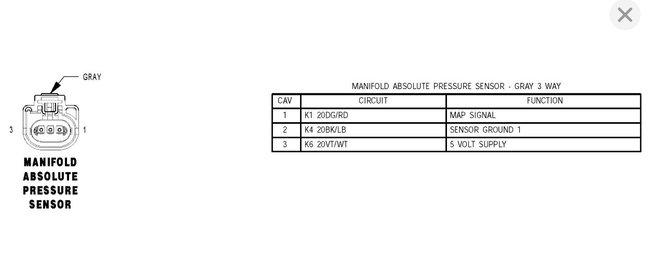

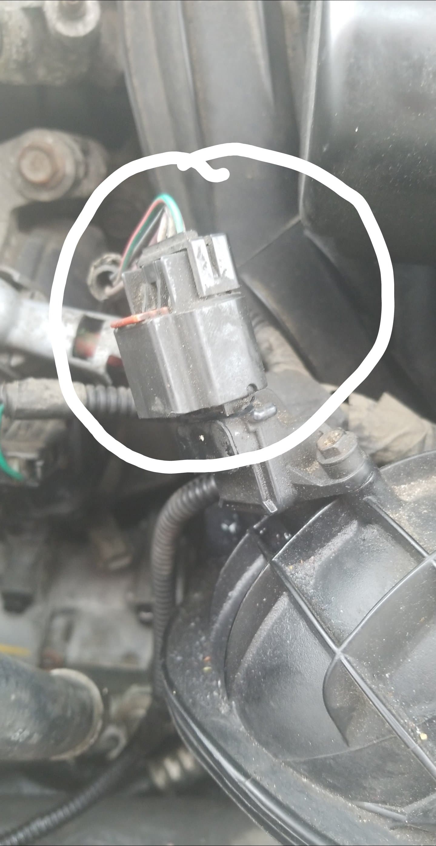

After replacing my A/C compressor and belt I noticed my MAP sensor was sitting kind of crooked. I started then having misfiring and low voltage (tested at Advanced Auto) made me wonder if it was the MAP sensor. I unplugged the wire from the MAP sensor and I noticed a prong was snapped and two others were bent. I got a new MAP sensor but I feel like I need to get the wire as well, but I do not know what that wire is called or where to find it.

It is called a pigtail. When you go to a parts store tell them you need a big tail for the MAP sensor. It will come with the connector and wires already in there. All you need to do is join them by soldering and shrink wrap when connecting.
