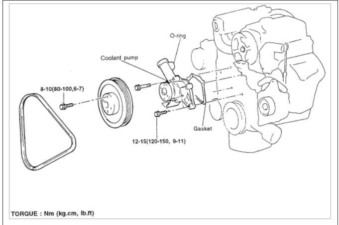

My water pump is bad. I have a new one and need step by step directions on how to change my water pump.

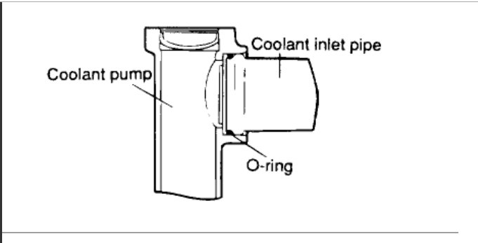

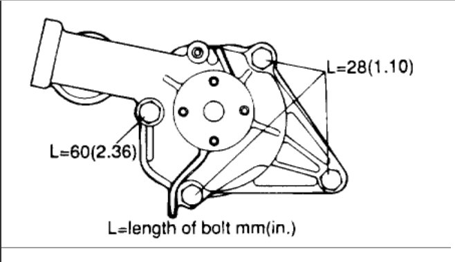

Here is a generic guide on how to replace a water pump which you can go over to know how the job is done:
https://www.2carpros.com/articles/water-pump-replacement
Removal:
Drain the coolant and disconnect the coolant outlet pipe connection hose from the coolant pump.
Remove the drive belt and engine coolant pump pulley.
Remove the timing belt covers and the timing belt idler.
Remove the coolant pump mounting bolts, then remove the generator brace.
Remove the coolant pump assembly from the cylinder block.
Below there are diagrams of what it will be like on your car.
