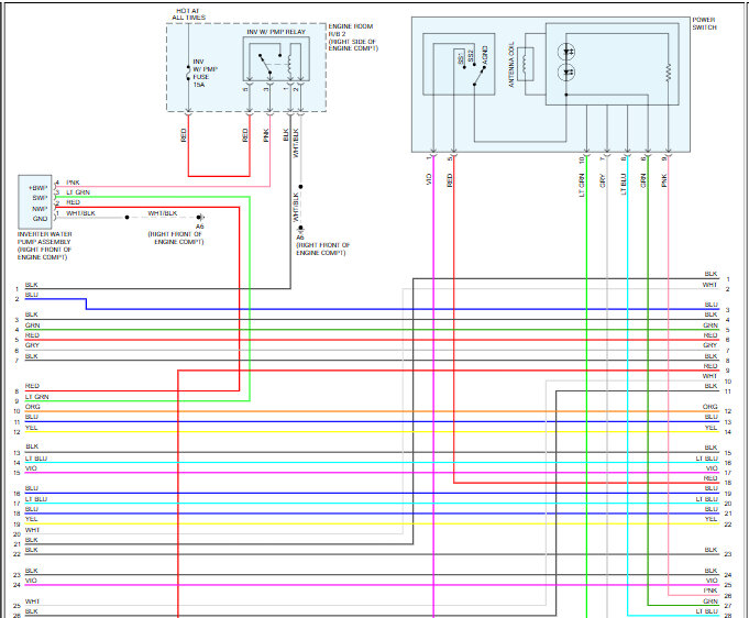

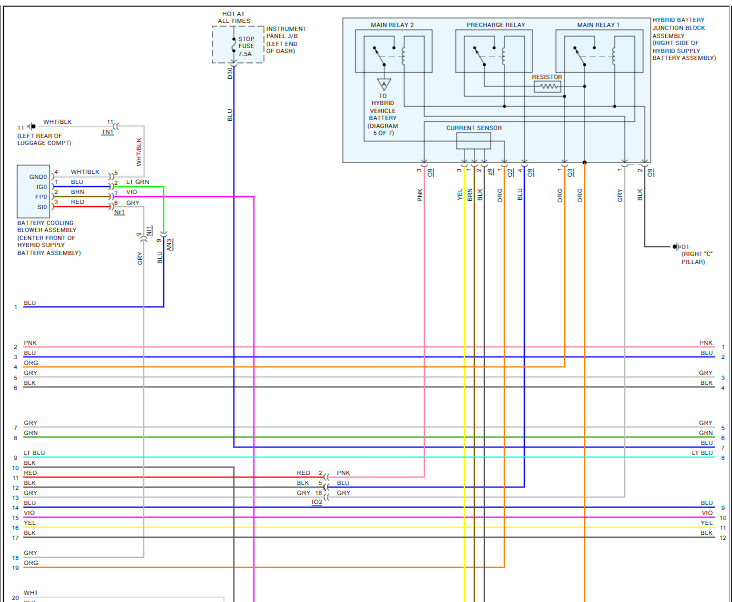

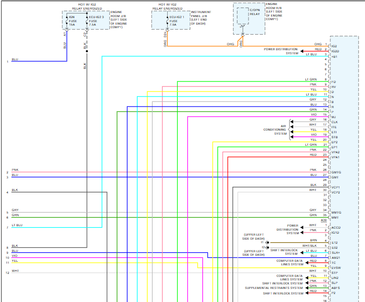

The vehicle could not drive on limp mode fault code:P0A80 and P3018
2015 TOYOTA CAMRY HYBRID
112,345 MILES • 2.5L • 4 CYL • 2WD • AUTOMATIC
MALLYBOY
  • 329 POSTS
The vehicle started this problem after body repair from PANEL-BEATER.

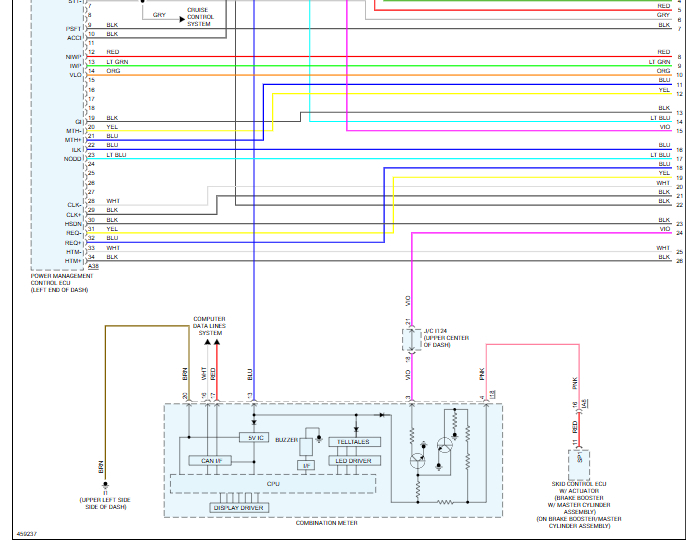

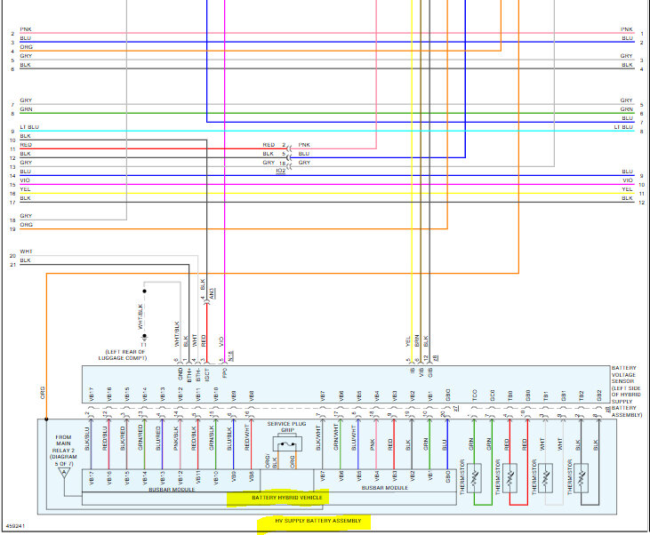

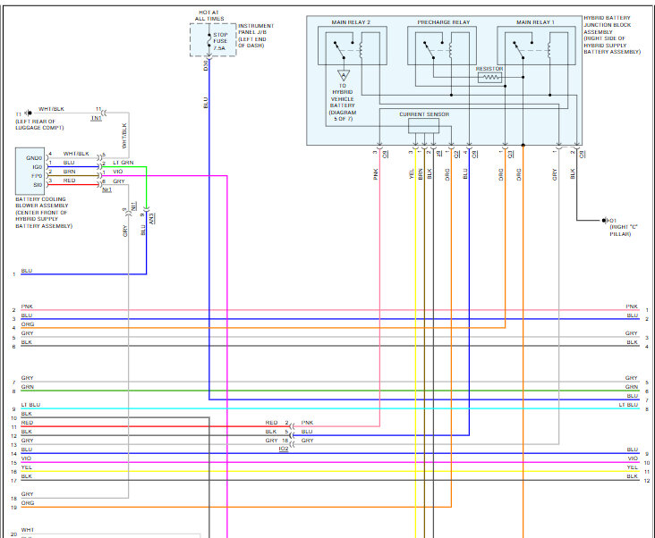

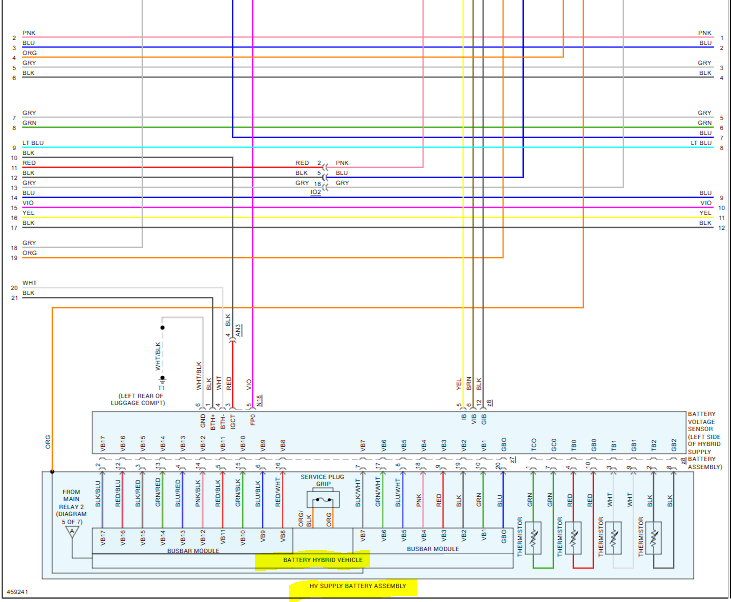

I diagnose this vehicle and detect P0A80-HV battery need replacement and P3018:Battery block is getting weaker.
So I need wire diagram from Smart unit to HV BATTERY PACK To trace whether power circuit or ground was burnt by flame from oxy-acetelyn blow pipe
Nov 27, 2025 at 3:22 AM
  • 110,244 POSTS

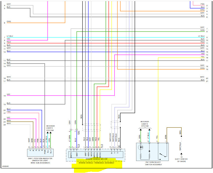

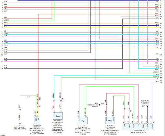

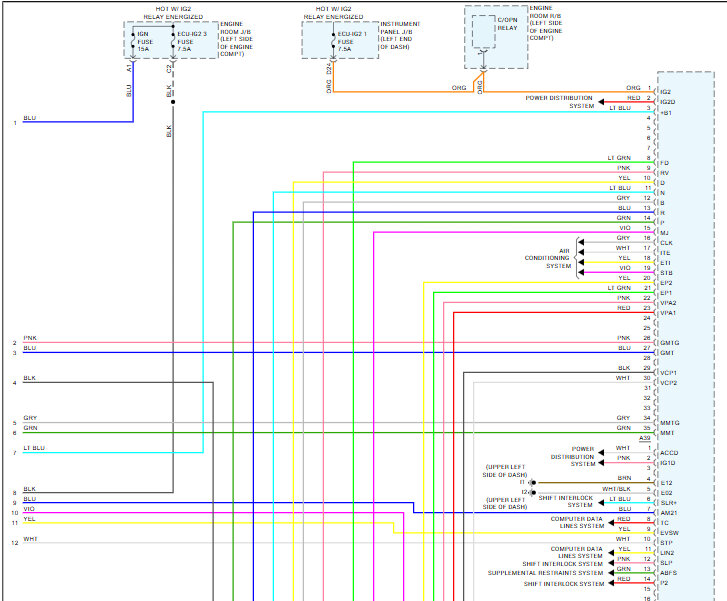

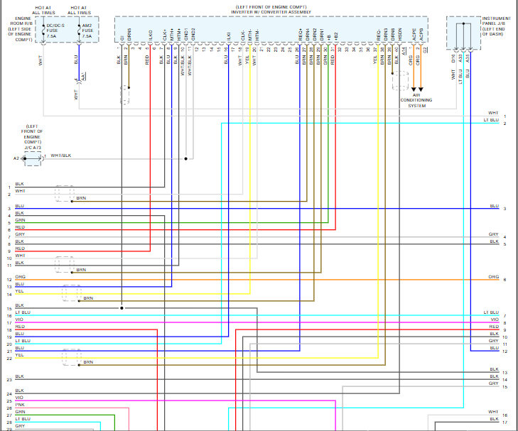

Hi:

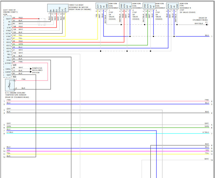

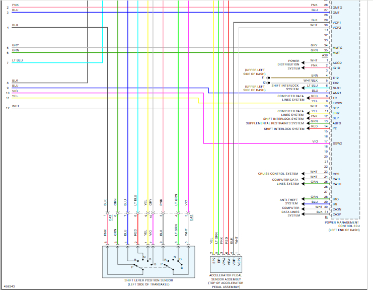

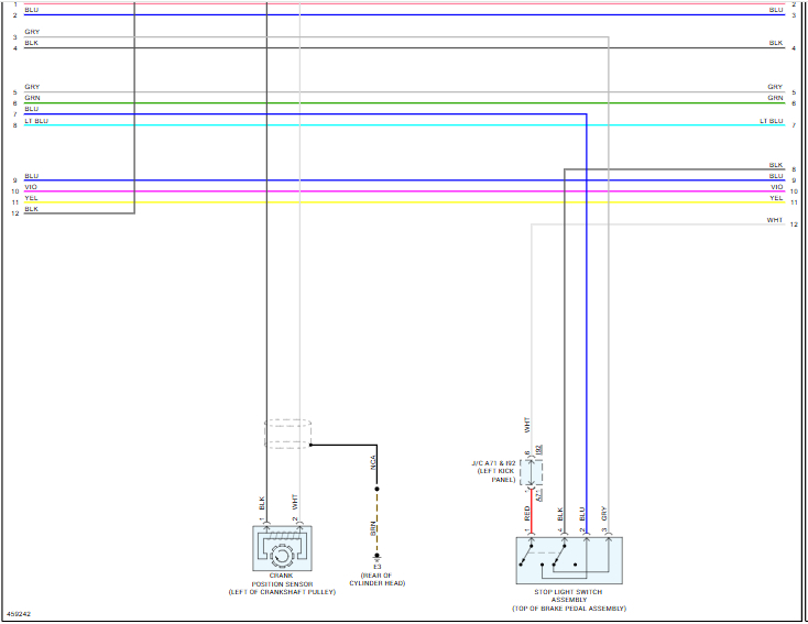

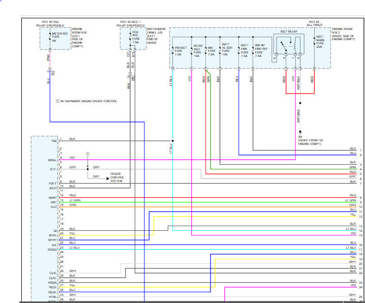

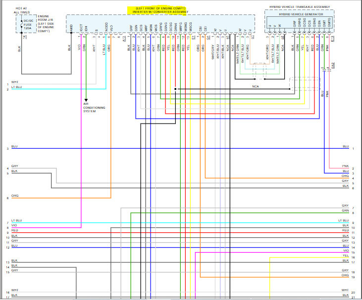

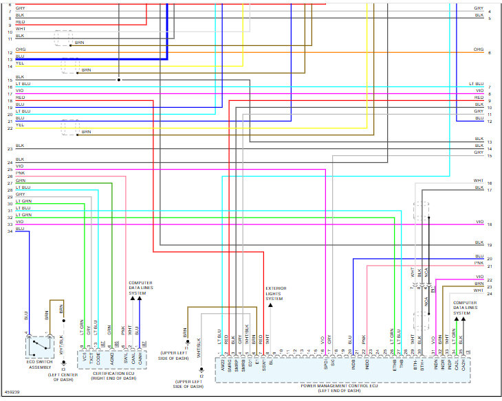

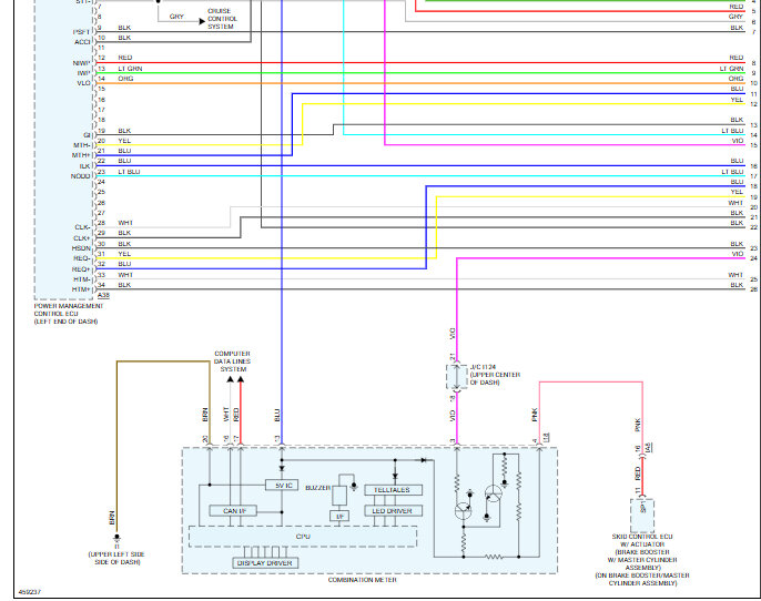

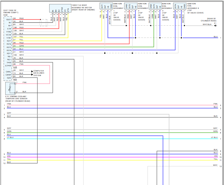

I attached the entire powertrain management schematic for you. Note that it was 7 pages long. I had to cut each one in half to make them readable, but I did overlap them so you can follow from one to the next.
I hope this helps. Let us know if you have other questions.
See pics below
Nov 28, 2025 at 10:37 AM
MALLYBOY
  • 329 POSTS
I have resolved this problem by replacing the battery block1.
Thanks for support
May 31, 2026 at 12:52 PM
  • 55,433 POSTS
Battery block 1 is the hybrid battery correct?
