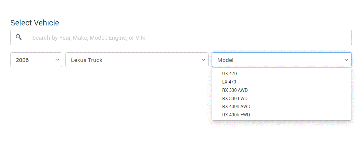

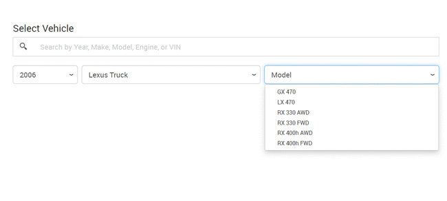

First, for some reason, I am not seeing the RX350 in my manual. See pic 1 for what I'm seeing. However, I'll try my best to help.

The year is correct, but the model is Lexus RX330. sorry for the inconveniences.
Dec 24, 2020 at 1:44 AM
  • 110,244 POSTS
Okay, that helps. And no problem. Interestingly, they made a 350, so I was a bit confused. LOL Regardless, if you are certain the pressures are good, we need to start by testing the low-pressure switch. Here are the directions for testing. The attached pics correlate with the directions.

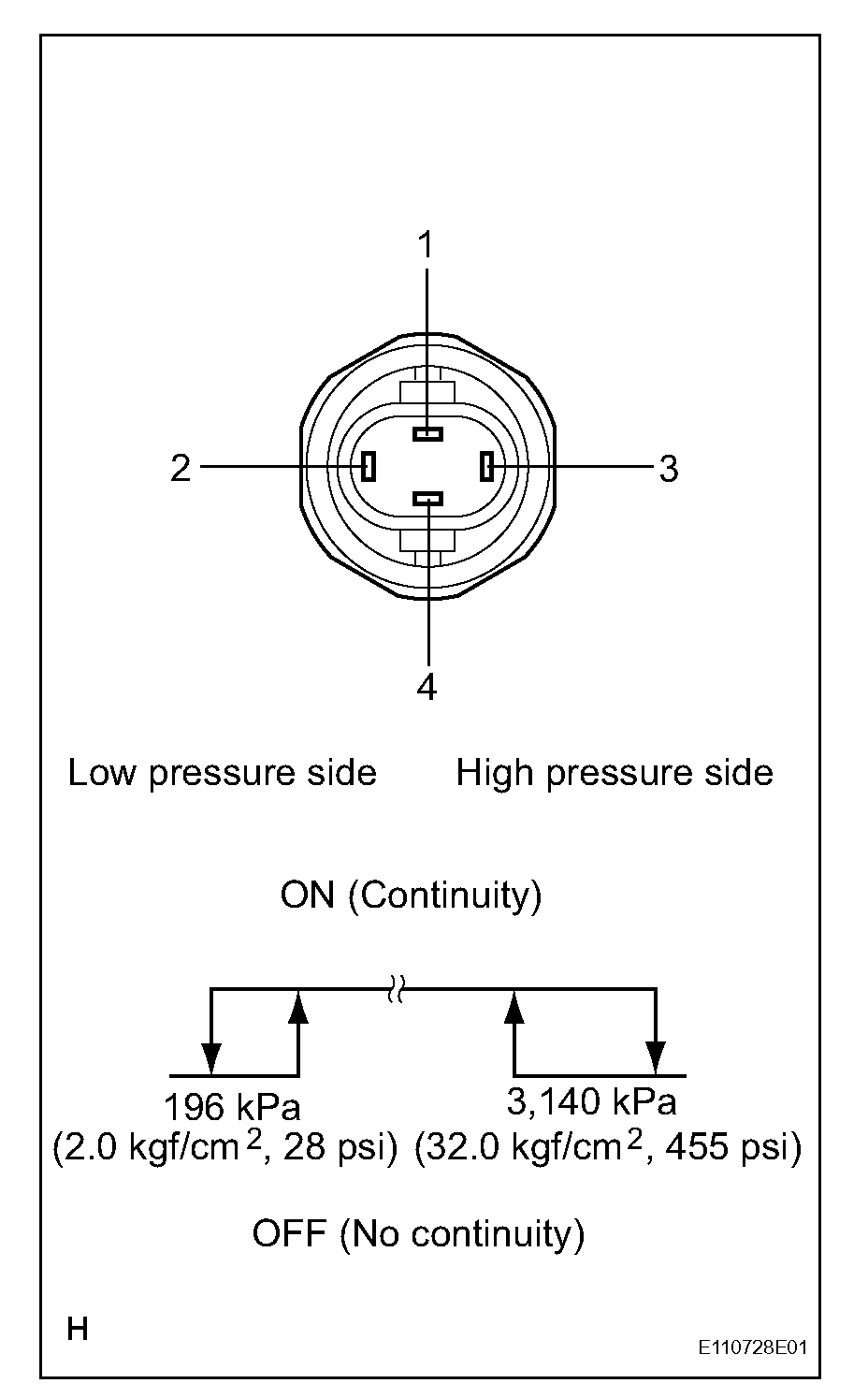

INSPECT A/C PRESSURE SWITCH
pic 1
a. Low and high pressure cut side:
Inspect pressure switch operation.
1. Set the manifold gauge.
2. Connect the positive (+) lead from the ohmmeter to terminal 4 and the negative (-) lead to terminal 1.
3. Check continuity between the terminals when refrigerant pressure is changed, as shown in the illustration.
If operation is not as specified, replace the liquid tube sub-assembly.

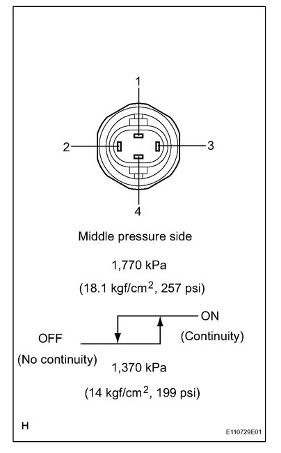

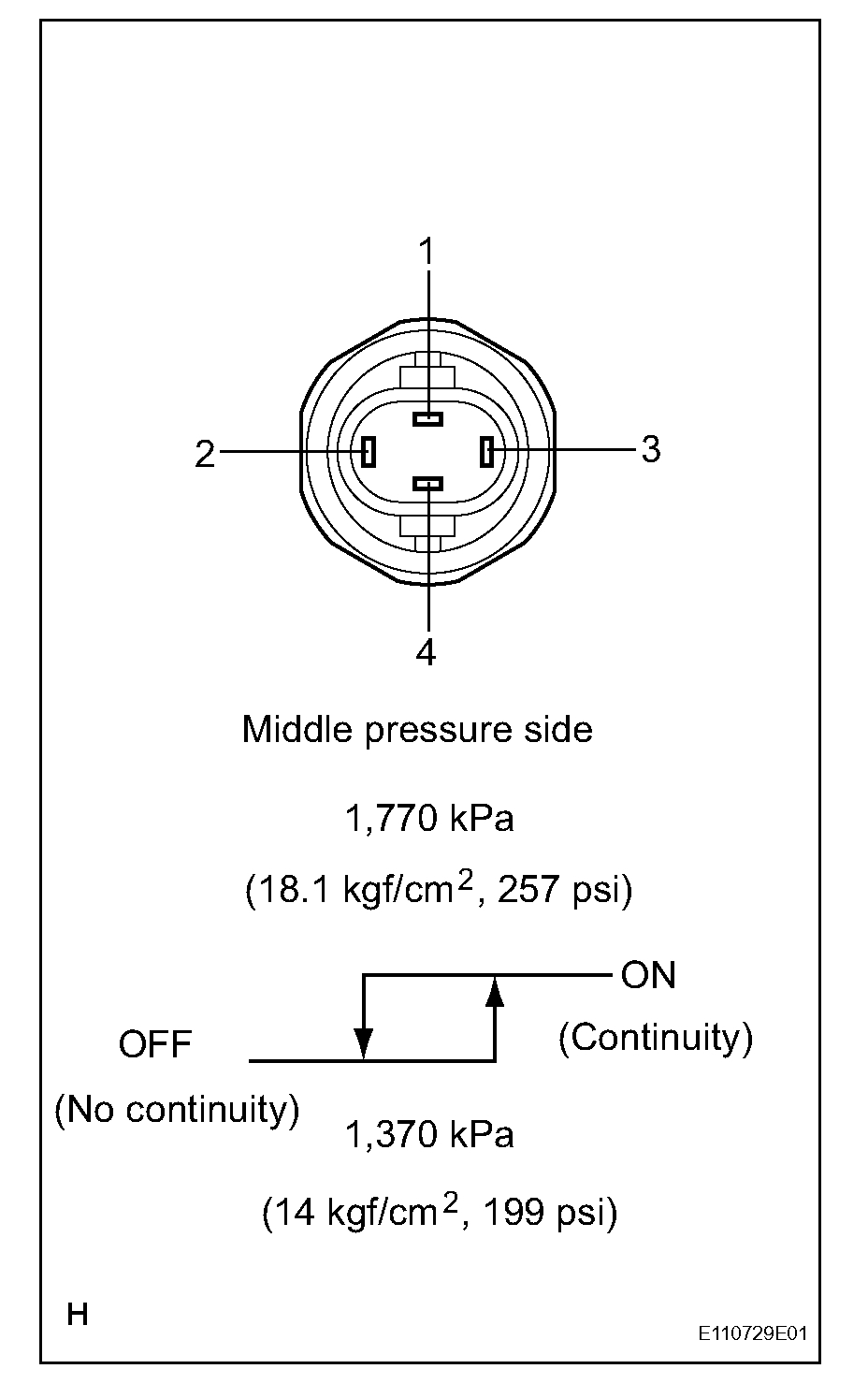

b. Middle pressure cut side:
2. Connect the positive (+) lead from the ohmmeter to terminal 2 and the negative (-) lead to terminal 3.
If operation is not specified, replace the liquid tube sub-assembly A.
