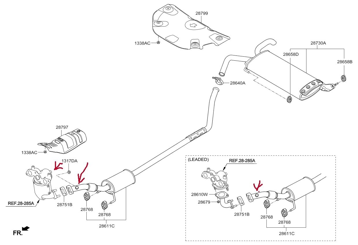

The vehicle burns black smoke
2012 KIA PICANTO
102,567 MILES • 1.0L • 2WD • MANUAL
MALLYBOY
  • 329 POSTS
This vehicle started this problem after the exhaust system was repaired and it happened that the technician cutoff the exhaust pipe o2 sensor location together with the sensor. When I diagnose, I didn't see the fault code on the O2 sensor, I used live data to read the parameter and it showed not supported by vehicle, at this point I check and notice the sensor was not there. Please I need the complete exhaust diagram to see the sensor location and I will put it back. thanks

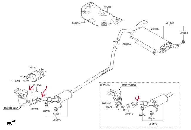

Try this one: Black smoke is usually running very rich and can cause a converter failure if equipped. This shows both versions of that system, one for unleaded ethanol and one for other fuels. The arrows point to where the O2 sensors should be.
