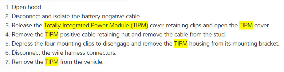

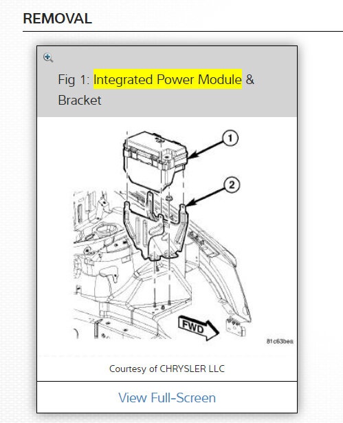

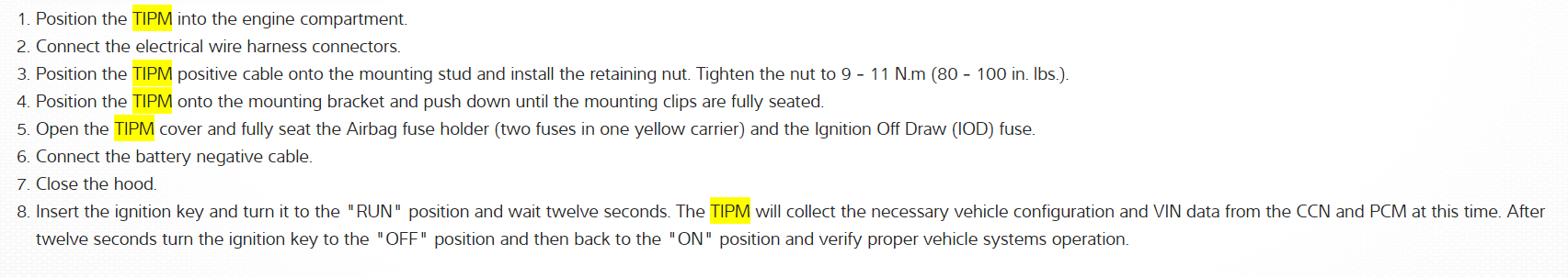

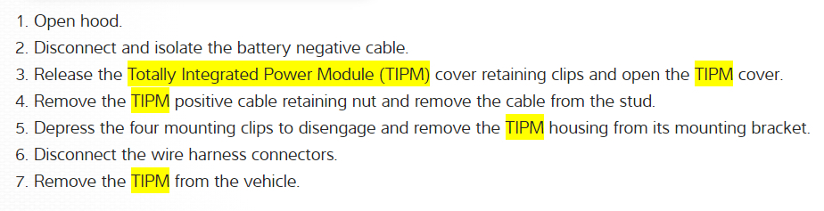

It sounds like the TIPM is going out or it needs to be reprogrammed, but to be sure we can do a CAN scan which is easy. You can get a CAN scanner (Controller Area Network) which will work on most cars from Amazon.
https://youtu.be/u-4syLc-ifQ
and
Here is the location of the TIPM, it is easy to replace because it-self learns. Check out the images (below). Please let us know what happens.
