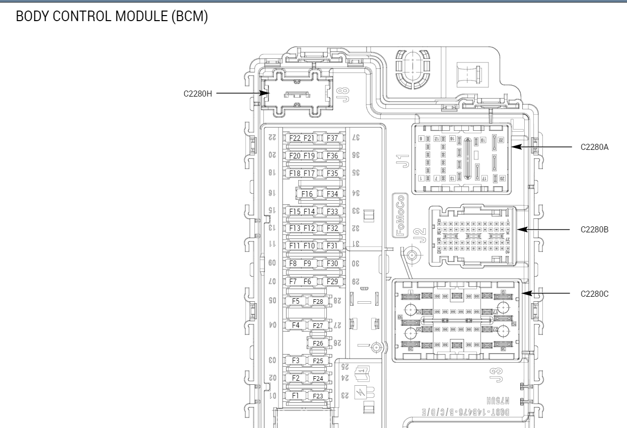

After connecting jumper cables incorrectly, the traction control light is on, and the Power Steering is not working?
2018 FORD MUSTANG
69,000 MILES • 2WD • AUTOMATIC
PHRON

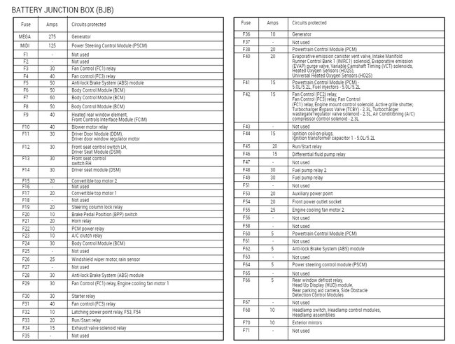

I connected the jumper cables wrong on my car listed above Eco boot and now my power steering isn't working correctly.
Mar 13, 2023 at 4:16 PM
  • 54,840 POSTS

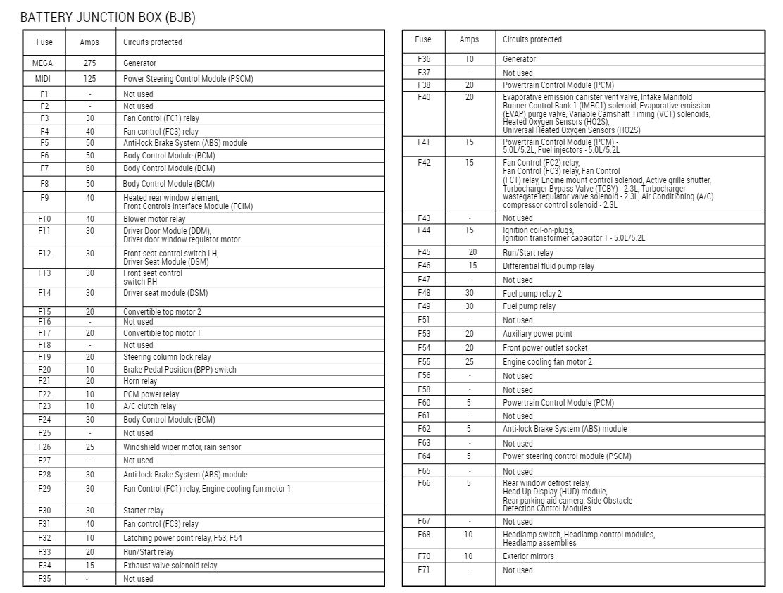

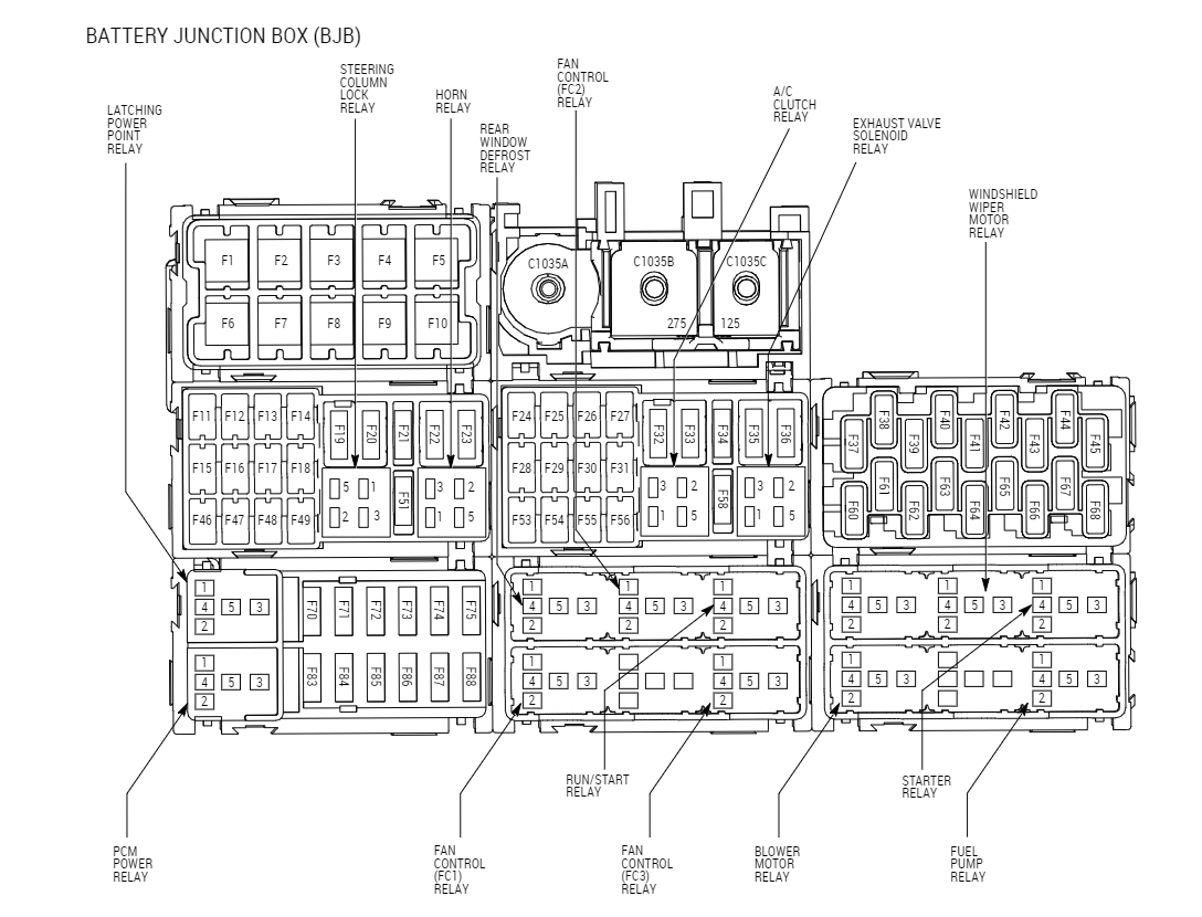

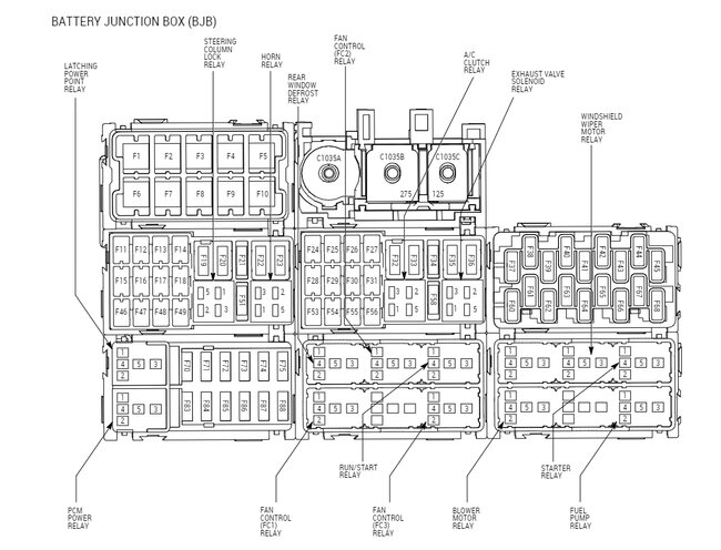

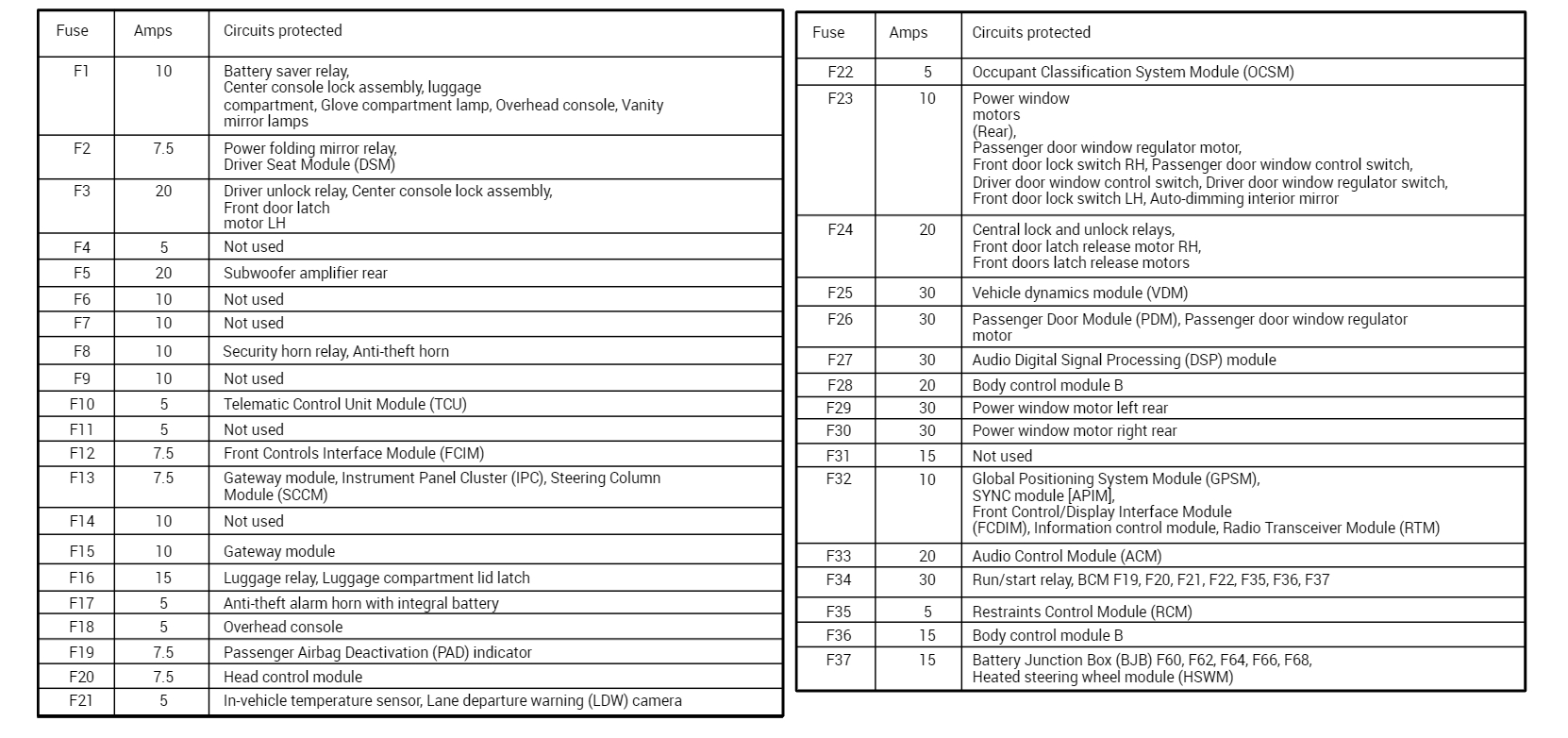

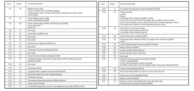

Yep, it happens, the first thing we need to do is check the fuses with the ignition system on, here is a guide to help and the fuse locations was well in the images below.
Mar 14, 2023 at 12:10 PM
PHRON
Okay, will do and thank you!
