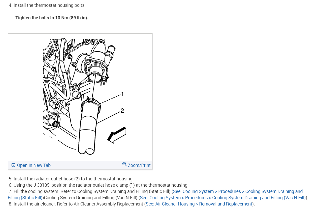

How to replace the thermostat?

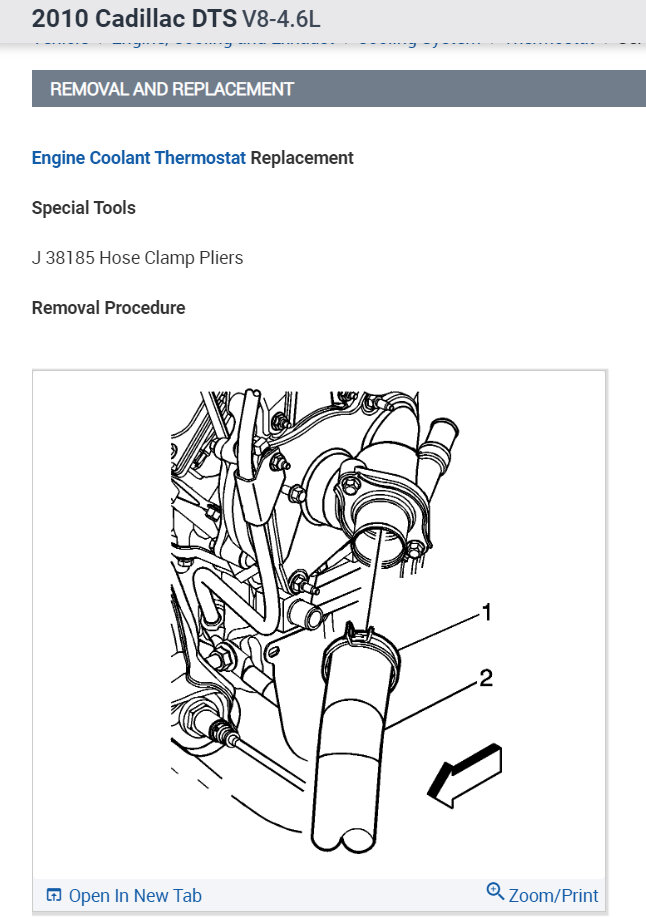

When I set the heater at 90 degrees it blows cold air and fogs up the windshield. How to replace the thermostat?
Mar 2, 2023 at 8:25 AM
  • 55,562 POSTS

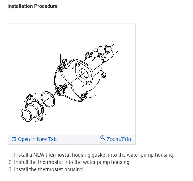

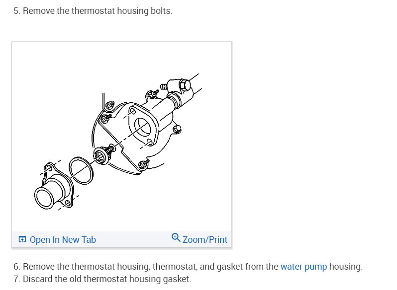

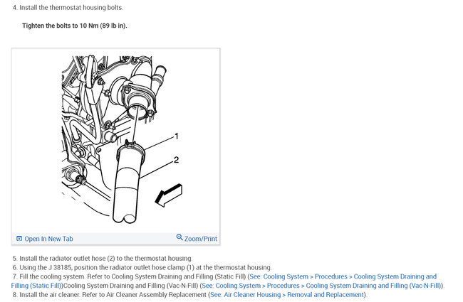

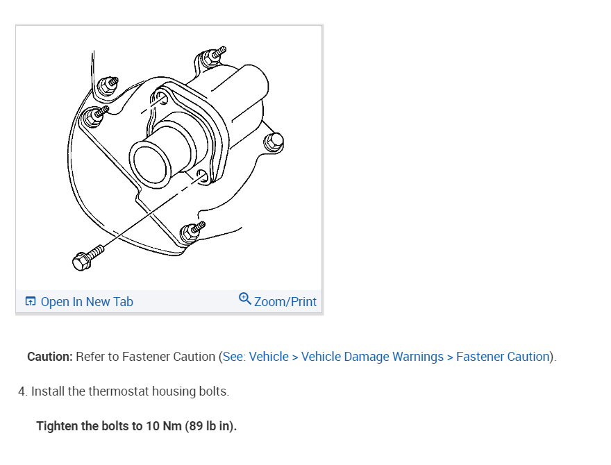

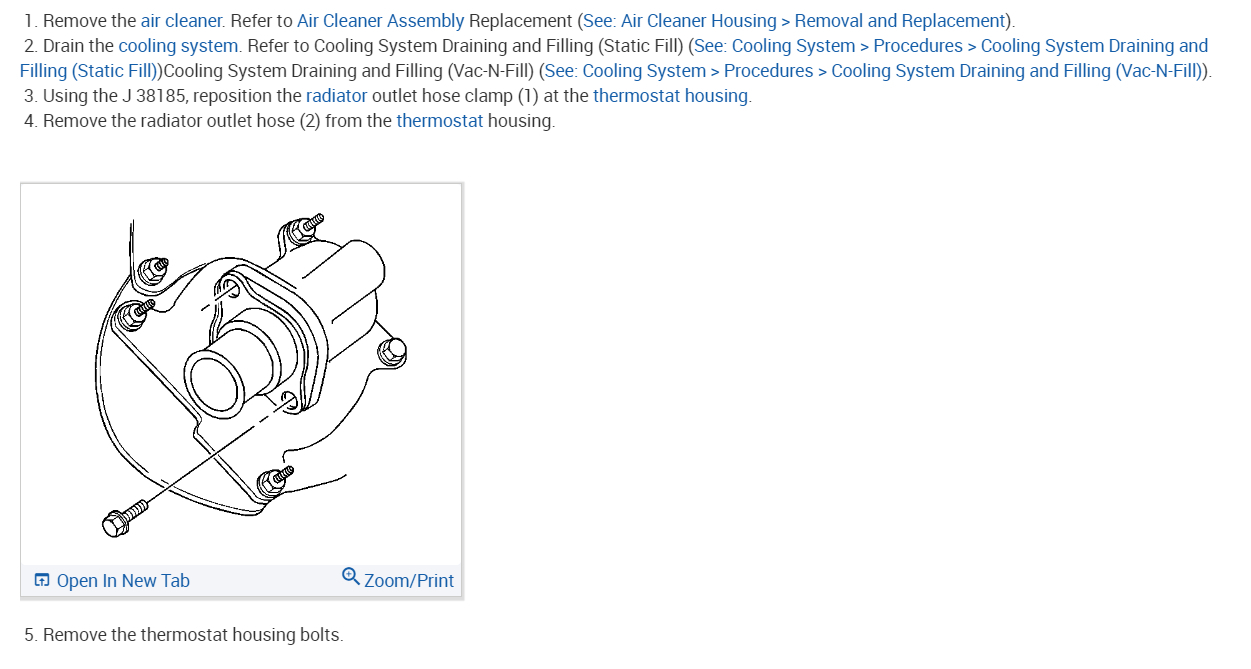

Here is a generic guide to help walk you through the steps of replacing the thermostat and I have included the instructions for your car in the images below.
Check out the images (below). Please let us know if you need anything else to get the problem fixed.
