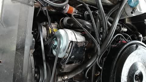

So when the car is started it only takes the engine doesn't turn at all and something is smoking and it smells like melting rubber and plastic at the same time really terrible.
My husband wanted me to send this video so I'm going to attach a video.

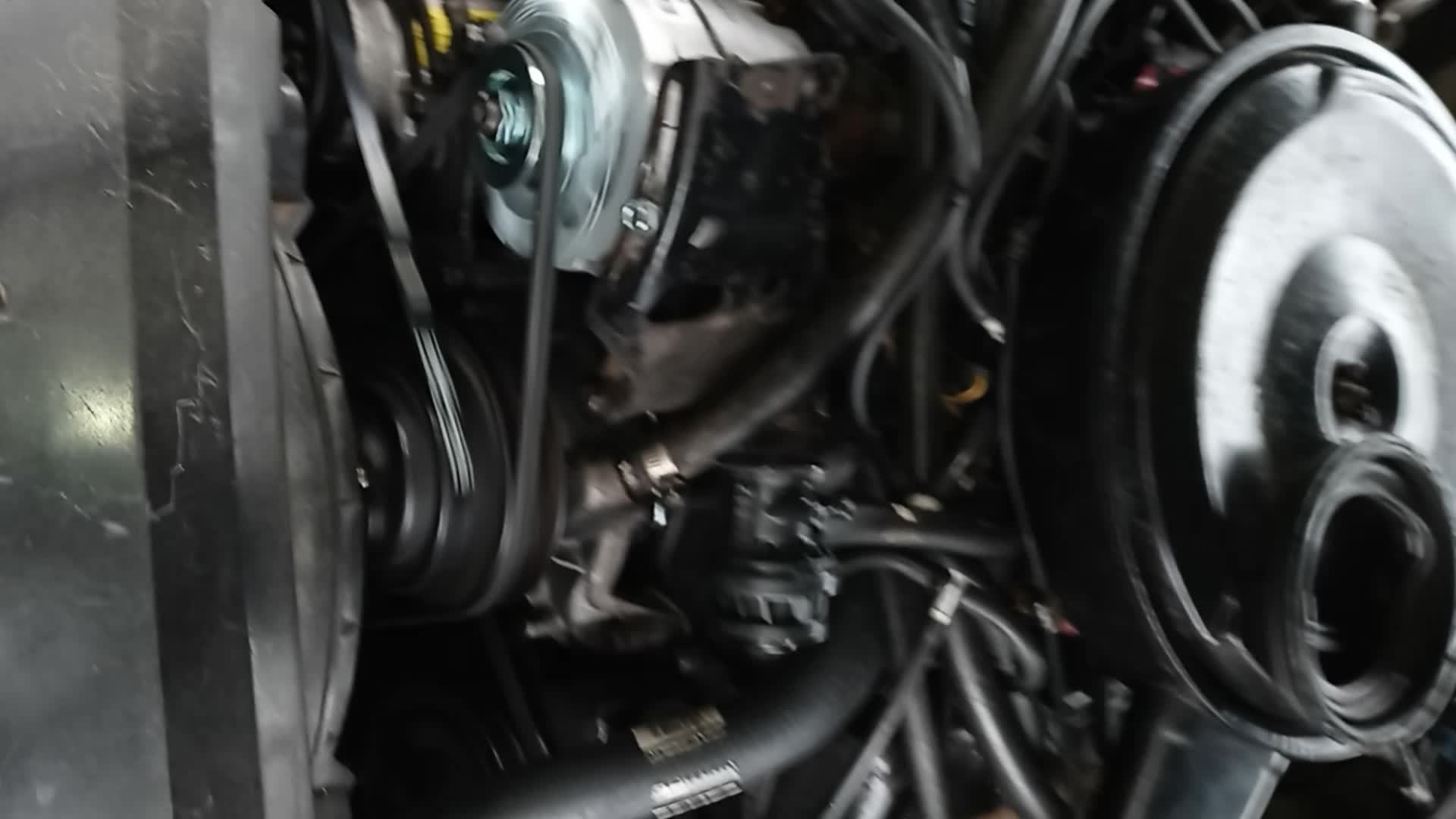

The video didn't attach. Is the smoke coming from under the hood? Have you checked the accessory drive belts to make sure one isn't getting burned up due to a pulley being locked up?
Here is a link that shows how to replace a serpentine belt. I'm adding it in the event you find the belt is loose, damaged, or burnt.
If you can, upload the video you mentioned. Also, open the hood and then have a helper start the vehicle so you can see approximately where the smoke comes from.

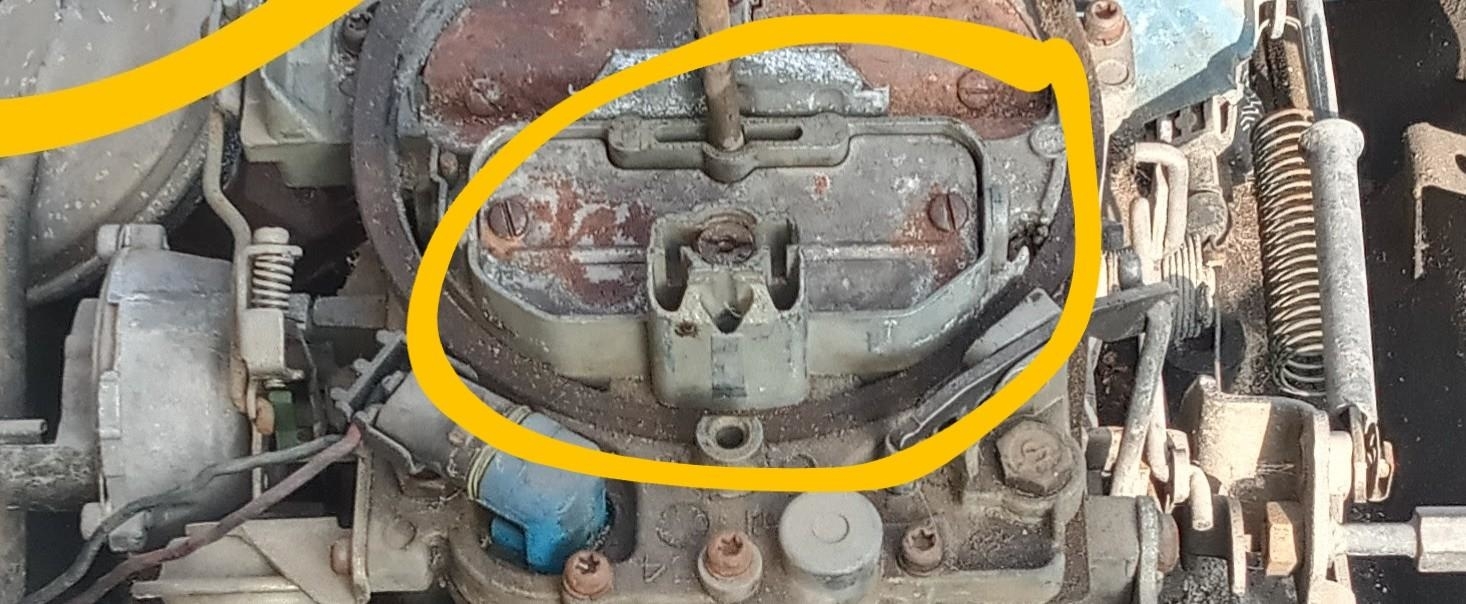

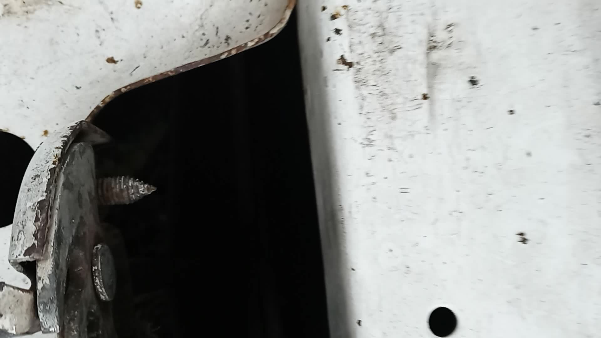

I believe this is the video it's no longer smoking. He changed the starter but now the car's starter is making a grinding noise. He also wants to know what's the screw on top of the carburetor?And how to adjust it?

This one is the correct video.

I may have seen a small amount of smoke near the passenger side of the firewall. Is that what you are referring to?
If it is, I suspect it is coming from the starter or a wire at the starter. If you crank it for an extended period of time, it will get really hot. Check to see if that's where it is coming from. Remember, it could be the wiring to the starter as well.
I need to see a pic of the screw you are referring to. If I recall, there really aren't any adjustments on the top. The air/fuel mixtures are usually at the base of the carburetor.

I tried putting a vacuum gauge on it for tuning but the engine was idling to high at high speed as I was trying to back it up to its highest vacuum pressure by turning the adjusting screw to the left
The vacuum pressure wouldn't back up still so I proceeded to the other adjusting screw
As I was told to turn them in all the way the darn screw came out I manage to screw it back in lucky it didn't show signs of internal problems after getting the screw back in I gave up
Then I studied and learned that we're trying to get the highest pressure on both screws but as I turn the screws while backing them up the pressure still wouldn't back up it would stay at 10.

MYPONTIAC84
  • 11 POSTS
This is the screw he is talking about in the attached image.

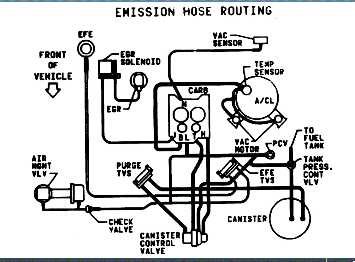

  • 109,885 POSTS

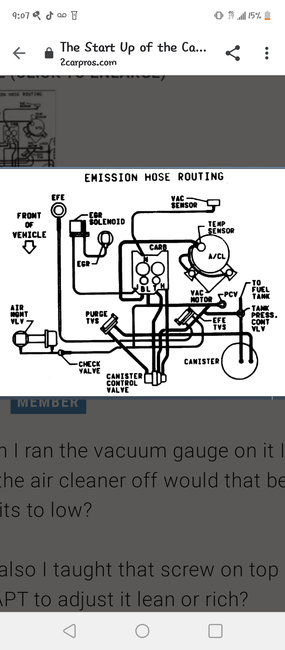

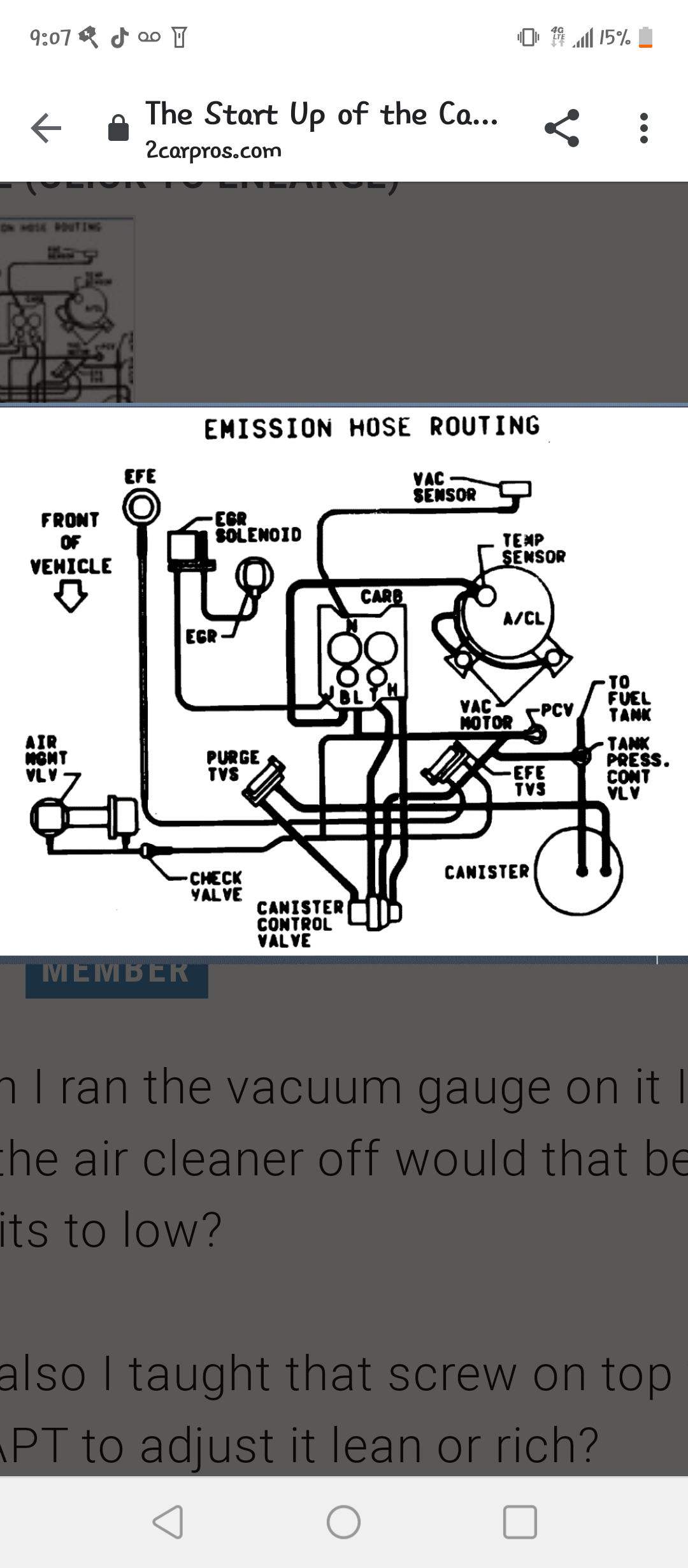

If you are showing 10 on vacuum, that is too low. Are you sure there isn't a vacuum leak? It should be between 18 and 22.
As far as the screw, that isn't an adjustment.
Take a look at the attached schematic and let me know if it is the same as what was used.
Tuesday, February 16th, 2021 AT 2:31 PM

When I ran the vacuum gauge on it I had the air cleaner off. Would that be why it's too low?
Also, I thought that screw on top was the APT to adjust it lean or rich?

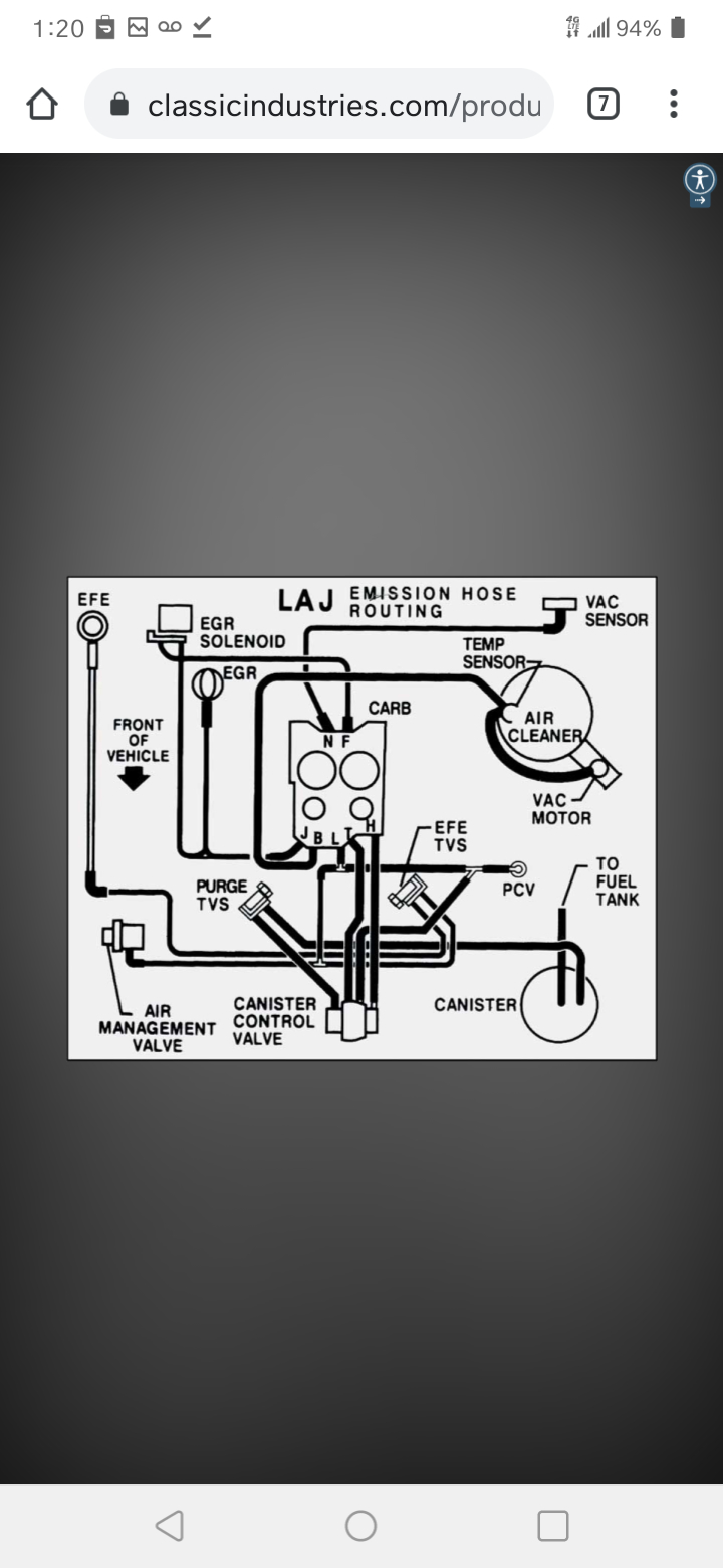

I didn't run the vacuum lines like that schematic you are sharing with me. I'll send you a picture of the one I used.

This is my picture I don't know if it's the same.

  • 109,885 POSTS
Without having the pictures side by side, it's hard to tell. However, the one I supplied appears to have more information. What I would do is go to the vehicle and start tracing to see if there is a difference.

  • 109,885 POSTS
LOL no, you did add it. I suggested that you follow the pic I sent to confirm what you have is correct. The one I sent seems to be more specific.
