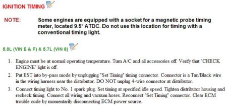

Hello.
Could you explain me the procedure to follow, to set ignition timing on a 1988 Trans Am V8 5.0L TPI.

Hello and thanks for the donation!
To help me better assist you with this, could you please specify your 8th digit of the VIN ? Also, this is a HEI-EST (distributor equipped) ignition system correct? Not the direct style ( No distributor used) ?

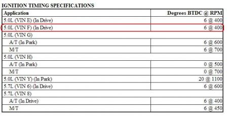

The 8th digit is a "F". This is a HEI distributor for a TPI (no vaccum advance).
Thank you for your help.

Thanks for that information..below are details for adjusting your vehicle's ignition timing along with the timing specs..
https://images.2carpros.com/forum/automotive_pictures/261618_Noname_722.jpg
https://images.2carpros.com/forum/automotive_pictures/261618_Noname2_188.jpg
