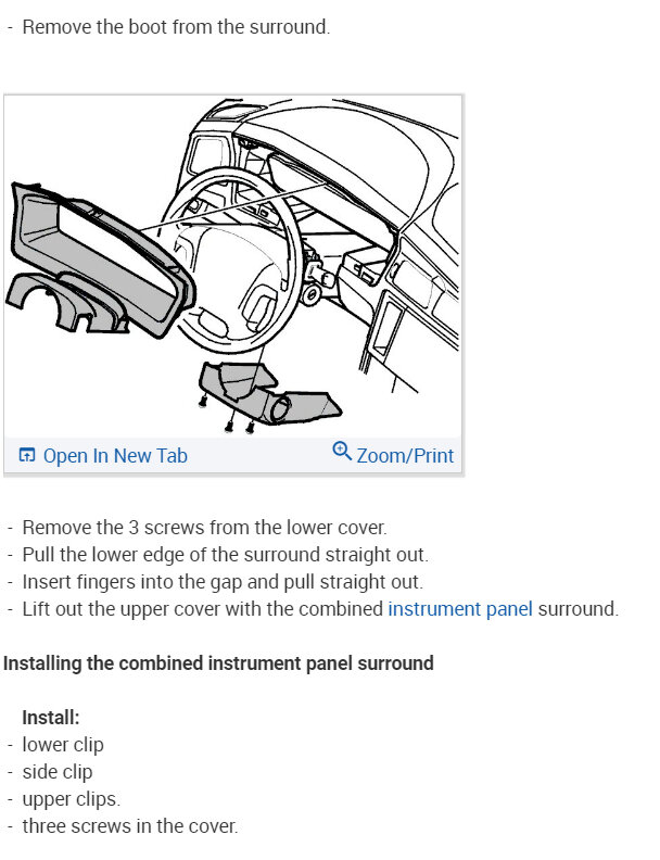

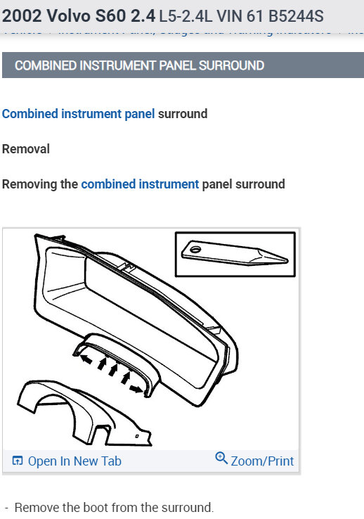

So, I would start by checking the fuses this guide can help:

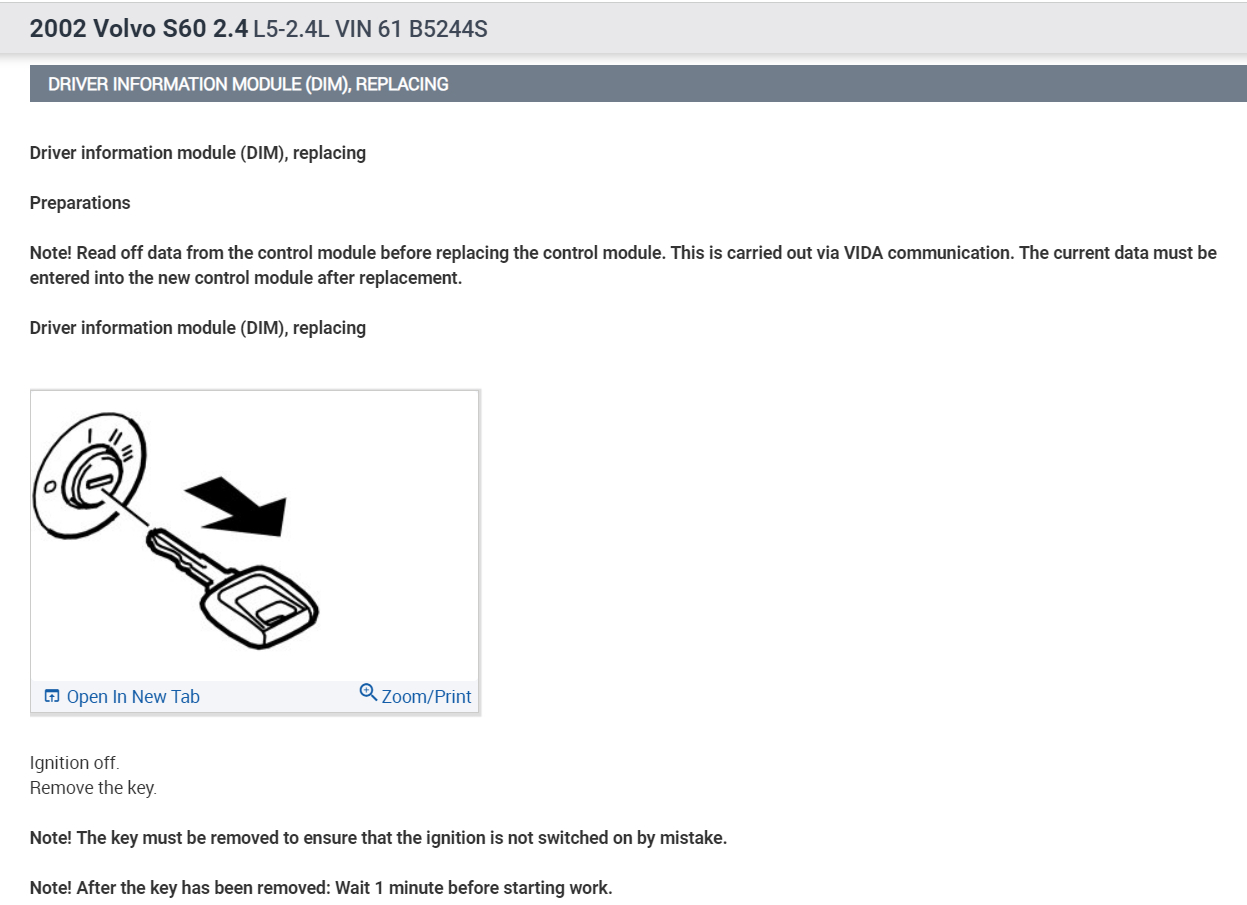

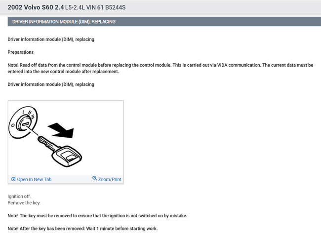

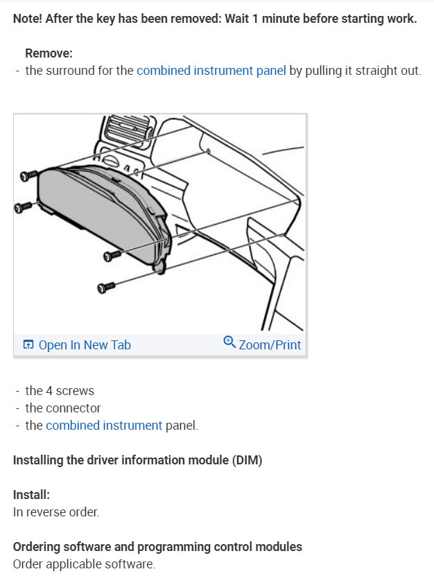

If the fuses are good chances are the IPC (DIM) has gone bad, here is how to change it out in case you need it. Check out the images (below). Let us know what happens and please upload pictures or videos of the problem so we can see what's going on.

From the description, it was referring to communication line faulty, there are no communication between those modules. The DIM was replaced with a used one and I used scanner to actuate the gauges, lights and warning lights and it all worked. Then I reset the fault code and cycle ignition twice and rescan and the code appears back before I decided to check the communication line first before any other thing. Does it need to be programmed when replaced?
Aug 16, 2023 at 12:36 AM
  • 54,837 POSTS
Yes, it does need to be programmed.
