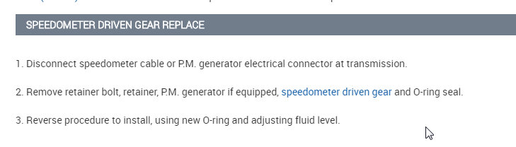

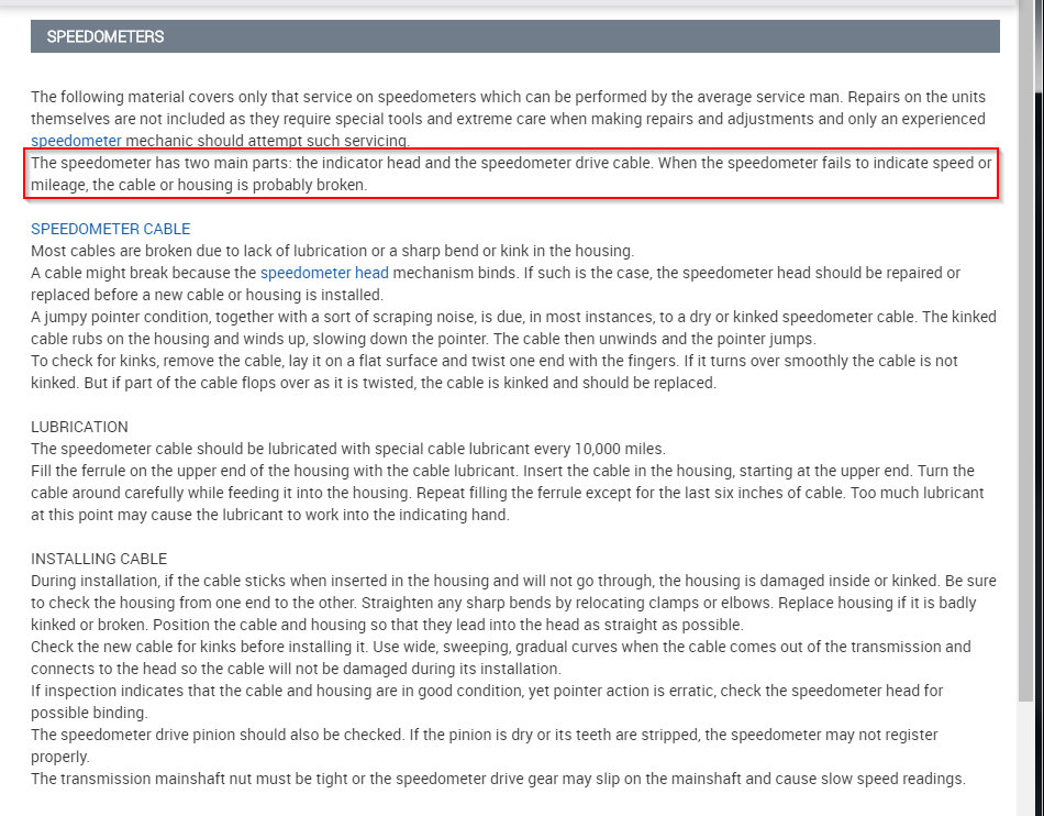

Just to clarify, is the speedometer the only thing that doesn't work at times? Also, when the speedometer is not working do the lights not work at the same time? In other words, do the speedometer and lights work at the same time and not work at the same time or different?
I attached the info for the speedometer but depending on the answers to this it may not be the cable or housing issue and the lights may be a different issue.
Let me know and we can go from there. Thanks

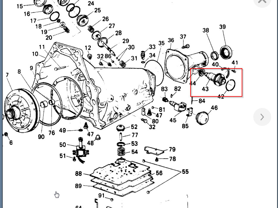

You are correct. However the idea is the same. Take a look at the tail shaft pictures attached, to see if the driven gear has an electrical connector on it. If it does then the gear is driven by the output shaft and this PM generator sends a signal to the cluster that translates that into a MPH reading. I would check for voltage coming out of that gear and if you have it then we need to go to the back of the cluster and see if the signal is getting there. The fact that it is intermittent it may just be a connector issue at the gear or the cluster. The lighting on the cluster may indicate an issue at the cluster but this is where we need to start.
