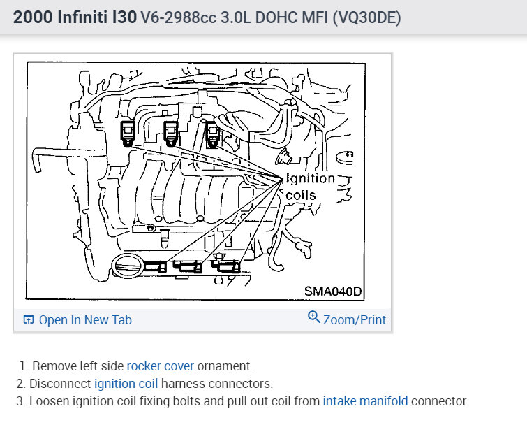

So, it sounds like the #6 ignition coil is shorted I would swap it out for a new one. This code pertains to the PCM side of the circuit.
The OBD-II trouble code P1320 is a generic powertrain code that typically indicates an ignition coil or ignition-related problem in the vehicle's engine control module (ECM) or powertrain control module (PCM).
Here is the coil so you can change it out. This is a common failure. Clear the codes when completed. Check out the images (below). Please let us know if you need anything else to get the problem fixed.

I have inspected the circuits running from ECM terminal 21,22,23,30,31,32 to ignition coils and all have resistance. But I noticed that ignition #6 connector was not locking at all, if you plug it, it will not lock but shift back thereby causing an open circuit. I will change it and still crank it to see whether the spark will be steady and enable the car to start.

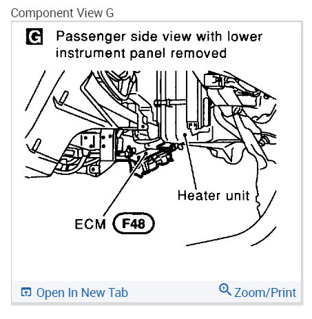

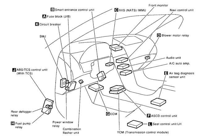

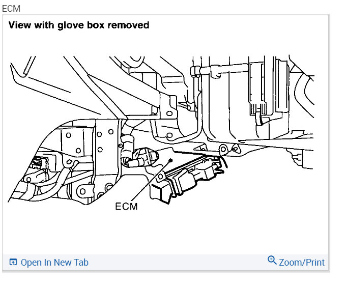

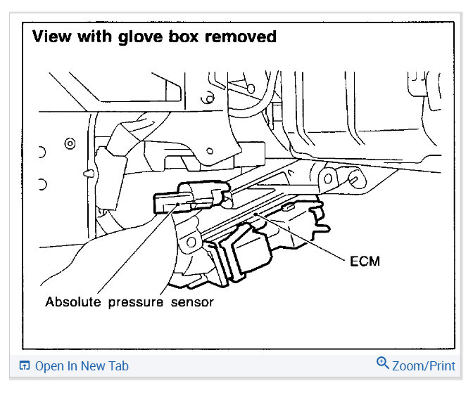

Thanks for the video. it looks like the PCM is bad or you have a bad ground to the PCM. I would re-check the harness grounds if okay you can get a preprogrammed unit by searching Google or Ebay. Here is how to change the PCM out. Check out the images (below). Please let us know what happens.
