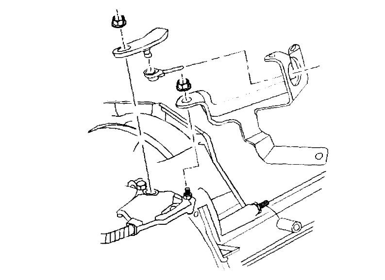

How do I replace the safety ignition switch?

Park/Neutral Position (PNP) Switch Replacement
Removal Procedure
Caution: Refer to Battery Disconnect Caution in Service Precautions.
1. Disconnect the negative battery cable.
2. Remove the shift linkage.
3. Disconnect the electrical connector.

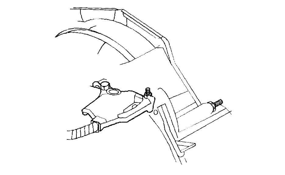

4. Remove the park/neutral position switch mounting bolts.
5. Remove the park/neutral position switch assembly.
Installation Procedure (Old Switch)
Using old Switch
1. Place the shift shaft in N (Neutral).
2. Align the flats of the shift shaft with the switch.
