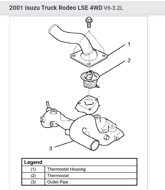

The reservoir is backing up with coolant and getting boiling hot?
2001 ISUZU RODEO
89,000 MILES
SANDRA LLOYD
Coolant is getting boiling hot, thermostat?
Feb 23, 2023 at 4:24 AM
  • 110,244 POSTS
The thermostat would be the first thing I replaced. However, when I would have it apart, I would take the opportunity to flush the cooling system at the same time. That way, you don't waste coolant.
Here is a link that explains how to flush the system:
https://www.2carpros.com/articles/coolant-flush-and-refill-all-cars

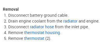

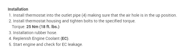

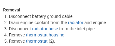

If you look below, I attached the directions for replacing the thermostat specific to this vehicle. I assume this vehicle has a 3.2L V6. If that is wrong, let me know.
take care,
See pics below. Also, make sure to check hoses to make sure they are in good condition.
