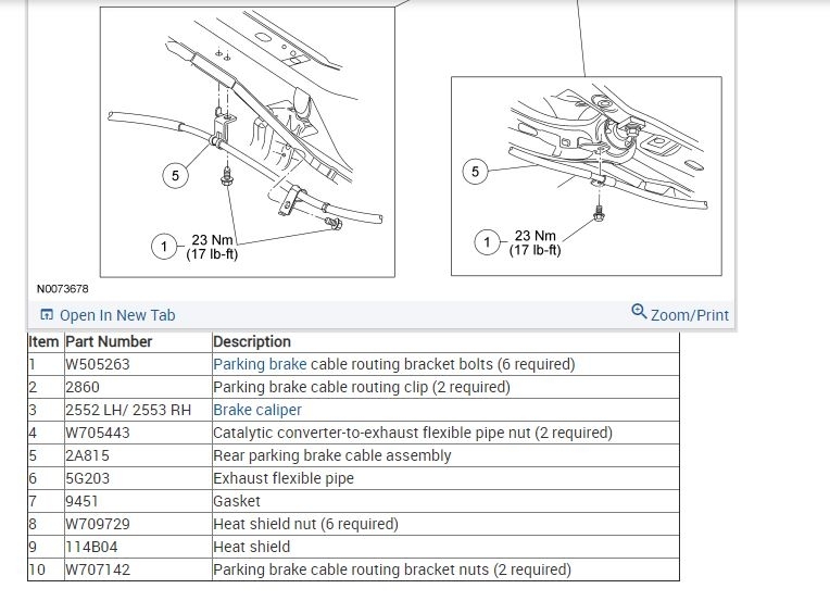

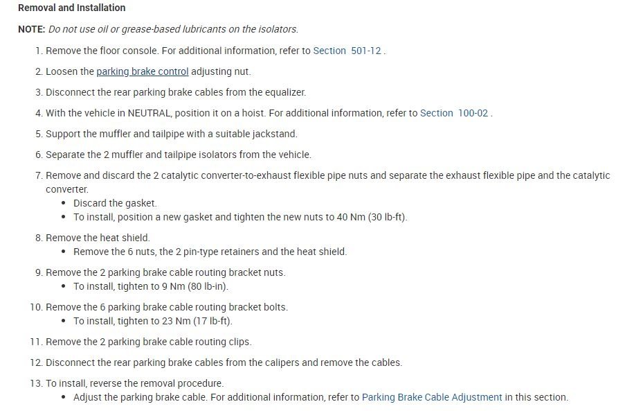

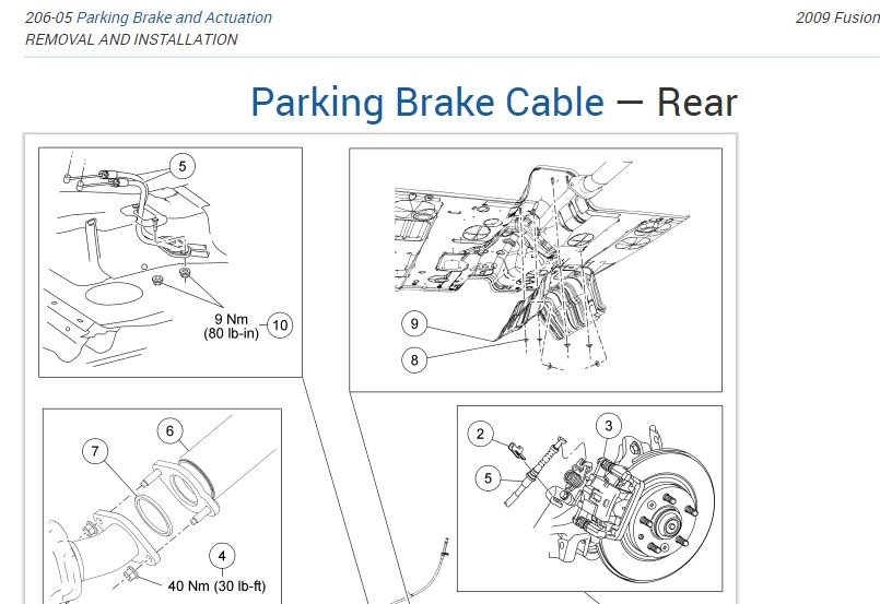

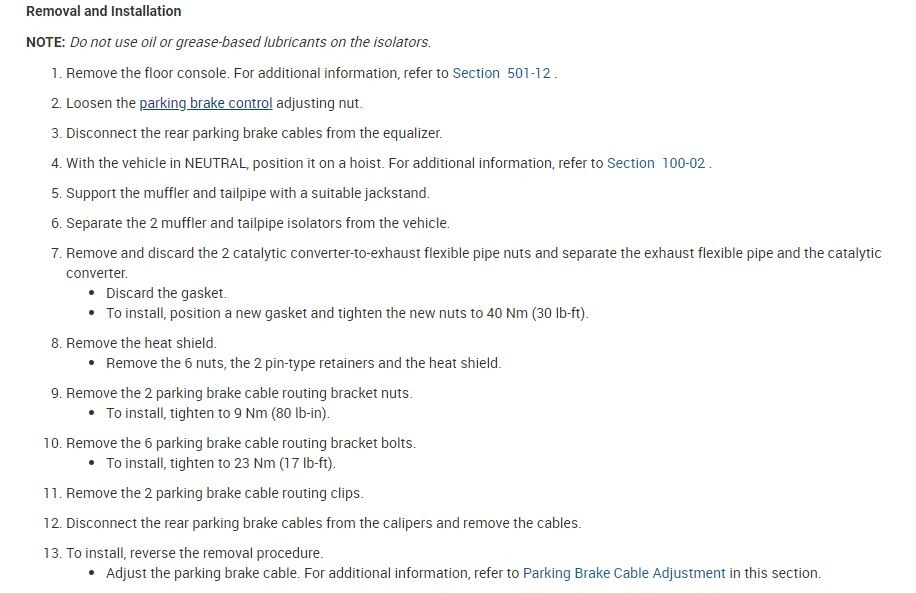

Are you sure the hand brake or emergency brake is not applied? It sounds like it is not released.
https://www.2carpros.com/articles/parking-brake-shoe-replacement
I attached pictures and procedures below for the parking brake system.

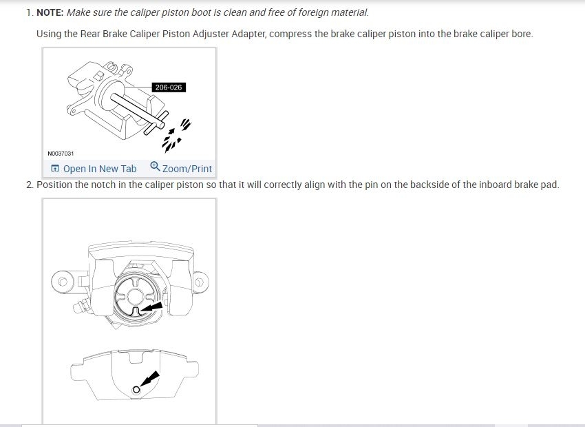

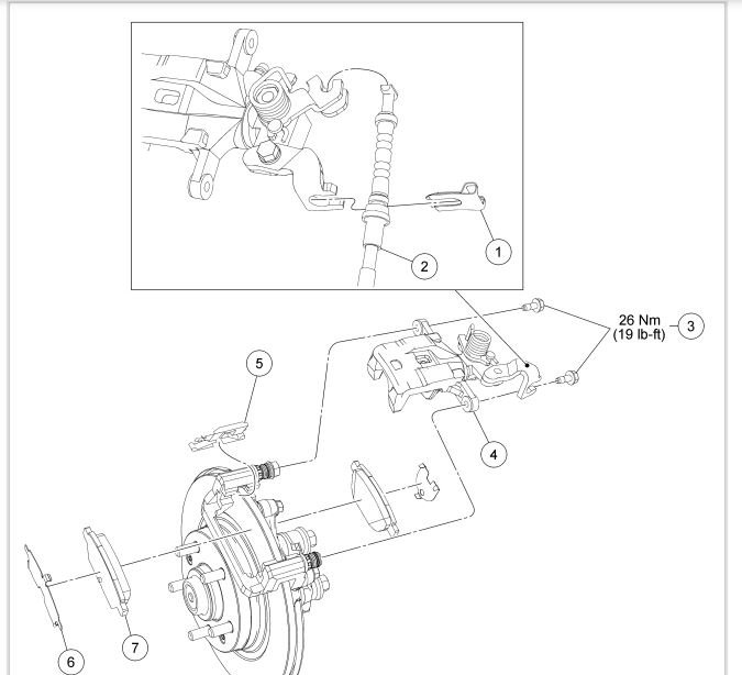

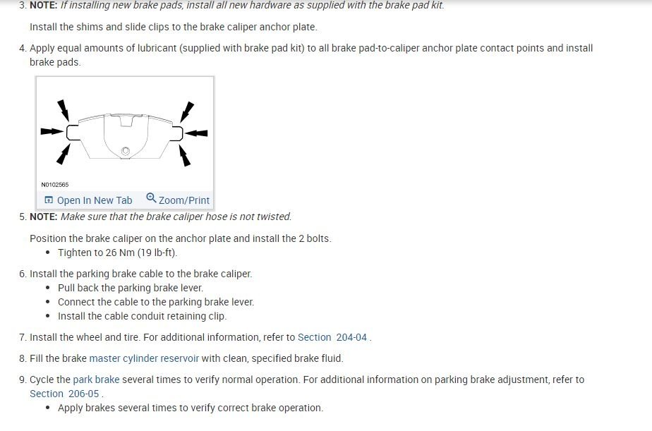

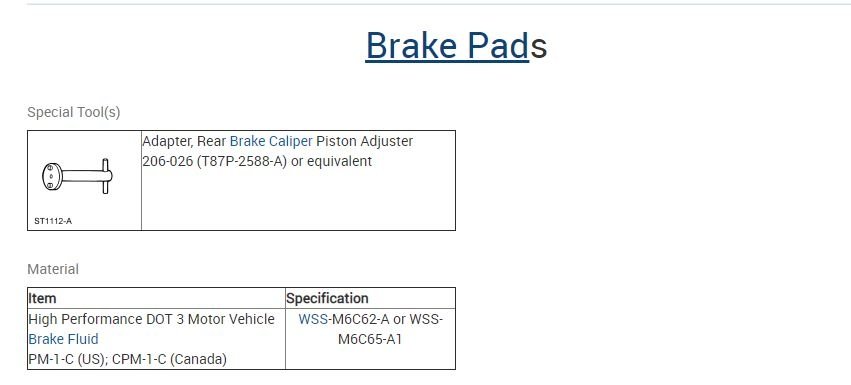

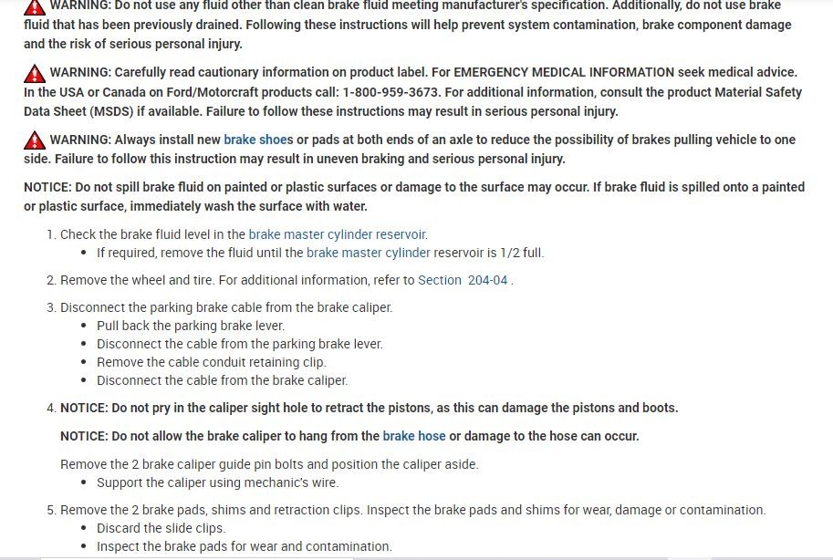

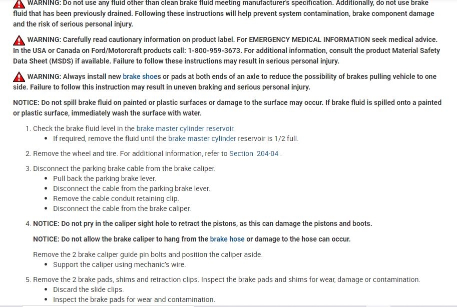

Okay, then most likely the rear shoes being metal on metal are causing the issue. You will need to replace the shoes and drums.
https://www.2carpros.com/articles/how-to-replace-rear-brake-pads-and-rotors
I attached the procedure both in a guide and pictures below for you for the replacement.
