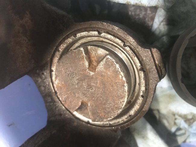

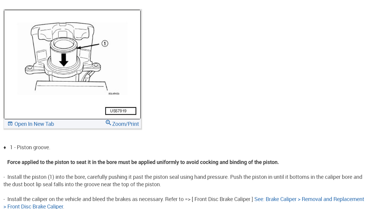

Yes, the simple way for this problem is totally change two rear brake calipers. But I tried to rebuild it first, the caliper got stuck and moved difficult, I tried to fully open it and clean inside the caliper, the dust boot broke when open the caliper.

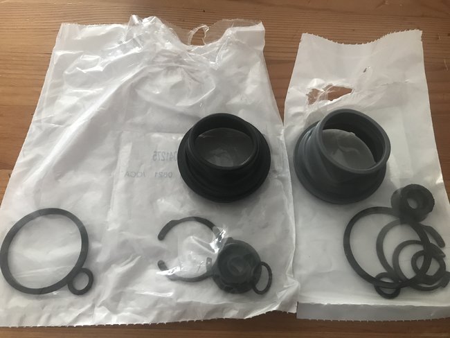

I have bought 3 caliper repair kit, but all the size can't match.
Pic1: the dust boot in the picture

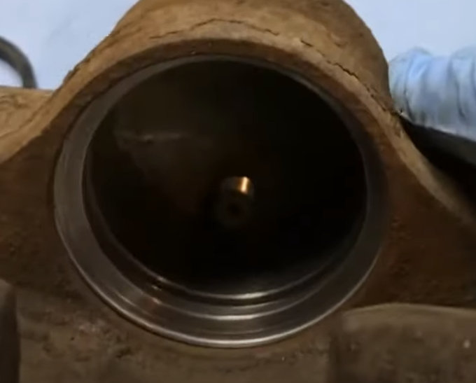

Pic2: the general caliper piston part picture, the open hole is a simple circle

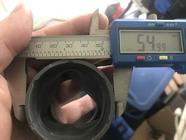

Pic3 my caliper, the piston open hole is special two edge
pic4 the caliper repair kit
The original dust boot is a soft base ring, locked in the open hole second edge, I don't have the photo, but the repair it is a hard base rubber ring, someone said there is a steel ring inside the rubber
The piston first inner diameter is 51mm.
The piston second outer diameter is 55mm.
The rubber dust inside diameter is 50mm.
The rubber dust outside diameter is 55mm, see the pic 5.
It looks like I can't install this, any idea?
The rubber only press the outside diameter to 51mm or extend the inside diameter to 55mm, otherwise I can't install it back, but there is steel ring inside the rubber, I can't change the size like this.

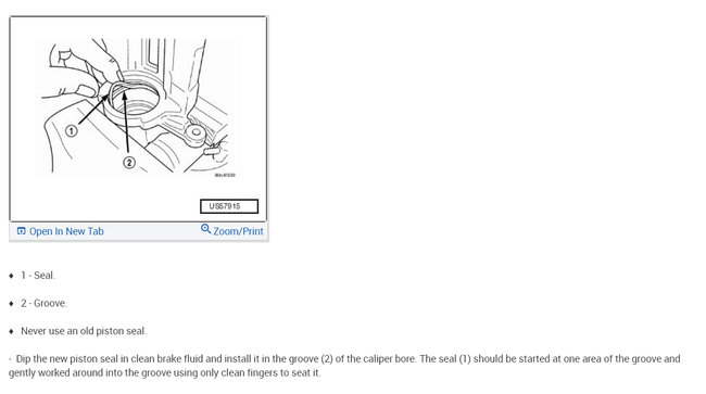

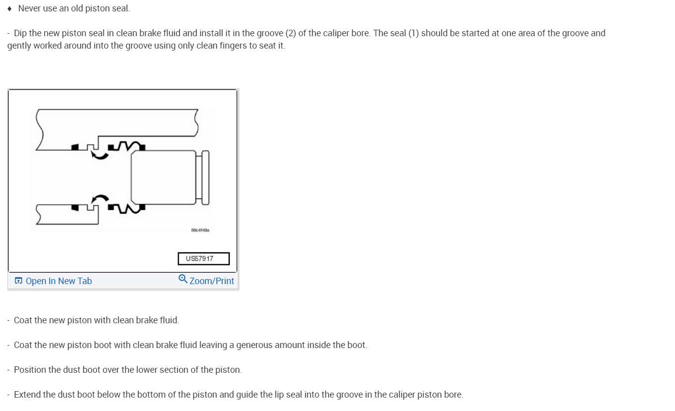

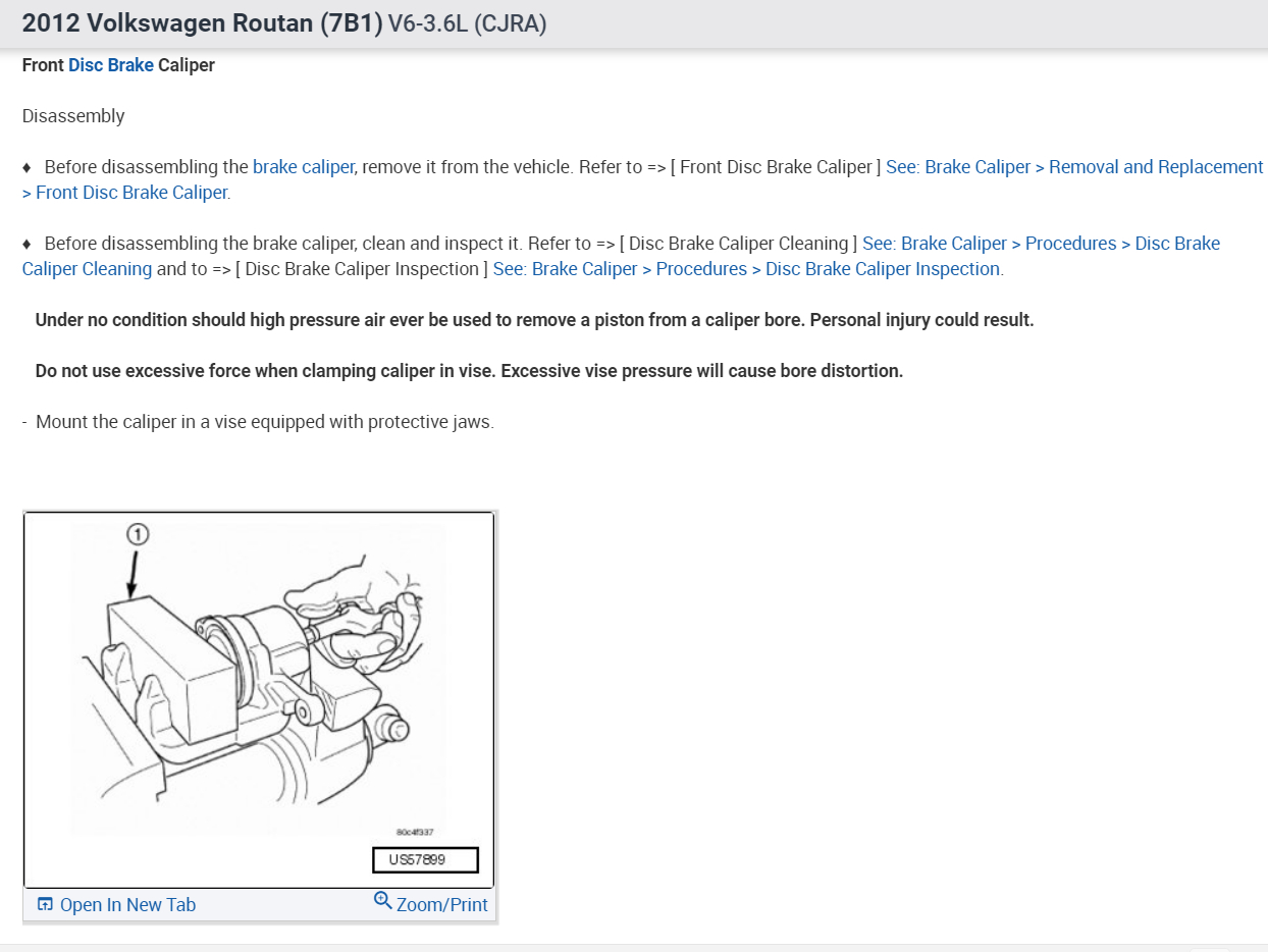

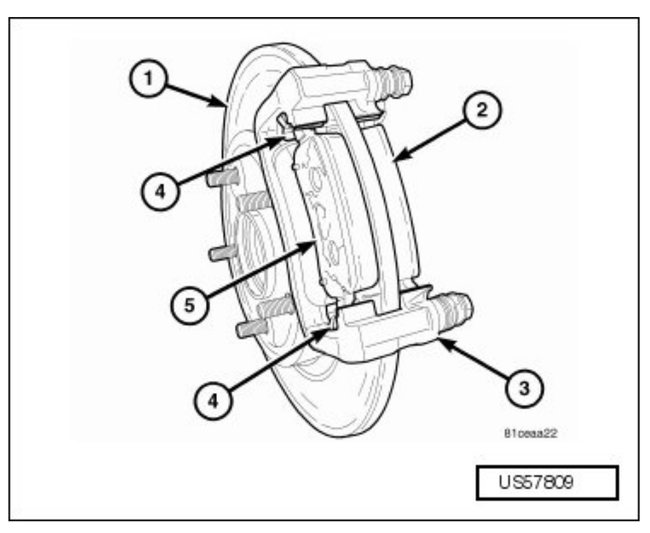

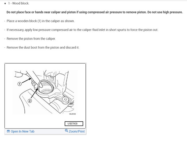

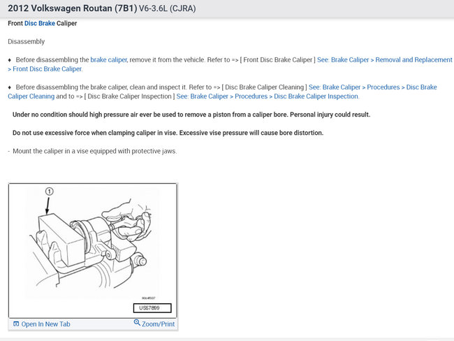

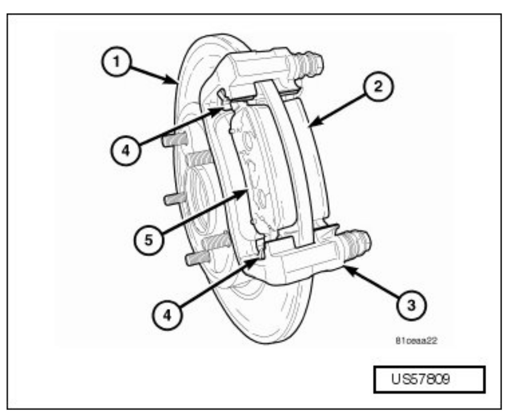

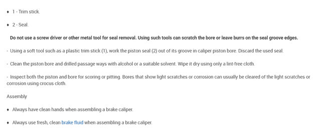

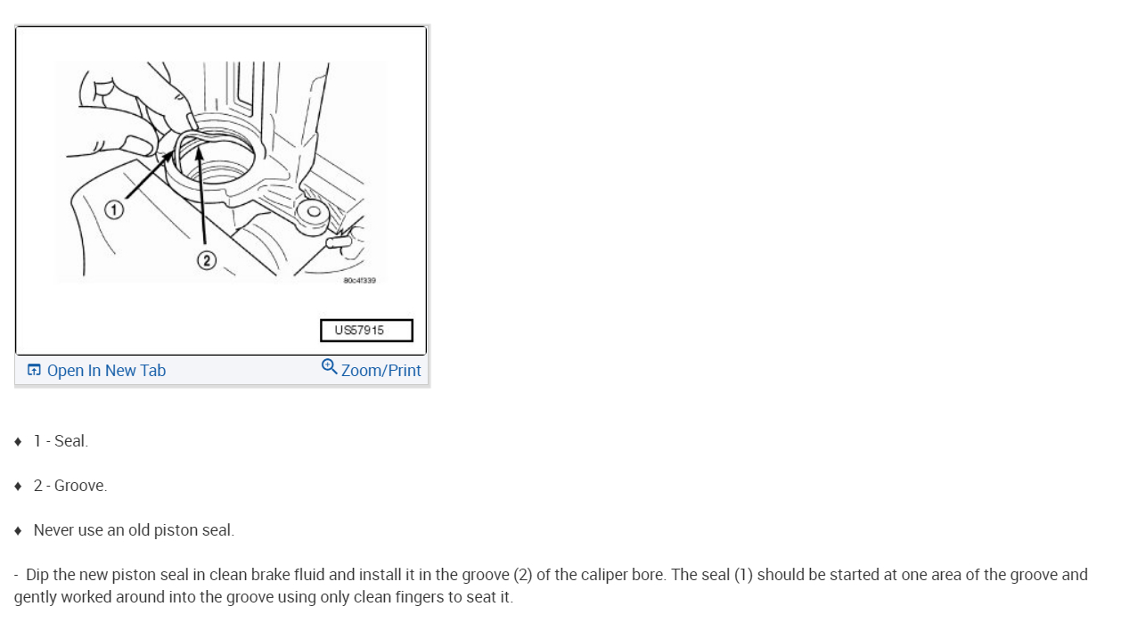

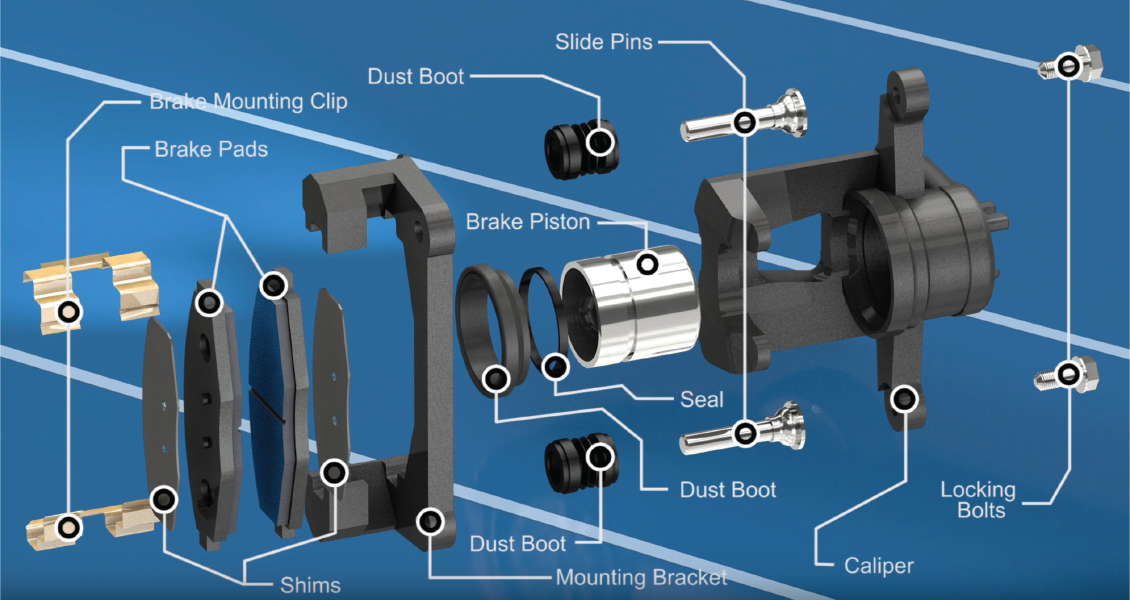

It looks like you have the wrong caliper rebuild kit, here is the correct part number and instructions for how to rebuild the caliper in the diagrams below.
Right Caliper 7B0615424C $78.00
Left Caliper 7B0615423C $73.00
Check out the diagrams (below). Let us know what happens and please upload pictures or videos of the problem. They only show the front brake caliper rebuild but it should be very similar to the rears.

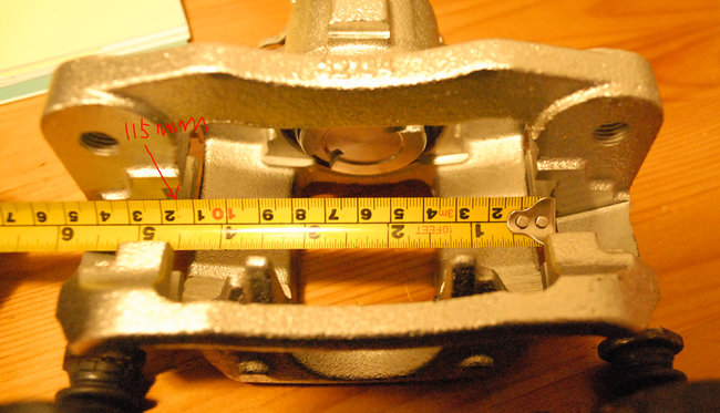

The new calipers deliver fast. but the problem comes fast too

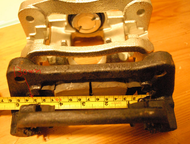

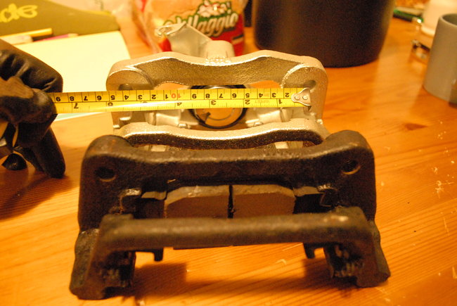

I found the new one can install in the same place, because the distance of the caliper adapter mounting bolts is the same at around 140mm.
But the new caliper has a shorter size brake pads room, my previous one is 130mm, the new one is 115mm, it's really crazing I can't find a place to sale the brake pads according to the size, I searched the VW deal site but found nothing.
Guess the new caliper dealer said this one does not match the heavy-duty caliper, my one is possible this type.
My choice:
1) Find the correct brake pads to match the 115mm new caliper room.
2) Return the new caliper, continue to look for a duct boot, if you really can't find one, use some rubber to cover it better it in bare.
Thank you, Ken, for giving me the model's name: Right Caliper 7B0615424C $78.00.
but I can't find the size or same number with my old one. only from the sale's web site picture, I can't confirm this.
Could you tell me the correct pads is what model? or any wisdom idea? :)
Thank you!

  • 55,433 POSTS
Sure,
Caliper - 7B0615424C $78.00 Left
Caliper - 7B0615423C $ 73.00 Right
Rear Pads - 7B0698451B $49.00
Jul 29, 2022 at 6:42 AM

I have bought 8 wrong caliper rebuild kits, finally, I find this parts: 68144207AA
https://www.bitautomobile.com/chrysler-brake-caliper-68144207aa-product/
This caliper's piston diameter is 45mm, this caliper match my van
I try find the 68144207AA caliper's rebuild kit
this one maybe is correct:
https://www.zeckhausen.com/catalog/product_info.php?cPath=13_3576_1316_5686_5688&products_id=25464
it for 45mm piston Caravan 2012, I can't find the VW routan parts(2013 Routan include this parts, maybe some mistake in Volk data), this one should be more close
