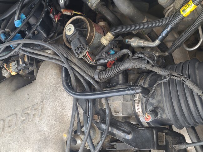

My car has been idling rough and sometimes tough to start. i usually have to give it a little gas. My mechanic was talking too long to get me in so i started by cleaning the IAC sensor and throttle body with carburetor cleaner (it was caked with carbon). that still did not fix my problem but as i was putting the sensor back on i noticed the PCV line was attached snug to the top of the intake but the side that goes into the engine was not attached. i pushed it in but it wouldn't stay. when i took it out the rubber was a bit rough, and some chunks were missing so it wouldn't fit snug. would this cause the rough idle and tough start?

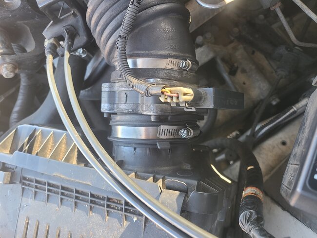

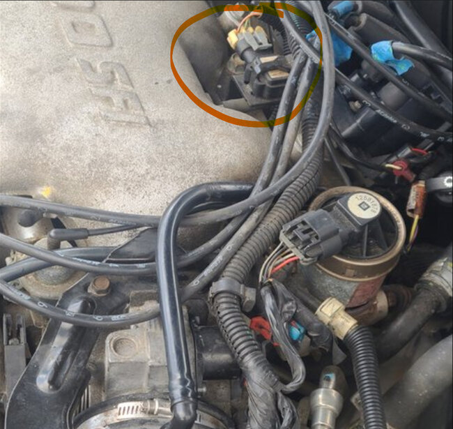

Circled in orange is the MAP sensor, make sure that it is sealed into the Intake manifold very well. The wiring diagrams show a Mass air flow sensor also, do you have a sensor on the air intake boot near the air filter housing?

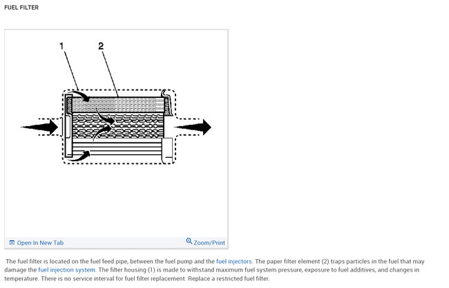

It would be a good idea to replace the fuel filter now also, they are pretty easy on these vehicles, it will be somewhere about halfway from the engine to the gas tank and usually on the frame rail under the vehicle in line with the fuel line feeding the engine. It will help with your starting issues. And save the fuel pump from premature failure.

i will check if i have a sensor on the air intake. i did clean the IAC sensor very well.

i believe this is the sensor you're asking about?

Yes, that is the mass air flow sensor, and they usually have an Intake air temperature sensor built in. They do eventually get dirty and will under report the air flow and can cause the engine computer to not add enough fuel to the mixture. Leaning the mixture out even more.

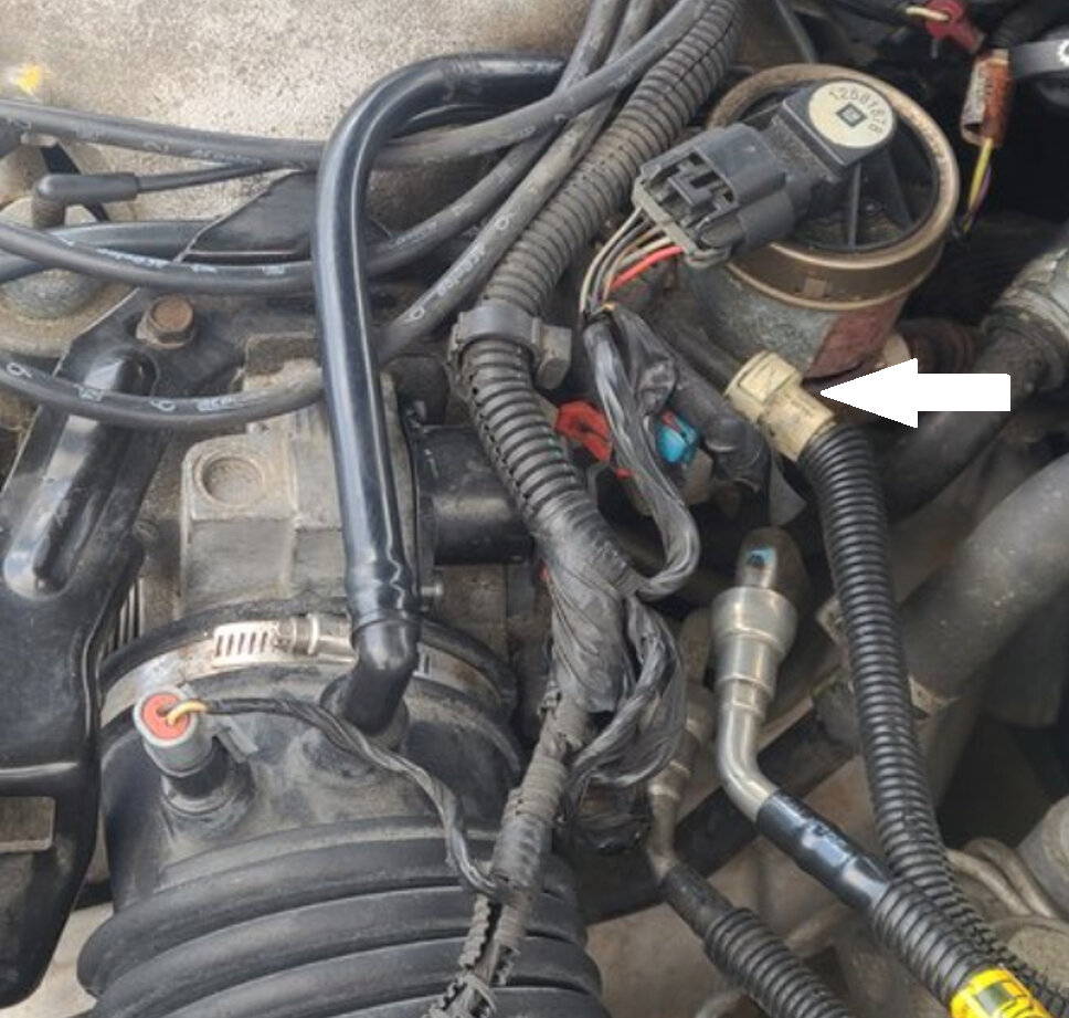

I put an arrow going to the Purge Valve, you can check it for any liquid fuel in it or the line coming to it. The purge valve is only to pull fuel vapors from the gas tank so they can be burned in the engine, Sometimes the Charcoal canister fails and gets filled with liquid gas instead of just vapors and they end up in the that vapor line. But the rest of the system will need to be looked at to determine the rich running condition. The cylinder misfire code will clear up after these issues are taken care of, it will save you in the long run.
You're going to have to get the low temperature issue looked at, most likely you need a new thermostat. Here are some guides below to give you an idea of how these components work:
