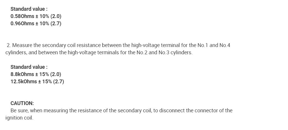

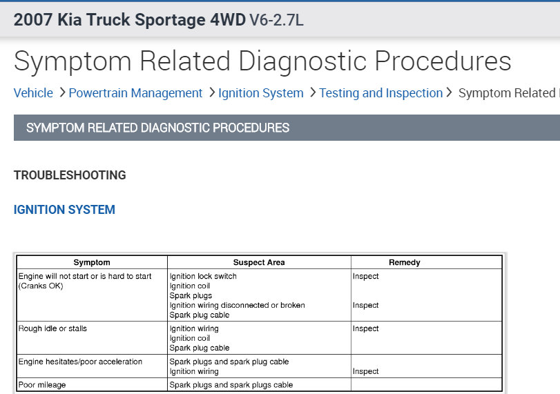

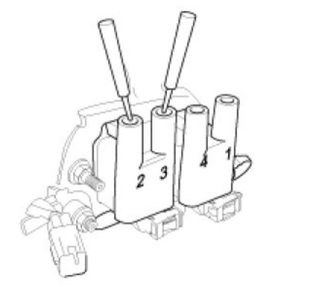

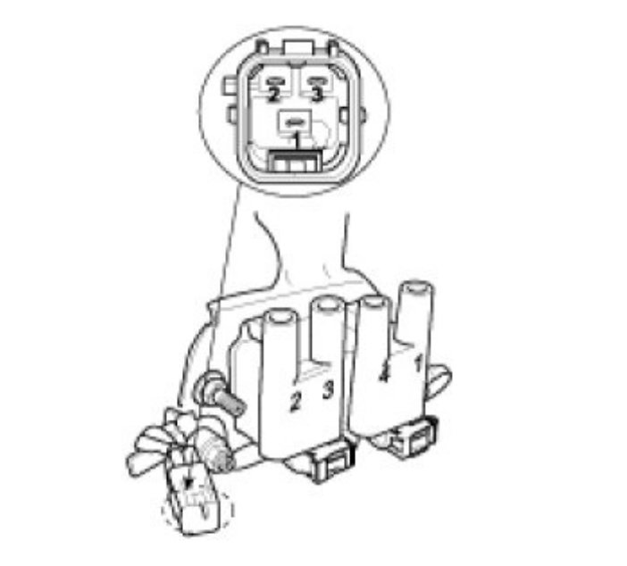

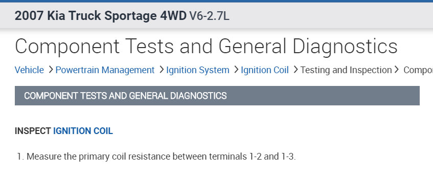

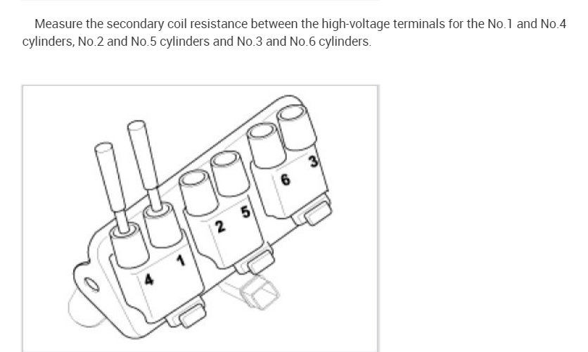

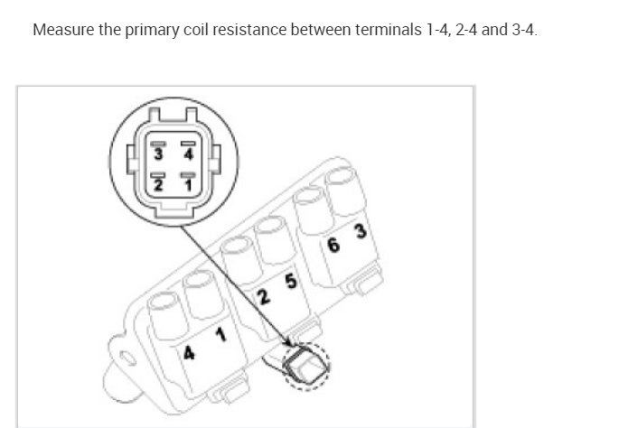

I'm getting spark to the back cylinders none to the front.
Oct 10, 2019 at 5:52 PM
SCGRANTURISMO
  • 4,897 POSTS
This sounds like you could have a problem with your vehicle's ignition coil. In the diagrams down below I have included a troubleshooting list and instructions on how to test your vehicle's ignition coil. You will need to use a Digital Multi-meter [DMM] to do the testing, so I have included a link below for you if you are unfamiliar with how to use one.
Please go through these guides and report back with what you find out.
Thanks,
Alex
