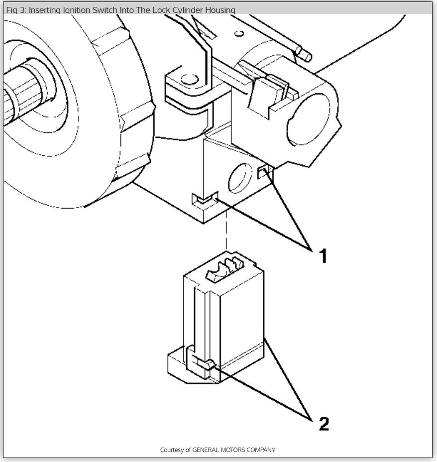

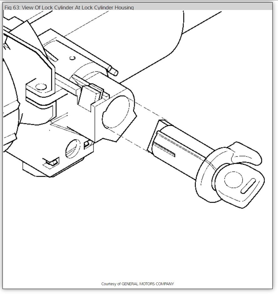

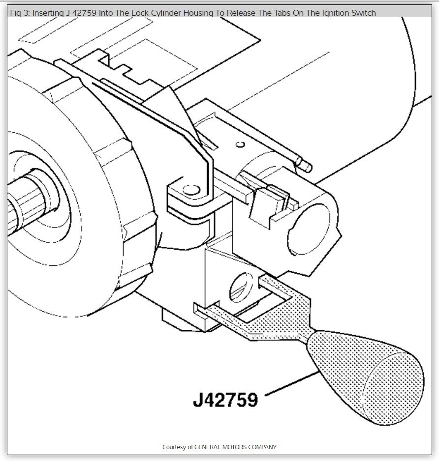

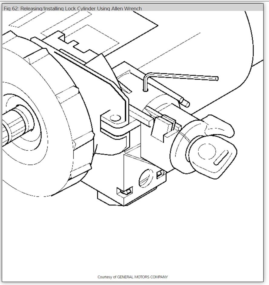

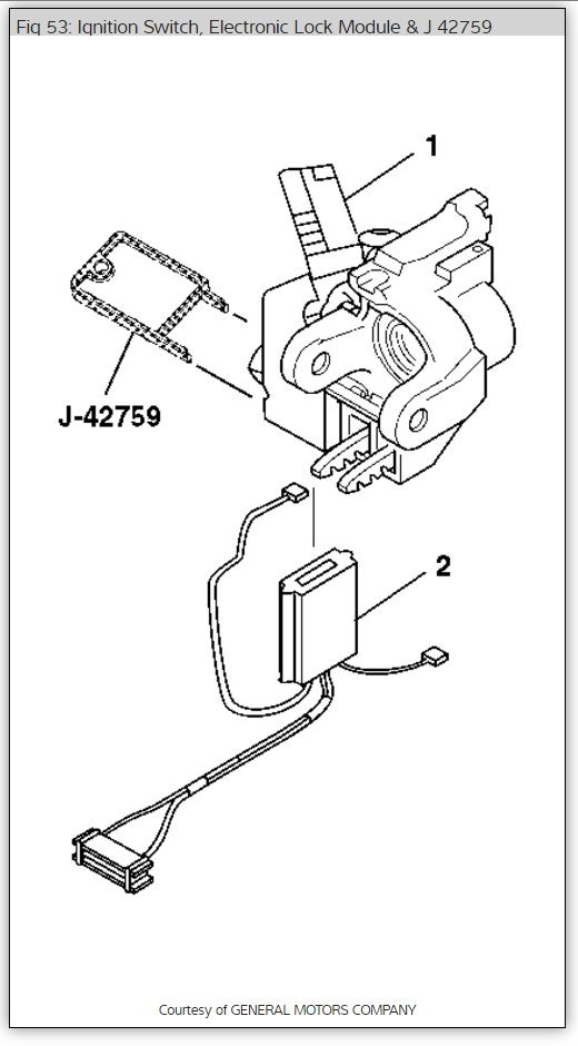

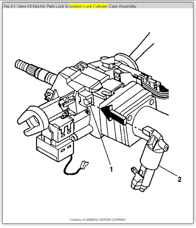

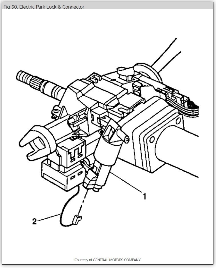

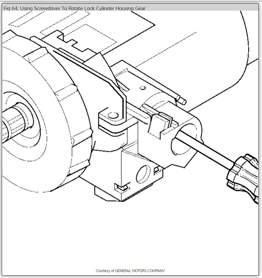

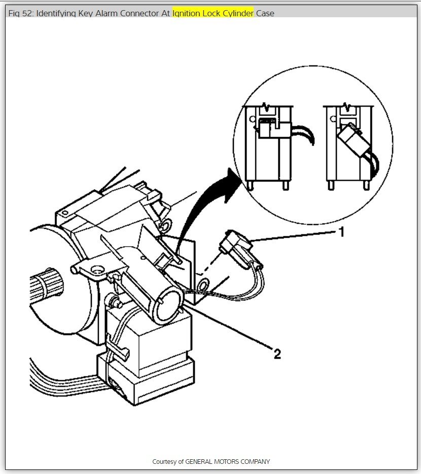

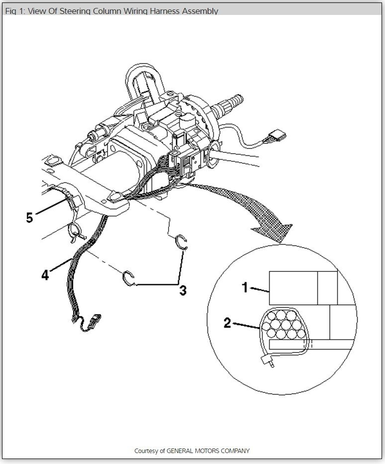

Yep, you need a new ignition tumble and key which I would get from the dealer, please bring your VIN and proof of ownership and they will code the key for you. here are the instruction and diagrams to help you with the repair. Check out the diagrams (below). Please let us know what happens.
