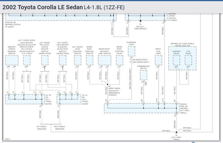

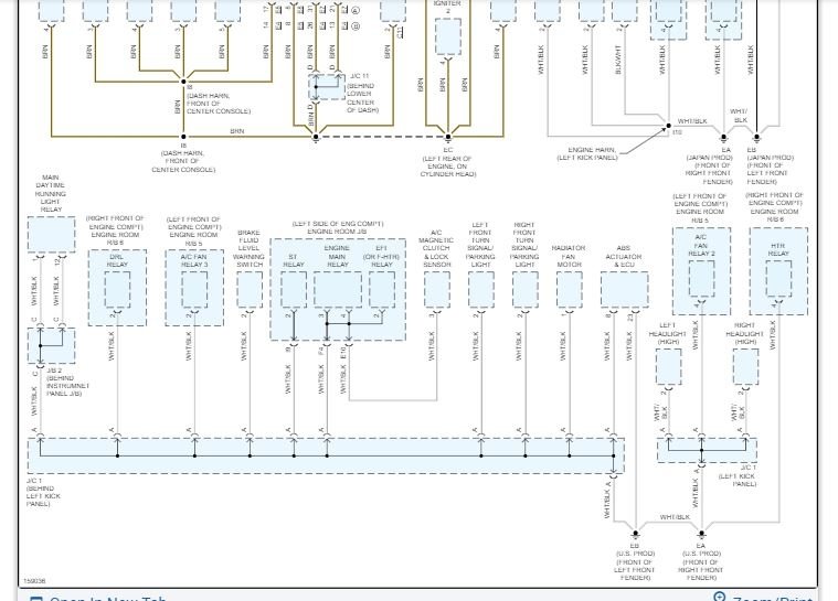

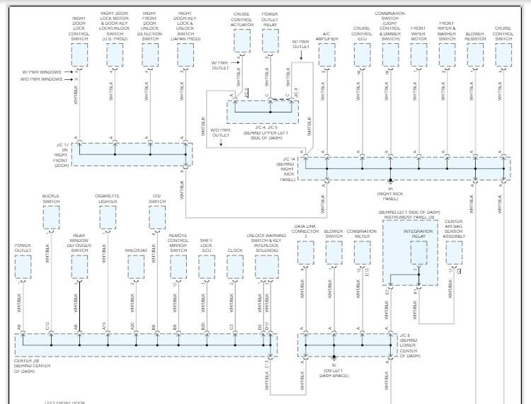

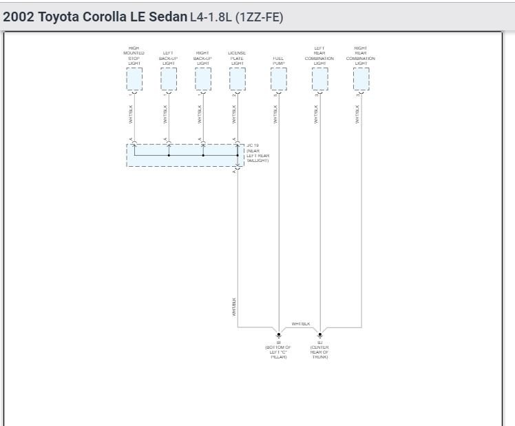

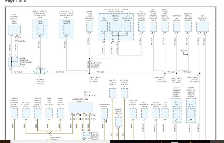

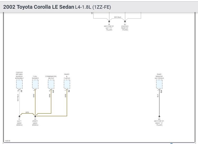

Hello my name is Dave.
It's been my experience that a high percentage of electrical problems turn out to be an issue with a ground. Especially when the problem isn't consistent. I have attached diagrams of the ground points for your car. I have also included a link to our tutorial on using a voltmeter to assist you, it will be the ohm testing you'll need. Using the guide you'll want to test resistance between the battery ground and the ground points in the diagrams I have attached. I hope this helps you track down your issue and thank you for using 2CarPros. https://www.2carpros.com/articles/how-to-use-a-voltmeter
