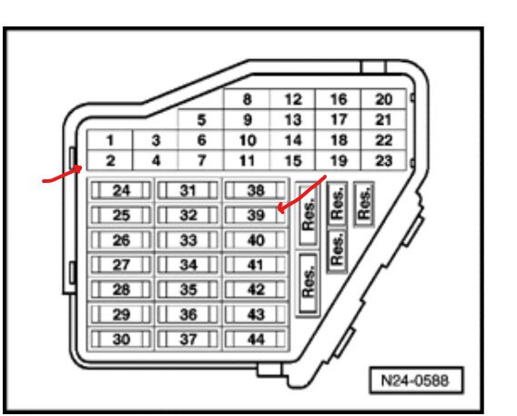

The turn signal indicator are not working?
Nov 7, 2024 at 5:20 AM
  • 55,267 POSTS

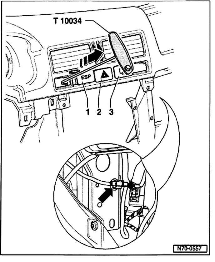

It sounds like a fuse or the turn signal flasher needs to be replaced, here is a guide to help you test the fuse and the fuse location in the images below. If the fuse is okay here is the location of the flasher so you can swap it out which should fix the problem.
Fuse #2 and fuse # 39 in the fuse panel on the left side of the dash. The Emergency Flasher Switch is Integrated with the Flasher Relay. Check out the images (below). Please let us know what happens.
