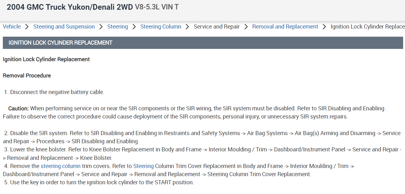

The ignition tumbler/ assembly is stuck?
2004 GMC YUKON
JTIRWIN7

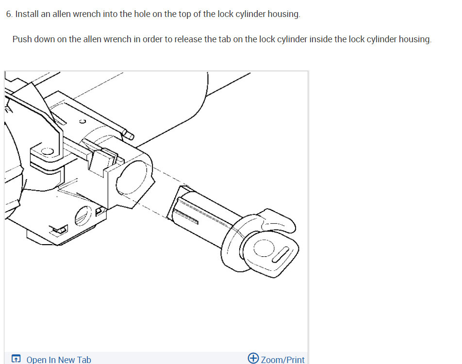

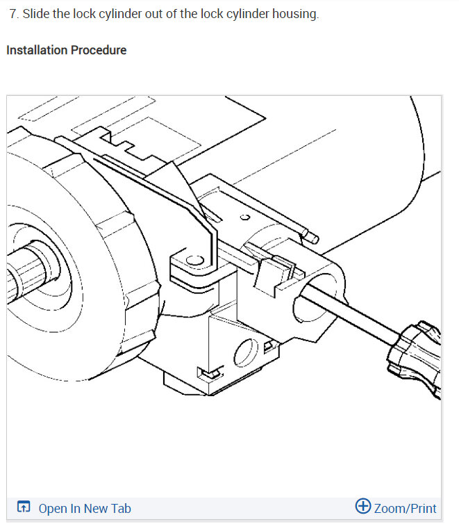

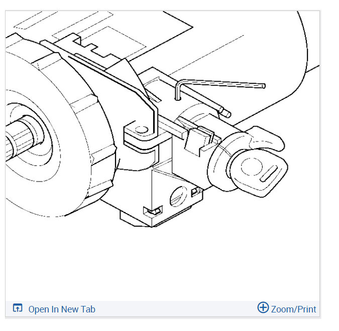

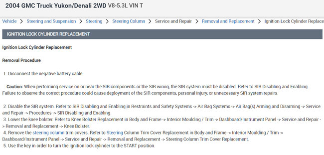

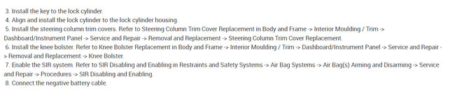

When I try to turn the truck off the key will not move, feels like it’s jammed, I had to pull the battery and fuel relay to turn it off. please send responses to this, I need a vehicle.
Oct 3, 2024 at 10:29 AM
  • 55,433 POSTS

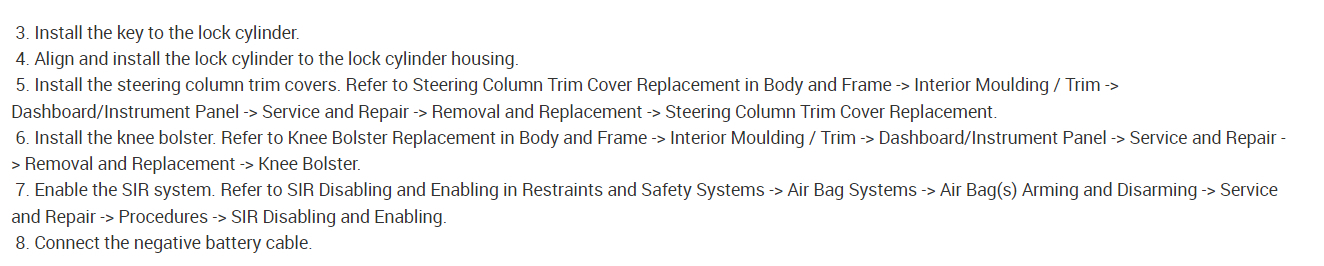

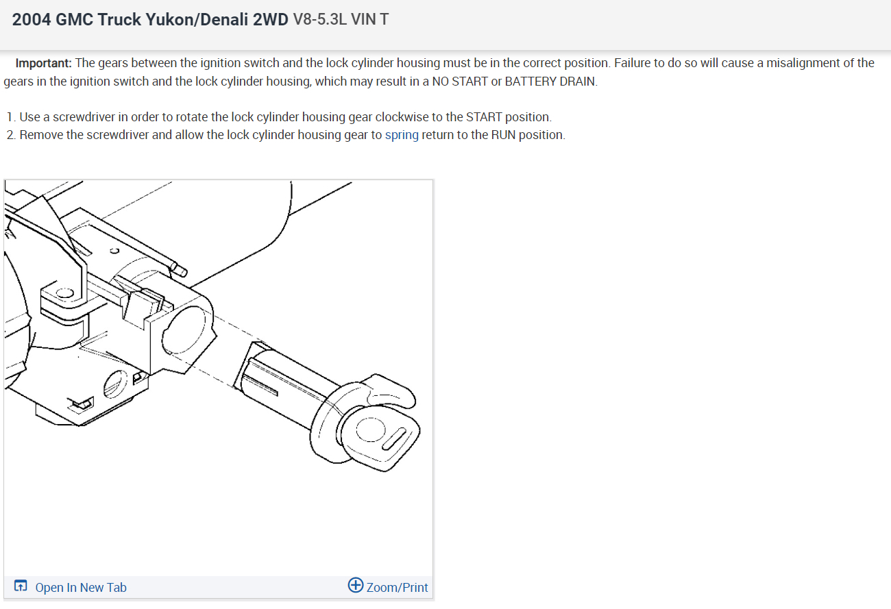

Yep, the ignition lock tumbler has fallen apart internally, you will need to replace the part to fix it, here is a guide that might help as well. If you get the part from the dealer they can code it for you before installation. Check out the images (below). Please upload pictures or videos in your response of any problems so we can see what to help you with.
Oct 4, 2024 at 4:44 AM
