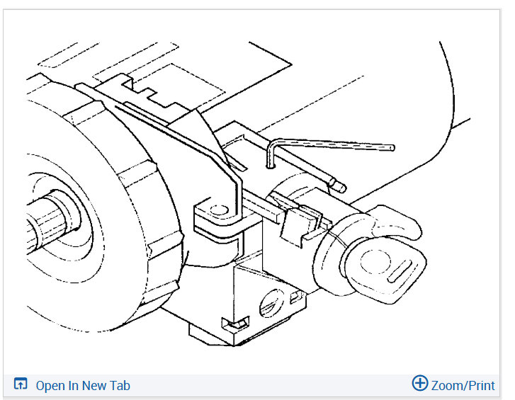

The ignition is stuck in the on position?
1991 GMC JIMMY
269,347 MILES • 4.3L • V6 • 4WD • AUTOMATIC
ALTWIZTD1
Ignition won't turn off it will start but no off.
Apr 25, 2025 at 6:11 AM
  • 55,443 POSTS

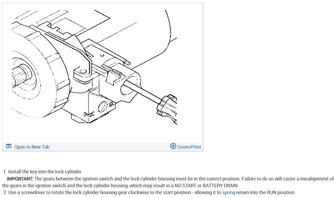

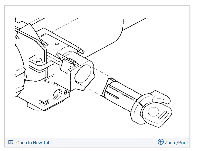

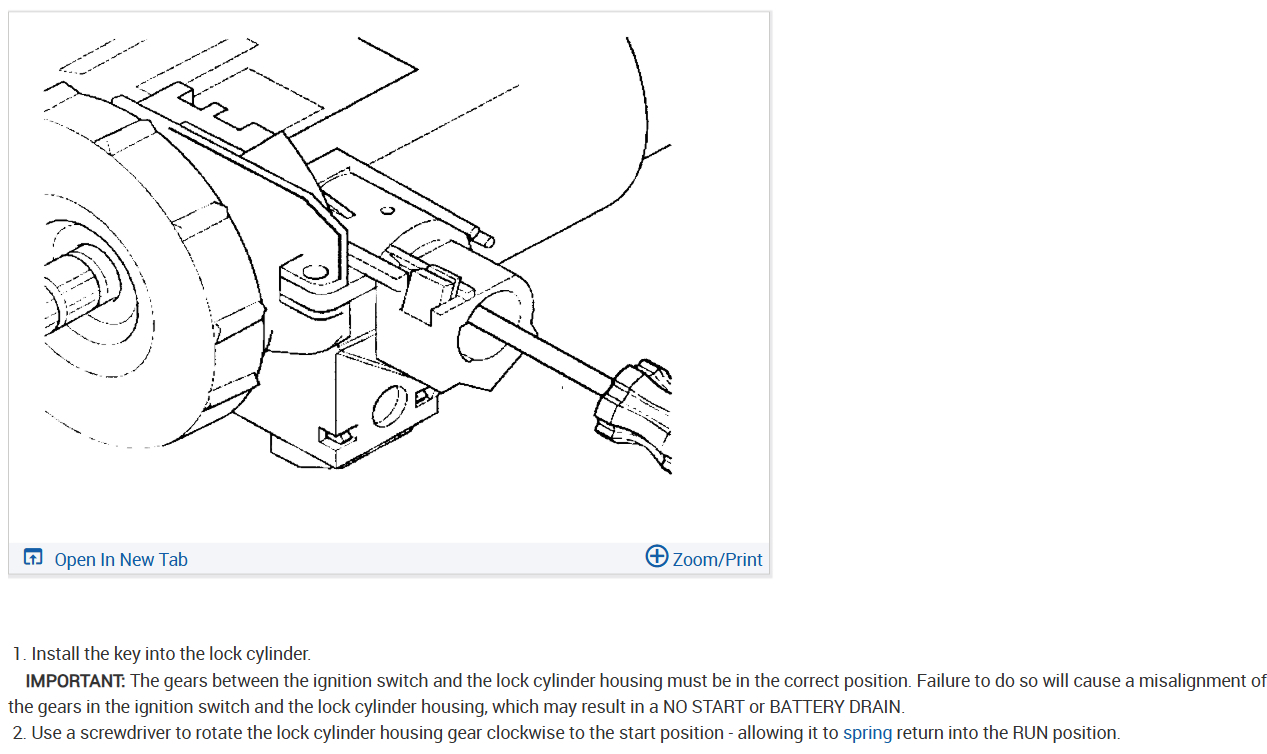

Yep this is common when the ignition switch key tumbler falls apart internally. You will need to remove the lock tumbler and replace it with a new one. Here is a guide that may help with instructions below you show you how to do the repair.
https://www.2carpros.com/articles/ignition-switch-wont-turn-stuck
Check out the images (below). Please upload pictures or videos in your response of any problems so we can see what to help you with.
