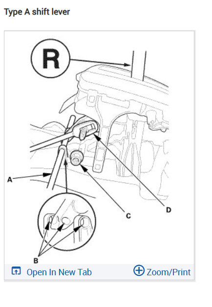

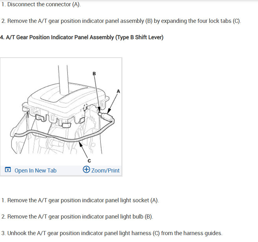

The gear to shift it into drive will not stay, and it is possible to move it back and forth without pressing the button while driving?
2012 HONDA CIVIC
73,000 MILES • 1.8L • 2WD • AUTOMATIC
WILL9091
So when I am driving my automatic transmission car, I no longer have to brake or press the button when shifting my car's gear. If I slightly push it or pull it, it moves back and forth. These two things also popped up on the screen that say, "Check transmission system" and "Check emissions system" at the same time this started happening. I drive the car listed above LX 2 Door. I don't understand the issue, please help.
Oct 30, 2024 at 8:25 AM
  • 55,423 POSTS

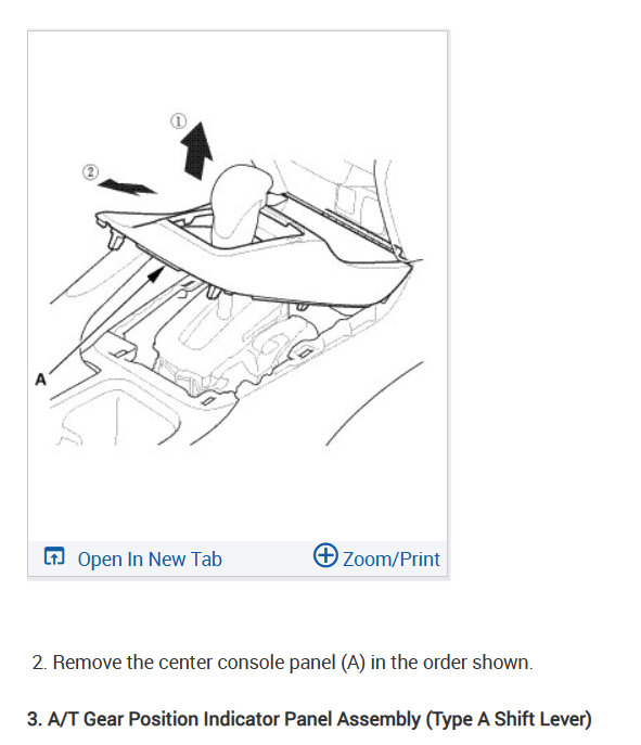

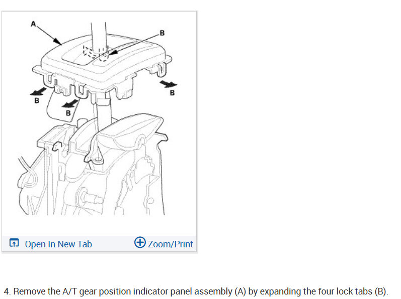

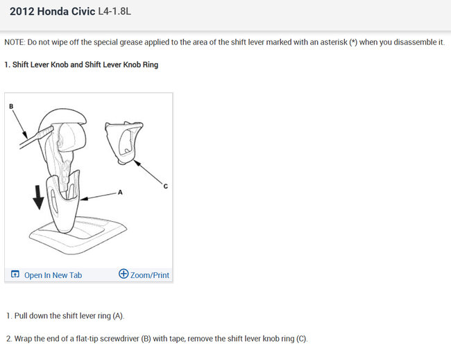

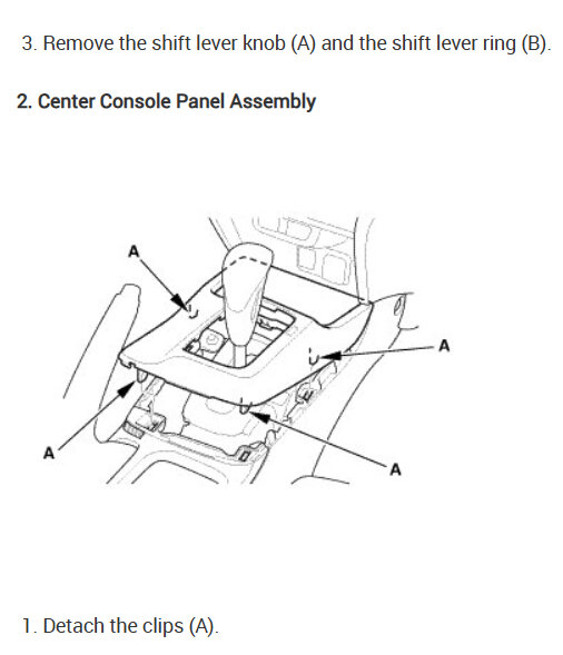

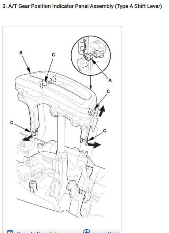

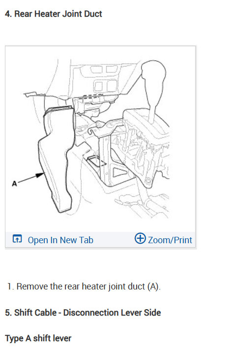

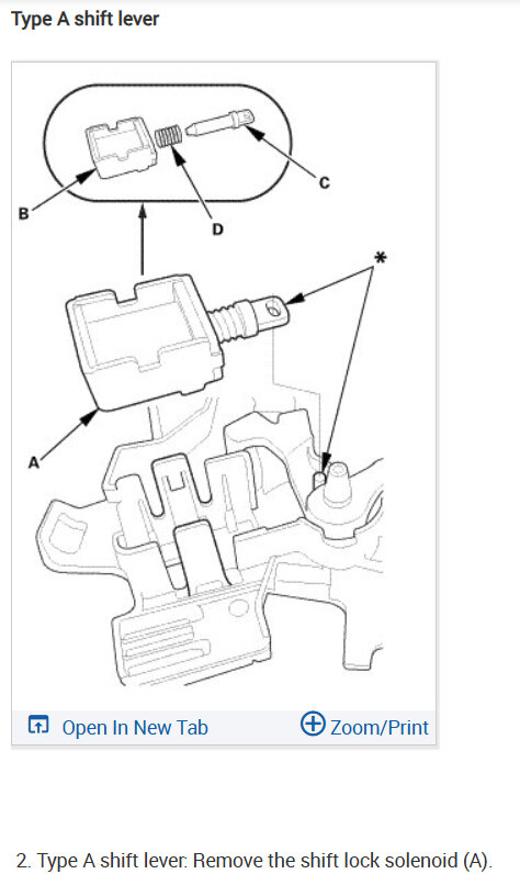

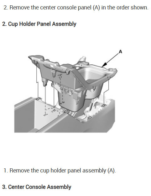

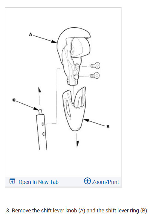

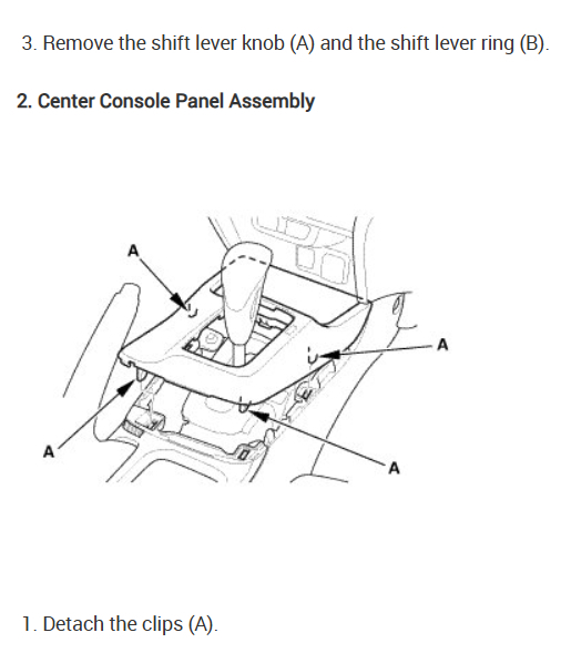

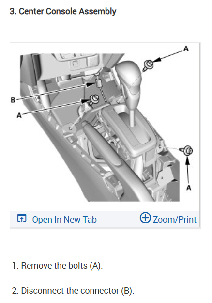

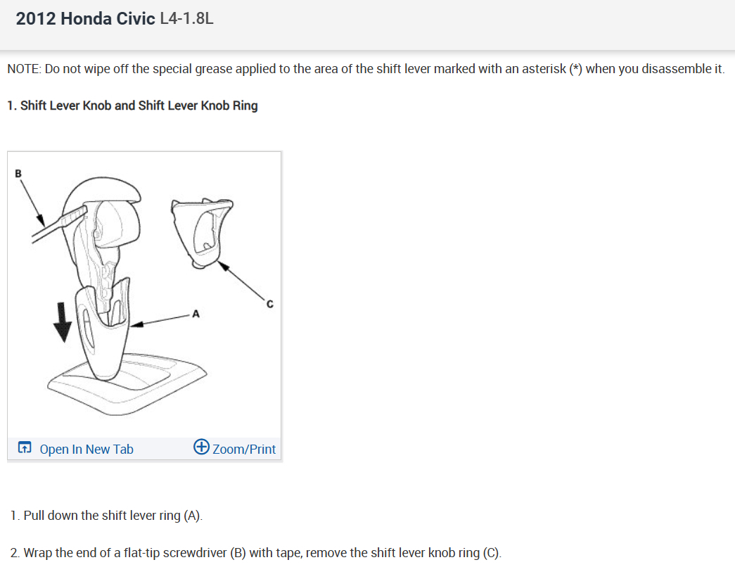

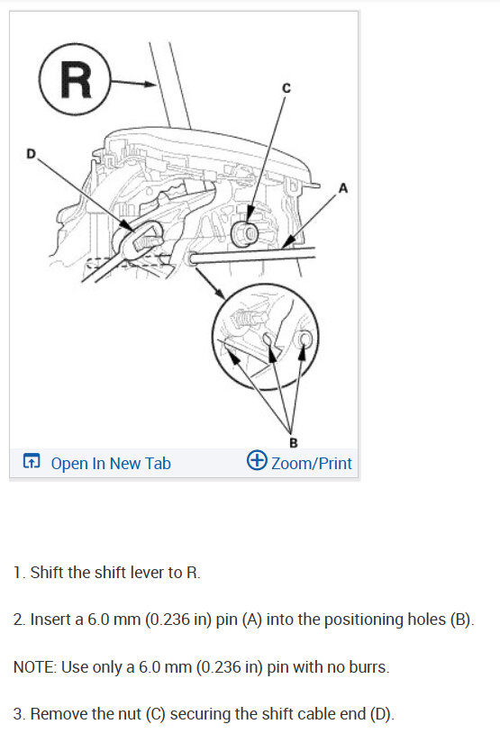

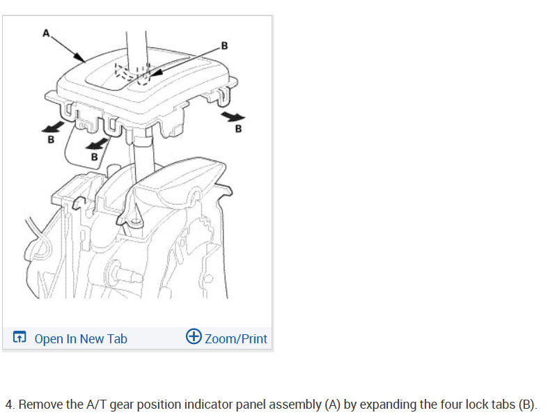

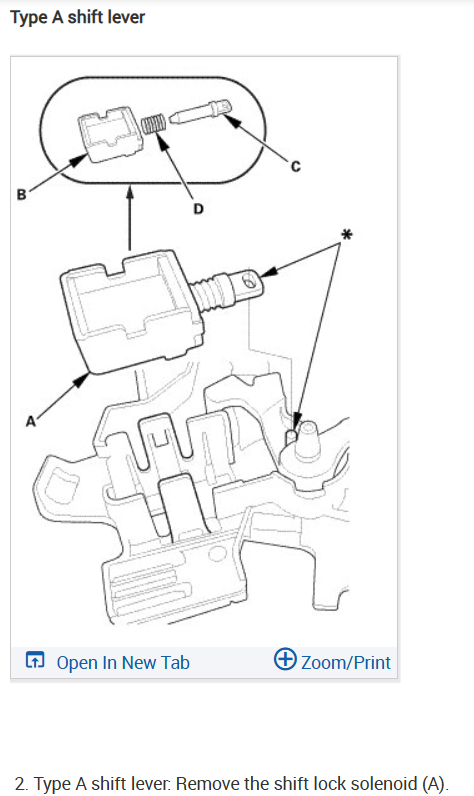

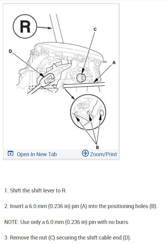

Can you upload short video showing me the problem? It sounds like the shifter or the shift lock mechanism has had a problem. If the shifter is broken I would search ebay for a used one and install it, I have included instructions on how to do so in the images below. Please upload pictures or videos in your response of any problems so we can see what to help you with.
