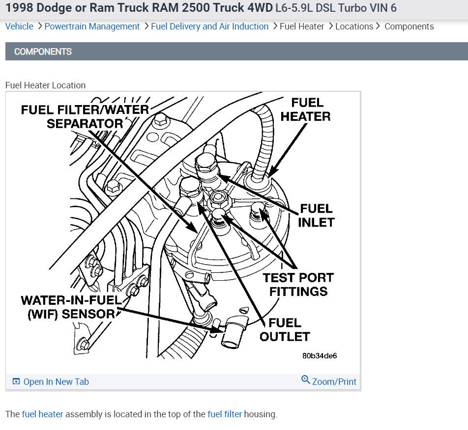

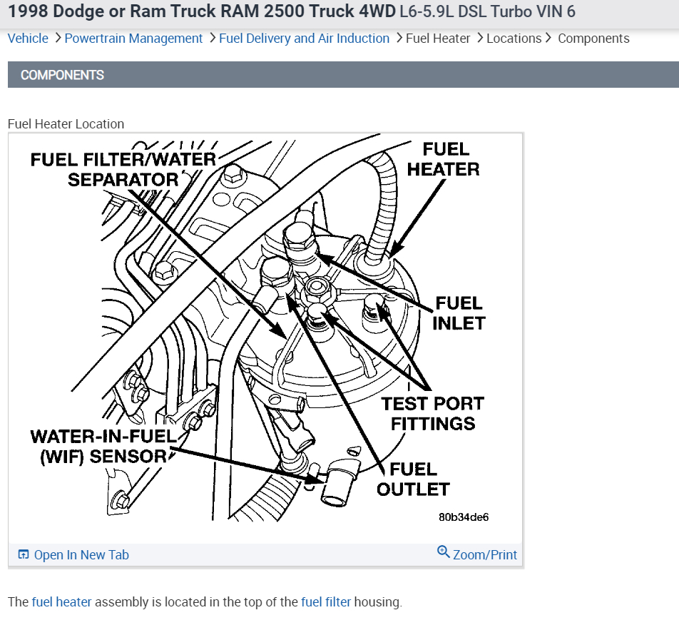

The fuses under my hood keep blowing to the fuel diesel heater?
1998 DODGE RAM
30,000 MILES
KELLI NEAL
The fuses under my hood keep blowing to the fuel diesel heater by the motor where the won't start will turn over?
Aug 6, 2023 at 9:56 AM
  • 55,456 POSTS
Yep, this happens when the fuel heater shorts out and needs to be replaced. Check out the images (below). Please let us know if you need anything else to get the problem fixed.
