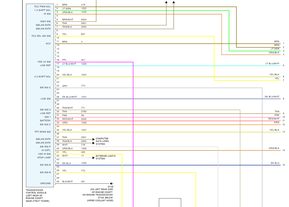

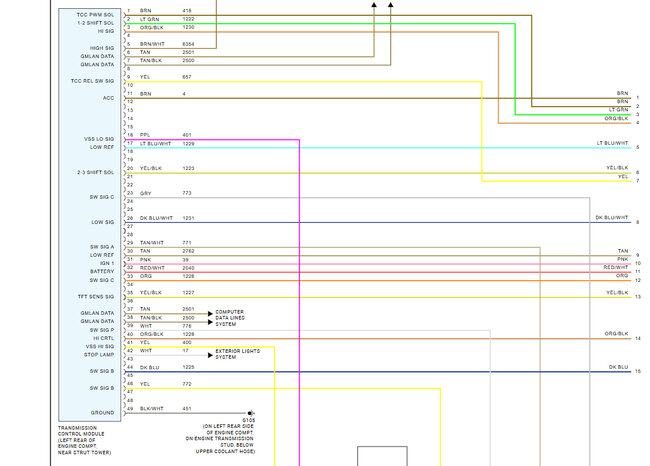

I need the right an a right colored diagram for the wiring of a TCM wiring harness of the correct spits a colors of where the right colored pin out wires go through out to? Please!

Sure, here you go, these are the wiring diagrams for the TCM connector and the wire locations inside the connector. Check out the images (below). Let us know if you need anything else.
