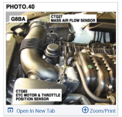

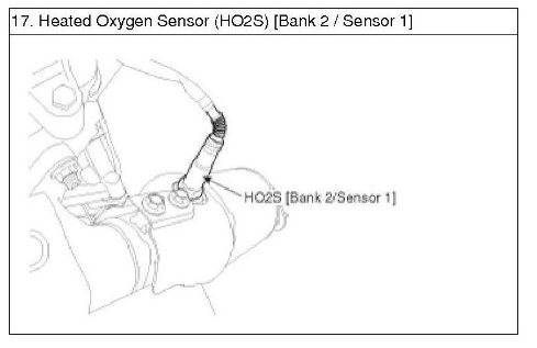

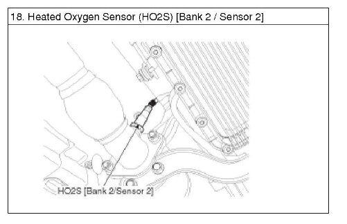

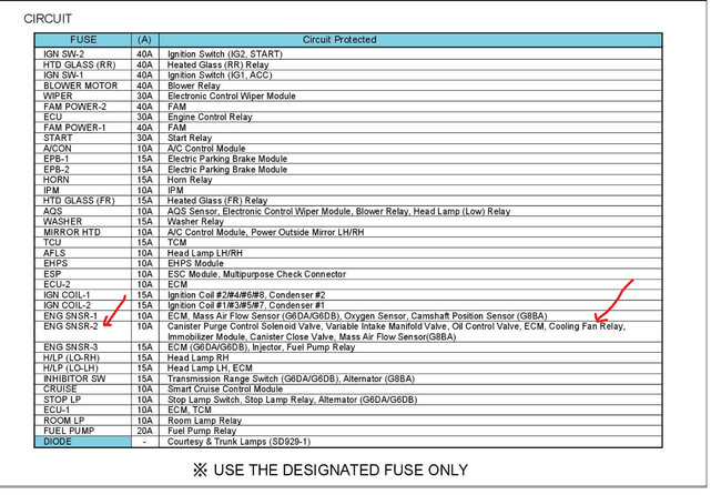

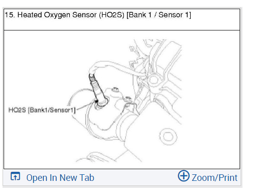

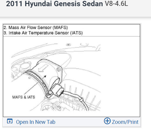

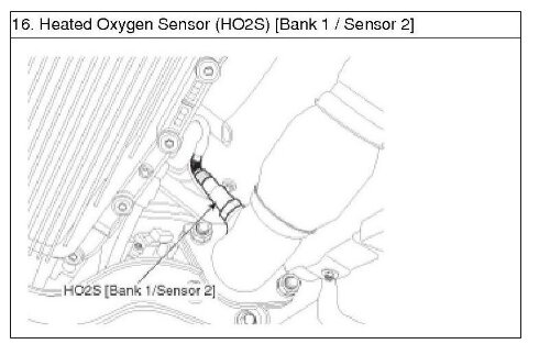

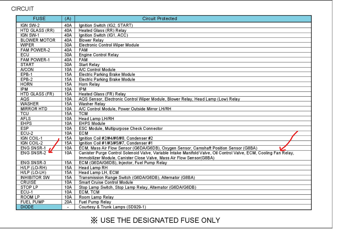

I found Engine sensor-2 fuse blown. I replaced it and it blew again. Fuse is a 10a.
Aug 28, 2024 at 4:27 AM
  • 55,399 POSTS
All right! This will be fun :) so there are 8 main circuits with many sub circuits especially for the ECM. I can tell you I have seen oxygen sensor heaters short out, (any of the four) and the MAF sensor have problems, let's start by unplugging them all and see if the fuse still blows (you might need a small box of fuses). Here are the locations of the sensor and a complete list of what is on that fuse. Check out the images (below). Please upload pictures or videos in your response of any problems so we can see what to help you with.
